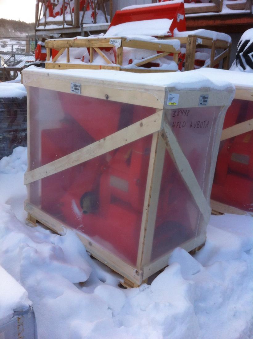

I did get to see the wood chipper/shredder i ordered at the dealer this week so I'm happy :D
