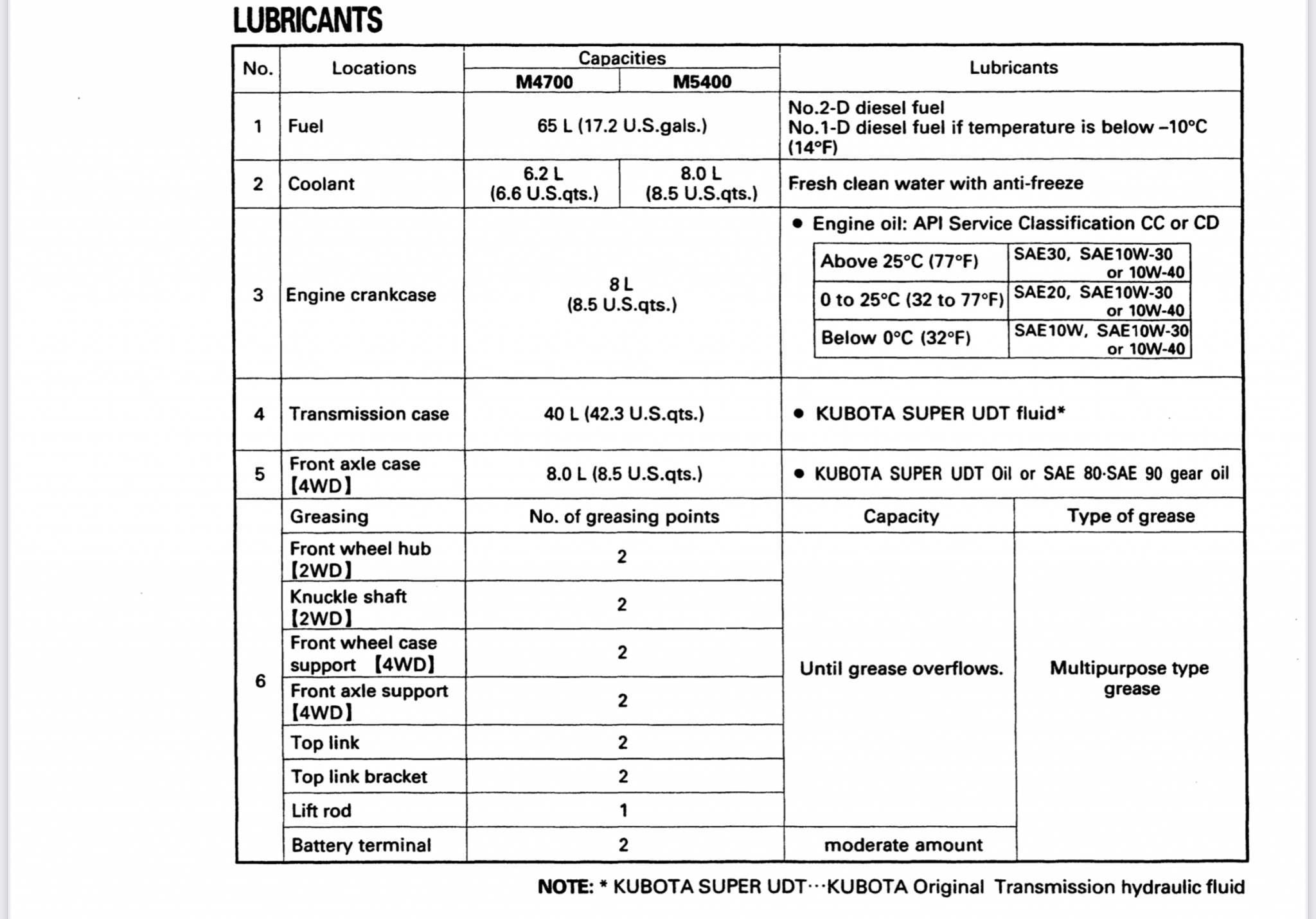

My Kubota Owners Manual Specifies on Pg 44 “Transmission Lubricants- Kubota Super UDT”. No substitute or other specification is mentioned.

I have a lot of respect for you Fordtech because I’ve seen/read so many of your posts which are clearly well-thought-out by an experienced mechanic/technician that you clearly are... also that your posts are respectful and considerate. So I am not trying to generate any “argument” with you....
..But how can any other interpretation be made if Kubota is so-specific as to what is to be used and NO other fluid or Mil-spec, or even any other commercial specification is identified by them?
In my area of maintenance if there’s no specification to which another maker can meet or duplicate then a “basis of approval” must be met. In this case, Kubota does not offer any basis of approval for any other fluid.
As an example, for motor oil, they offer a basis in specifying “CC or CD” and a particular range of viscosity.... which we can find many brands of fluids which meet that specification. But the restraint Kubota has displayed with regard to transmission fluid seems pretty clear to me that NO other fluid meets Kubotas’ approval. An example of this is WalMart SuperTech which claims to “meet” the Kubota UDT standard. We have to take WalMarts’ word on that ... because Kubota does not list SuperTech as a replacement. Perhaps WalMart is sufficiently believable to substitute SuperTech for UDT.... but WalMart/SuperTech does NOT claim to meet Kubotas “Super UDT” fluid. Nor does Kubota offer any Mil-Spec which can be relied upon as a substitute.
To me...that means only Super UDT is known to meet the requirement...therefore is “required”.

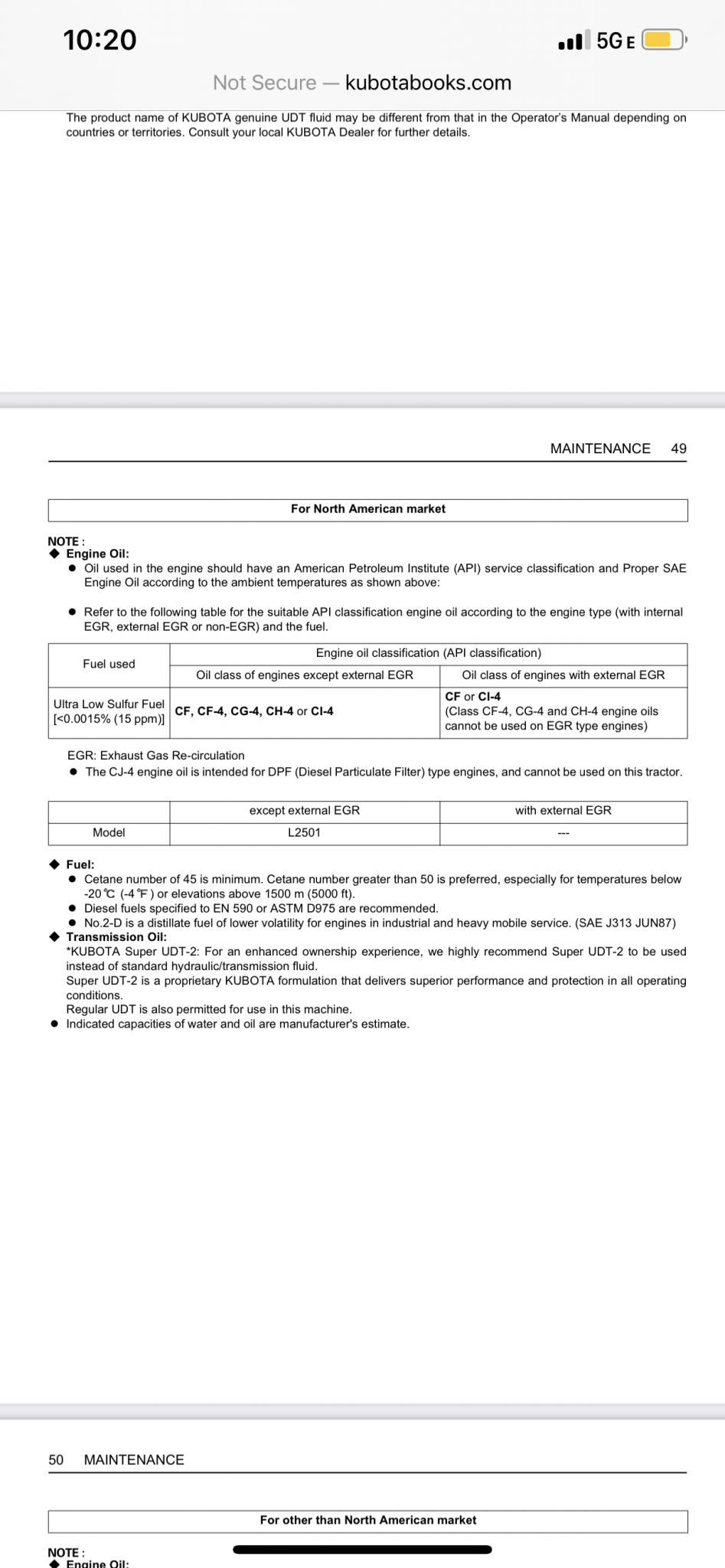

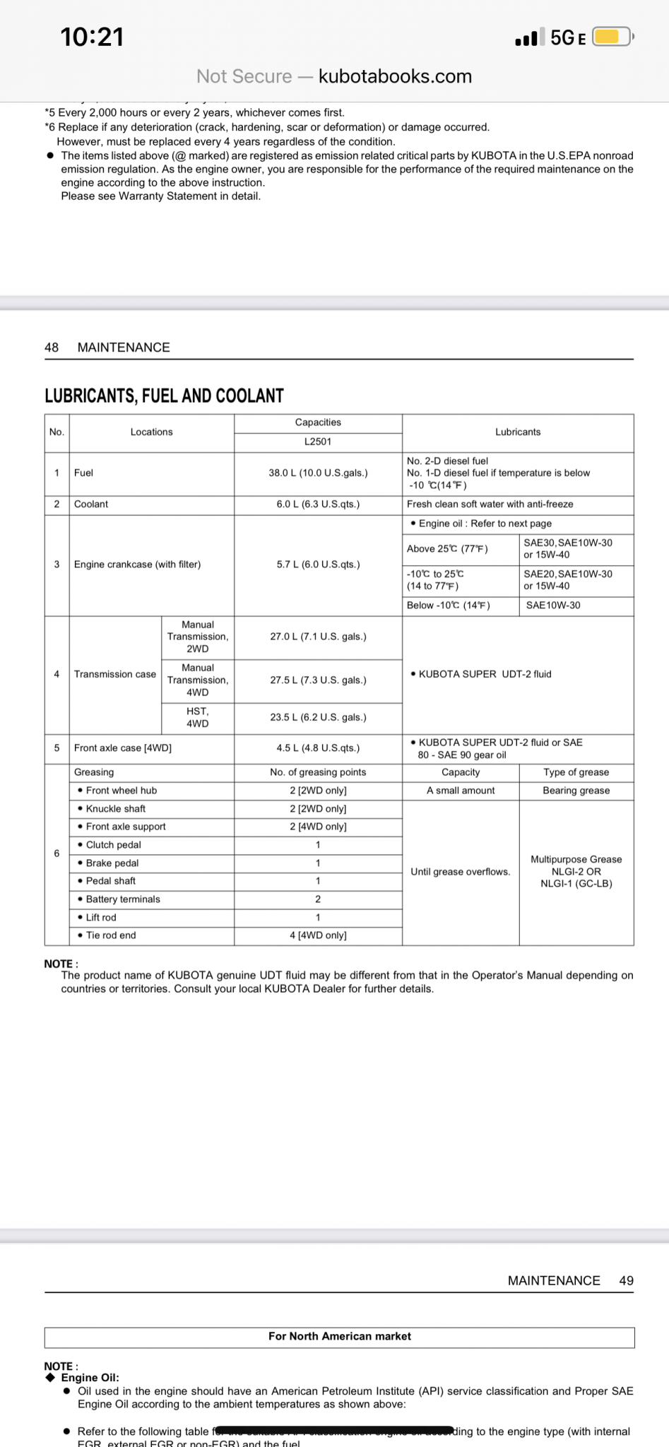

I do not disagree with you at all, and its merely speculation on my part as to why the manual is written as it is. The question was raised as to where is it in writing from Kubota that UDT is “required”.
This is from the L2501 manual for example
Note under the transmission oil, “we highly RECOMMEND sudt 2”, that does not mean we require sudt 2. Owners can choose to use whatever fluid they want and they assume the risks of degraded performance, increased wear, loss of warranty coverage, etc.

Ruger I agree that Kubota cannot ”require” you to use any specific brand of oil. But Kubota does not have to repair any damage some other brand of oil can be shown to cause. If Kubota-branded oil causes a problem then Kubota has to cover that.
Fordtech, ... the L2501 excerpt you posted actually states in a footnote: “Regular UDT is also permitted for use in this machine”.
That pretty-well clarifies that either Super OR regular UDT must be used. ... Don’t you agree?
