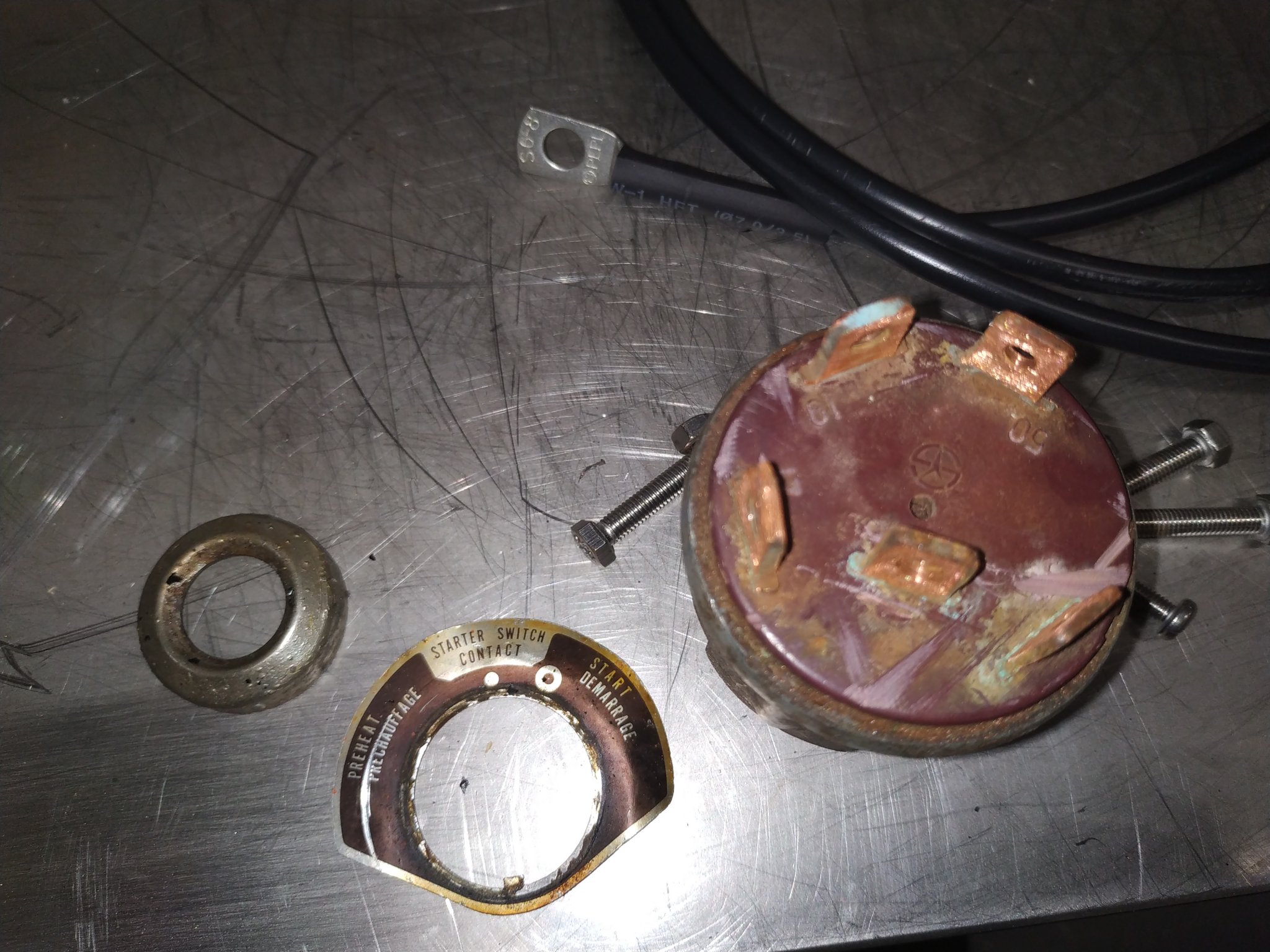

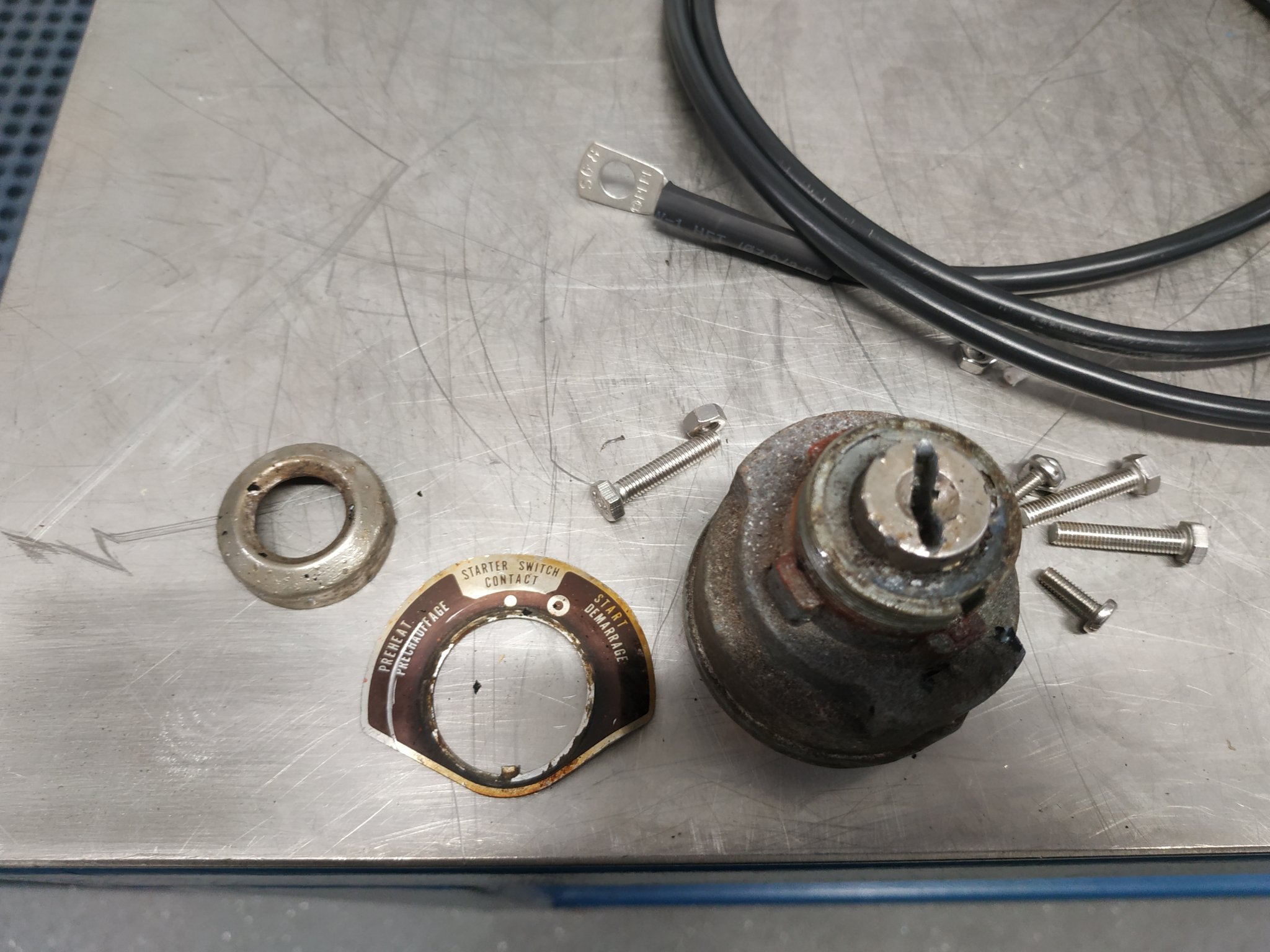

Started the loom replacement job... it's been difficult to get similar colour wires to the old so I mixed and matched.
Don't be afraid to eliminate the electrical plug in connectors. They are part of the harness only to facilitate assembly and future maintenance but if they are in bad shape and might create a poor connection point I would solder the wires together.
Dave
