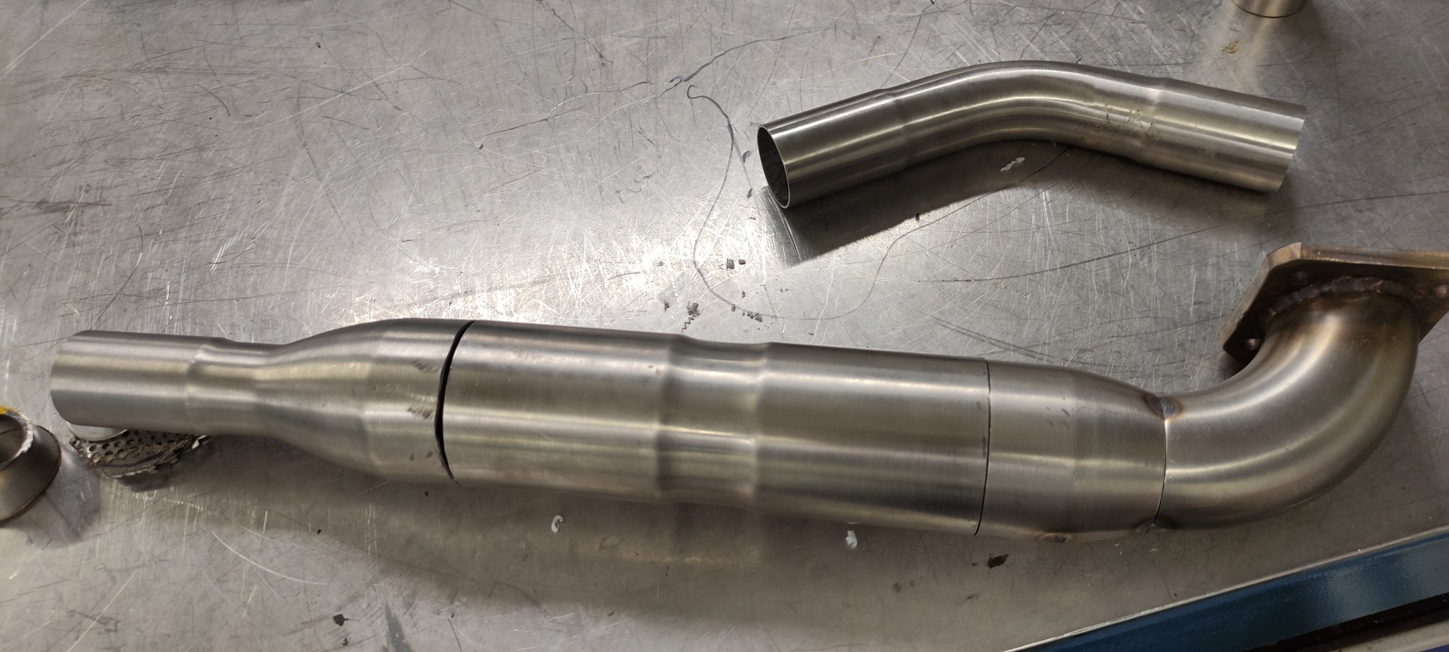

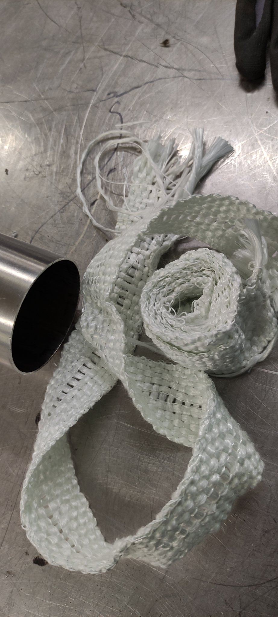

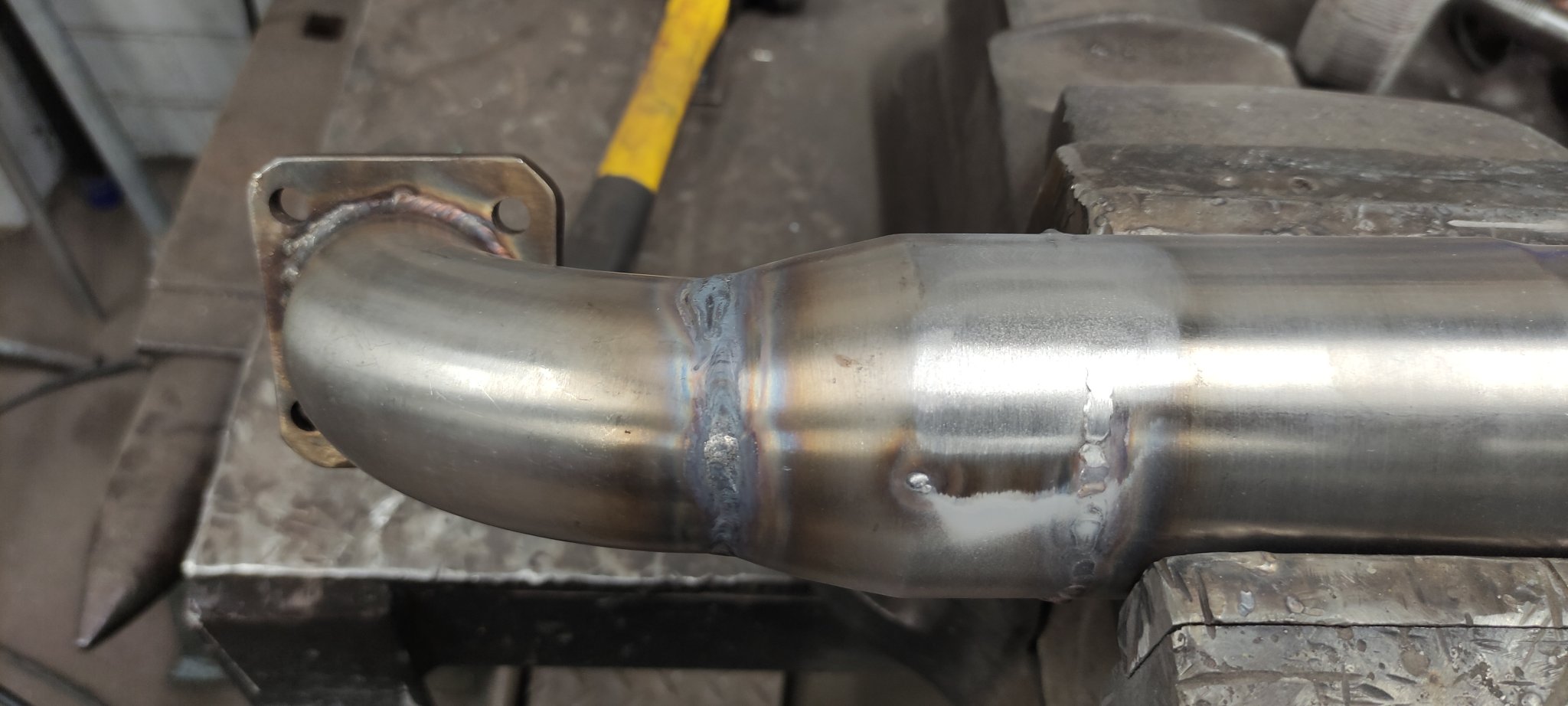

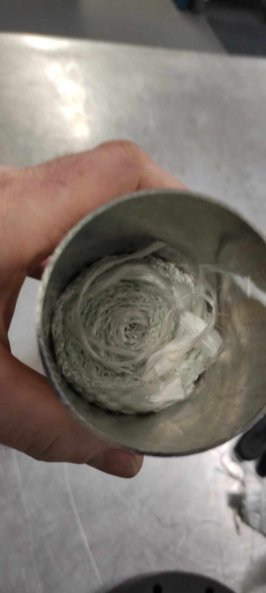

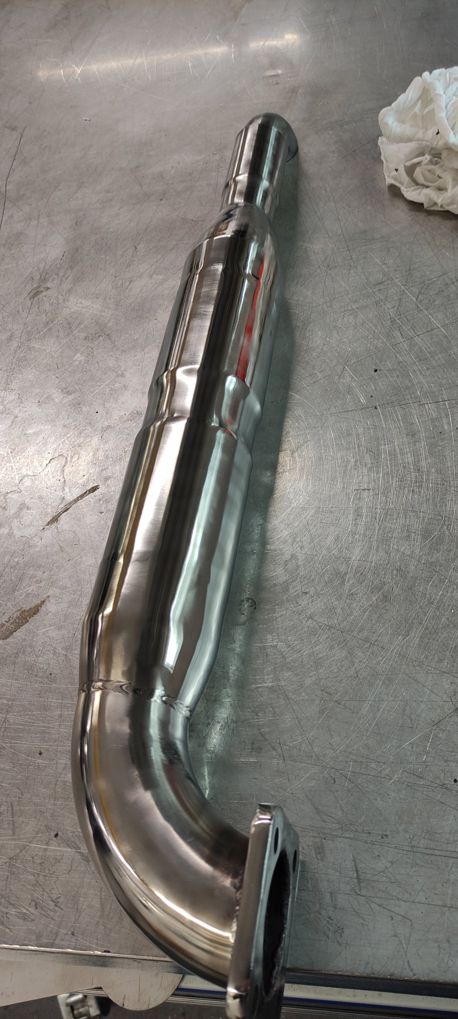

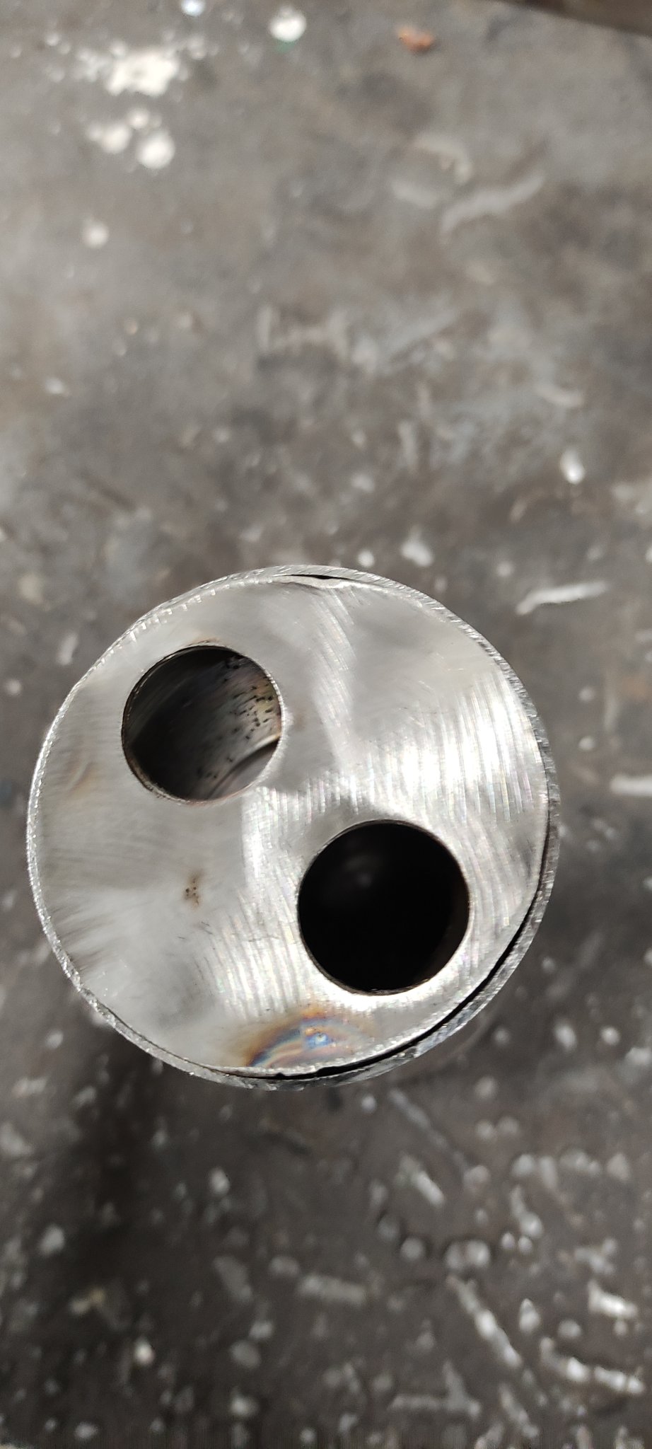

Hi Guys ,I've been away for a long time but I've finally got motivated again to try finish this project. I put together my new exhaust today. I wasn't sure what to do for baffles so I kinda winged it and hoped for the best. I can't wait to hear how it sounds.

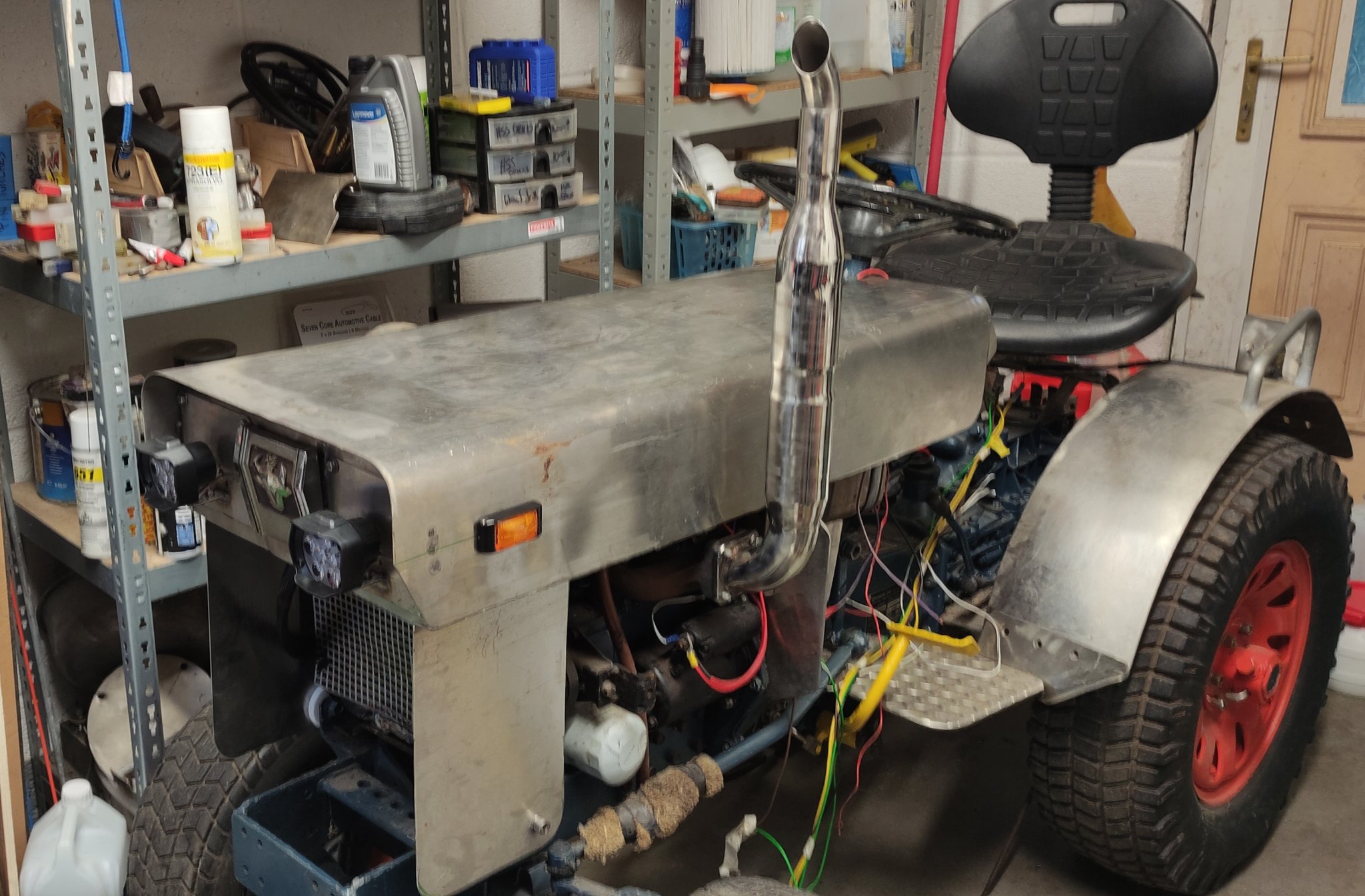

I'm delighted how it looks on the tractor. Must finish my wiring and get her started in the next few days.

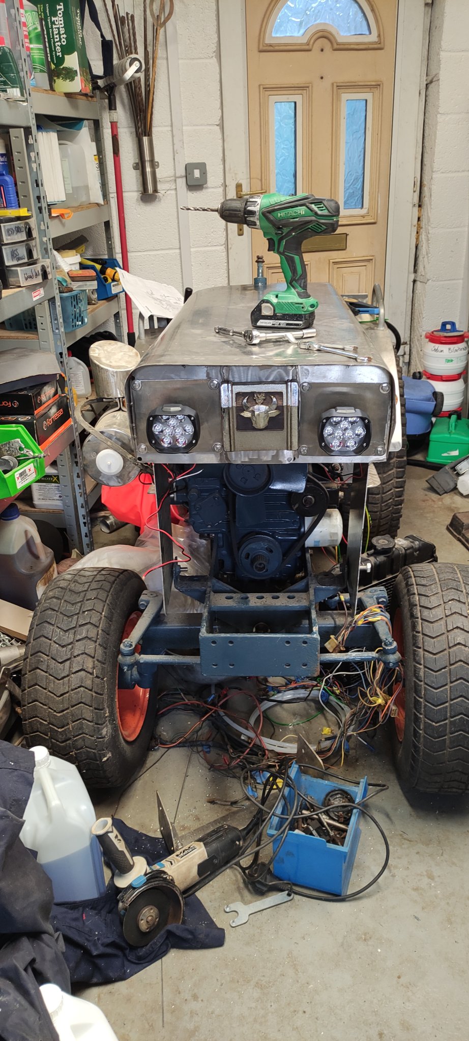

8,001
5,188
I did some more to the bonnet last week. Gave up on sourcing round lights for now and added high power leds instead.
Please....do not forget about us!
WE LOVE watching your project!

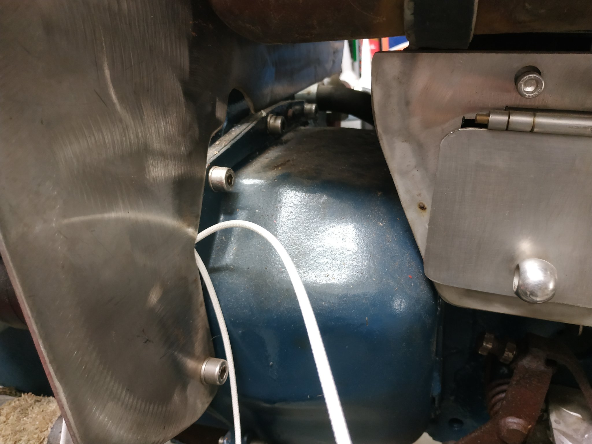

My Kids are at an age they might try take this stainless Frankenstein for a spin so tied in a hidden kill switch under the seat, done in series with the clutch safety switch.
