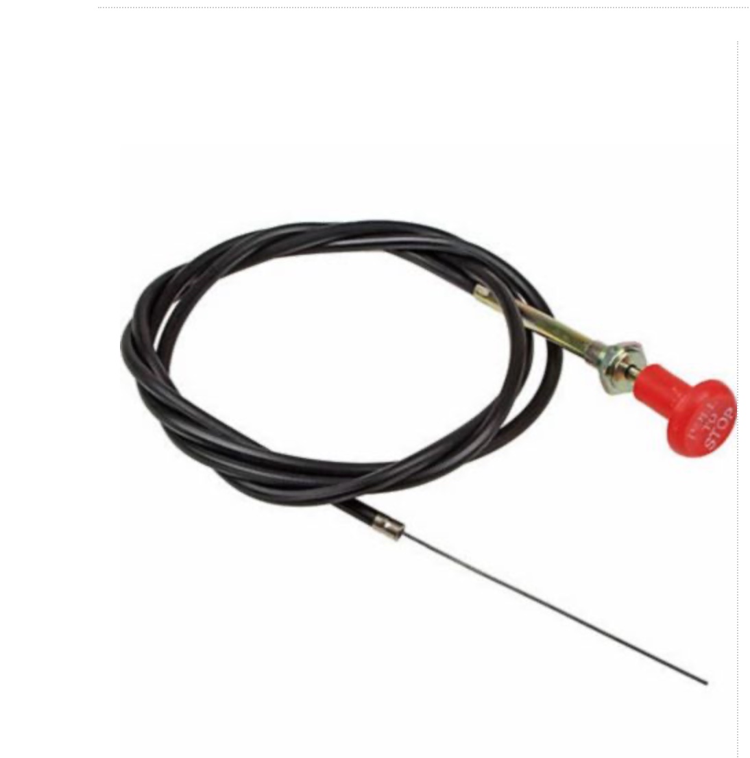

Do you mean the decomp knob?
Mine is a smaller knob (3/4"?) that operates a cable to the decomp mechanism, (think old lawnmower throttle cable) like the one below, except no writing, and black.

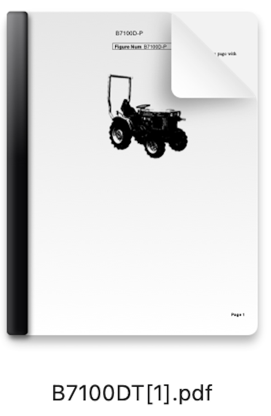

Do you have the parts manual for the whole tractor?
If not, PM me your e-mail & I will try to send it to you.
It has a section on "Throttle Group" & "Fuel tank Group" that might help.

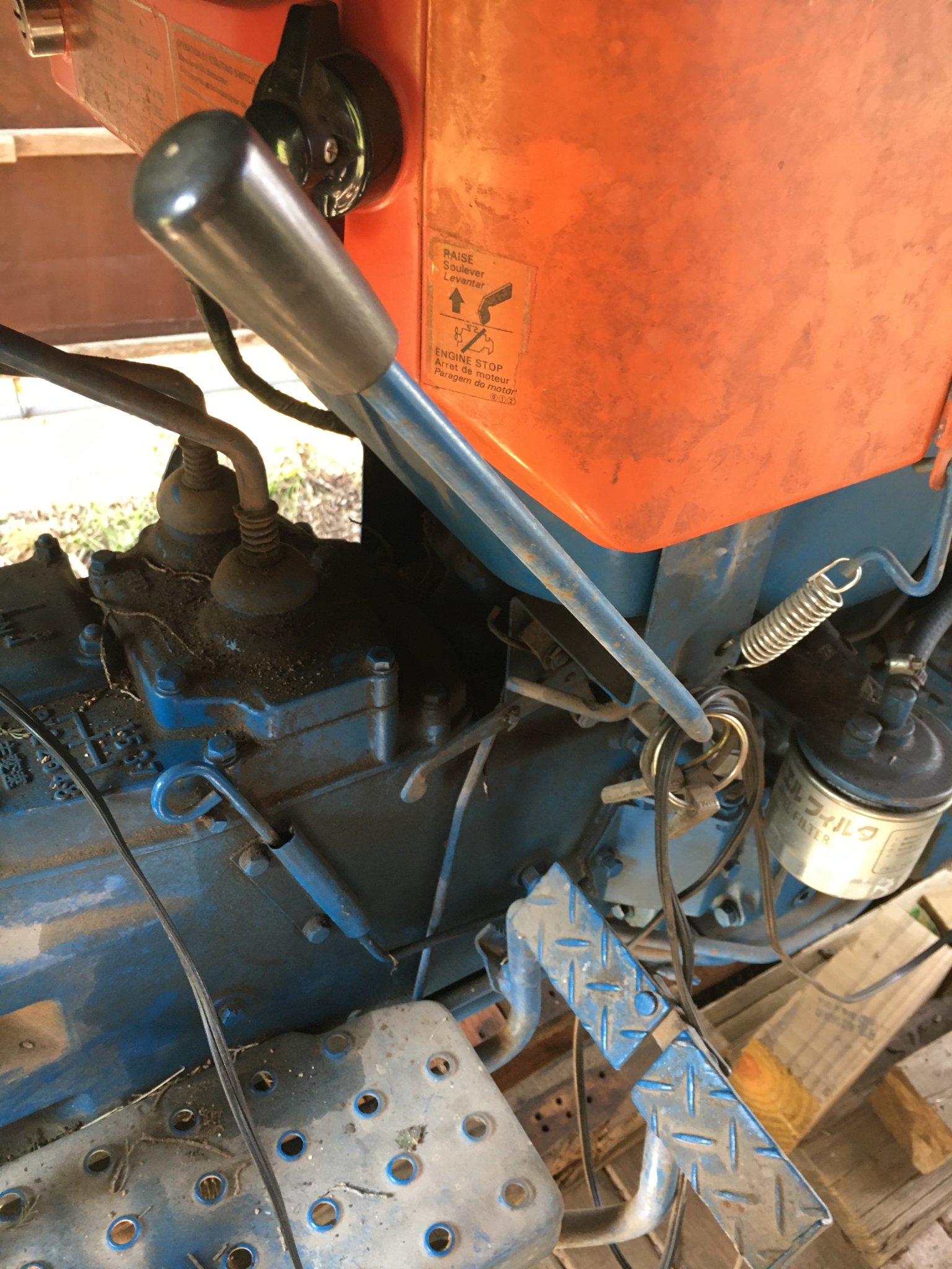

Here are some pictures of the throttle linkage
Foot pedal and spring
The kill lever on my tractor. Notice it is being pushed down by the rod on the right. Also the foot pedal rod is shown along with the spring that returns the tractor to idle.

More pictures
This is the hand throttle
F20EB07D-556A-42F9-AFE3-F9ECFCFECFF9.jpeg This rod extends from the lever assembly to the injector pump
84EF4469-C2ED-49BA-A44B-54FB472242C6.jpeg This shows the kill lever and the connection to the foot pedal linkage
E64AC5A1-C7B6-4358-A58B-7D44B709BE48.jpeg The lever being pointed to will kill the engine when pulled up. I had never paid attention to this but the lever is simply pushed down by the hand throttle or pulled down by the foot throttle. There is a pivot point that I could not get a picture of just to the right

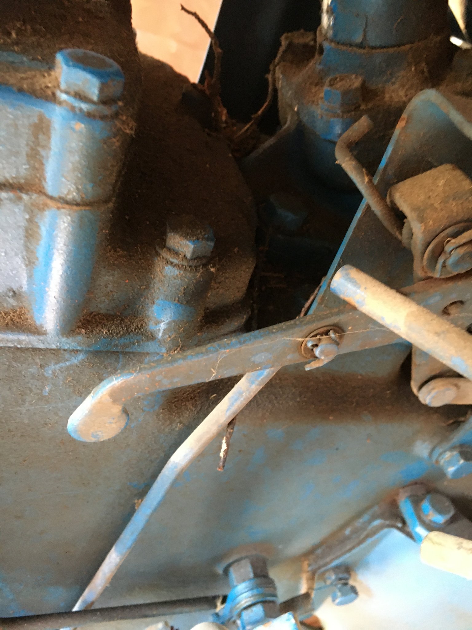

This is a top view of the rod from the kill lever to the injector pump
This is a close up of the kill lever assembly trying to show the pivot point

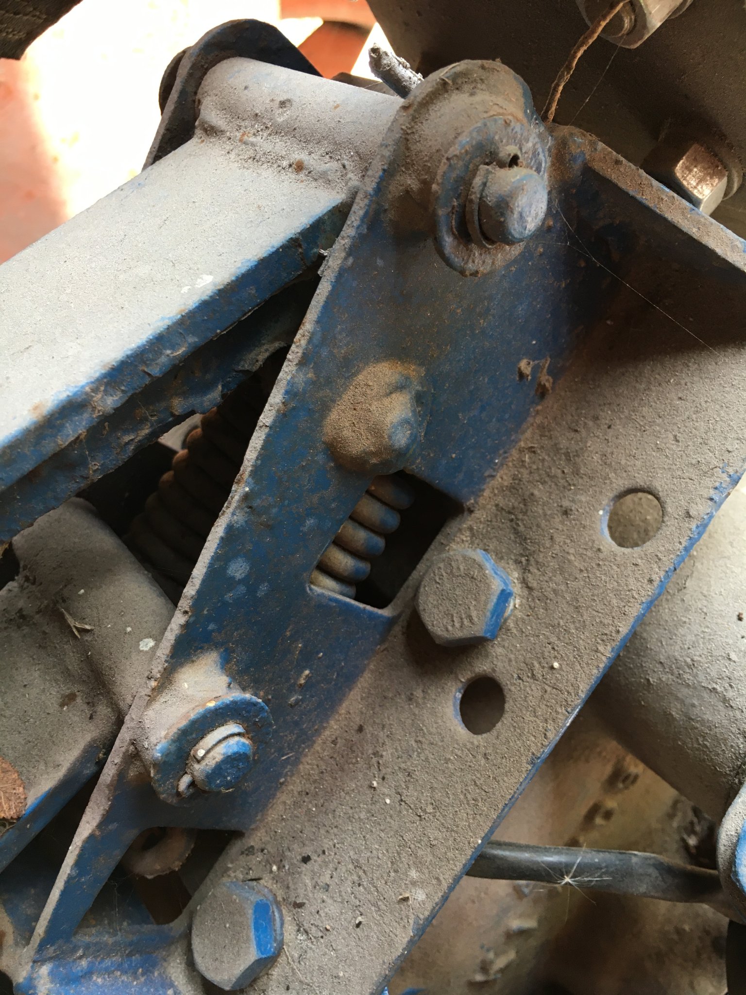

Springs now
this is the seat suspension
2B4C3AE2-7044-4312-843B-3E82336EAA60.jpeg Springs for seat suspension
pedal return spring (same for each pedal)

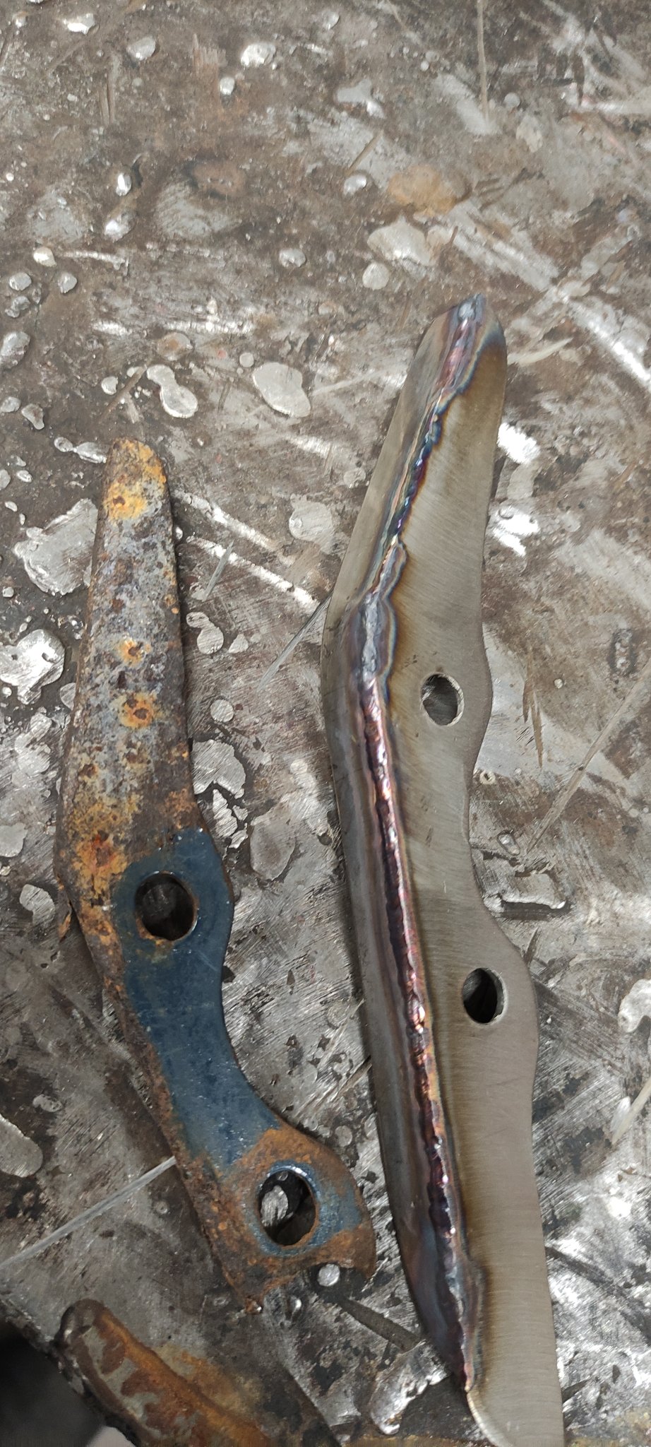

Thanks very much for the photos Russell This clears up quite a bit for me. I can see from your photos I'll have to make a little accelerator pedal and modify my step to carry this. I'm missing a lever at the end of this pedal that takes the vertical bar. I'll also have to weld on a bracket to the step to carry the springs for the brakes .
My decompression arrangement is different to yours ,no cable just a steel bar. I definitely didn't have a sprung seat so those 2 springs are still a mystery .
I went through the parts manual 4 times trying to see where the small bracket I just remade fitted and couldn't see it. ...but I'm almost certain I have seen it in the past while looking for some other part.
But I have plenty to get working on now . Between the parts manual and and all the photos posted my jigsaw has a box to work off . Thanks for all the help guys.👏

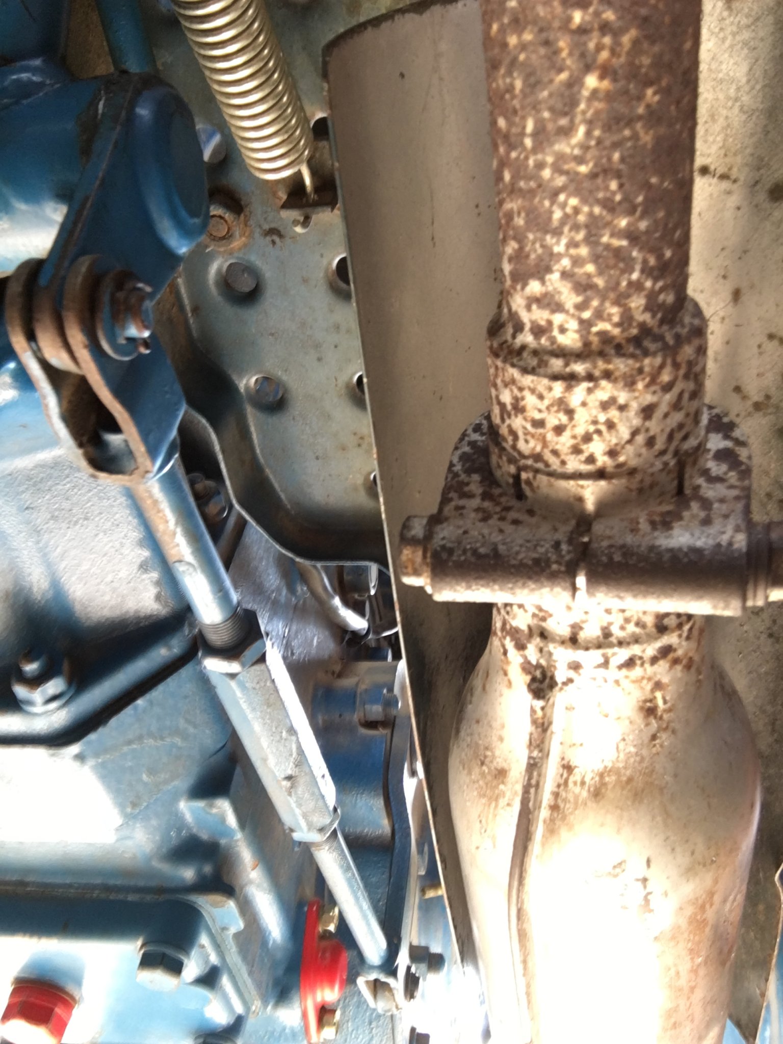

this is the rod linkage from the front to rear for the brake system
