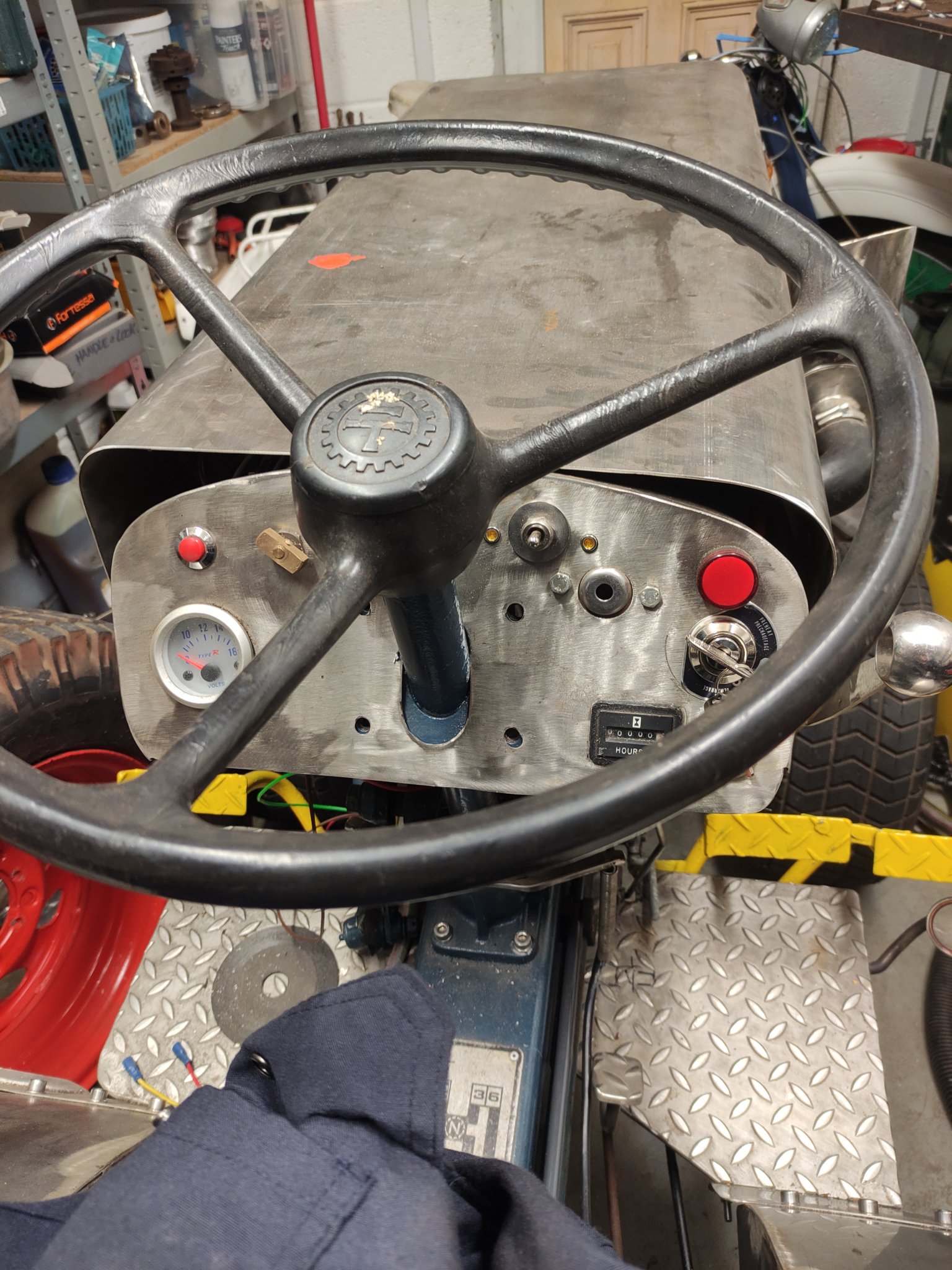

That's the view of the dash and bonnet....not happy with it. I made the dash to the same shape as the original yrs back. I didn't have the original bonnet plus didn't/don't have the skill or equipment to fold the bonnet to the original shape so the bonnet stays and the dash will get pimped to fit snug under the bonnet in the future. But for now I've spuds to get planting so it will do until next winter.

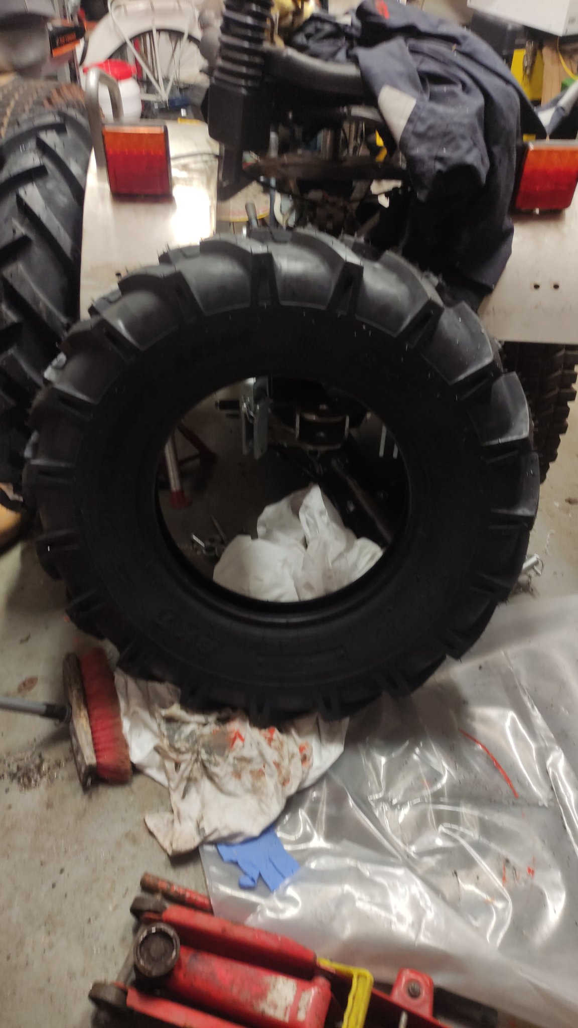

Second coat on...it's brush finish but given these are going to be up to the axle in mud in a few weeks it will be fine . Agri tyres in the post. IMG_20240217_185227.jpg

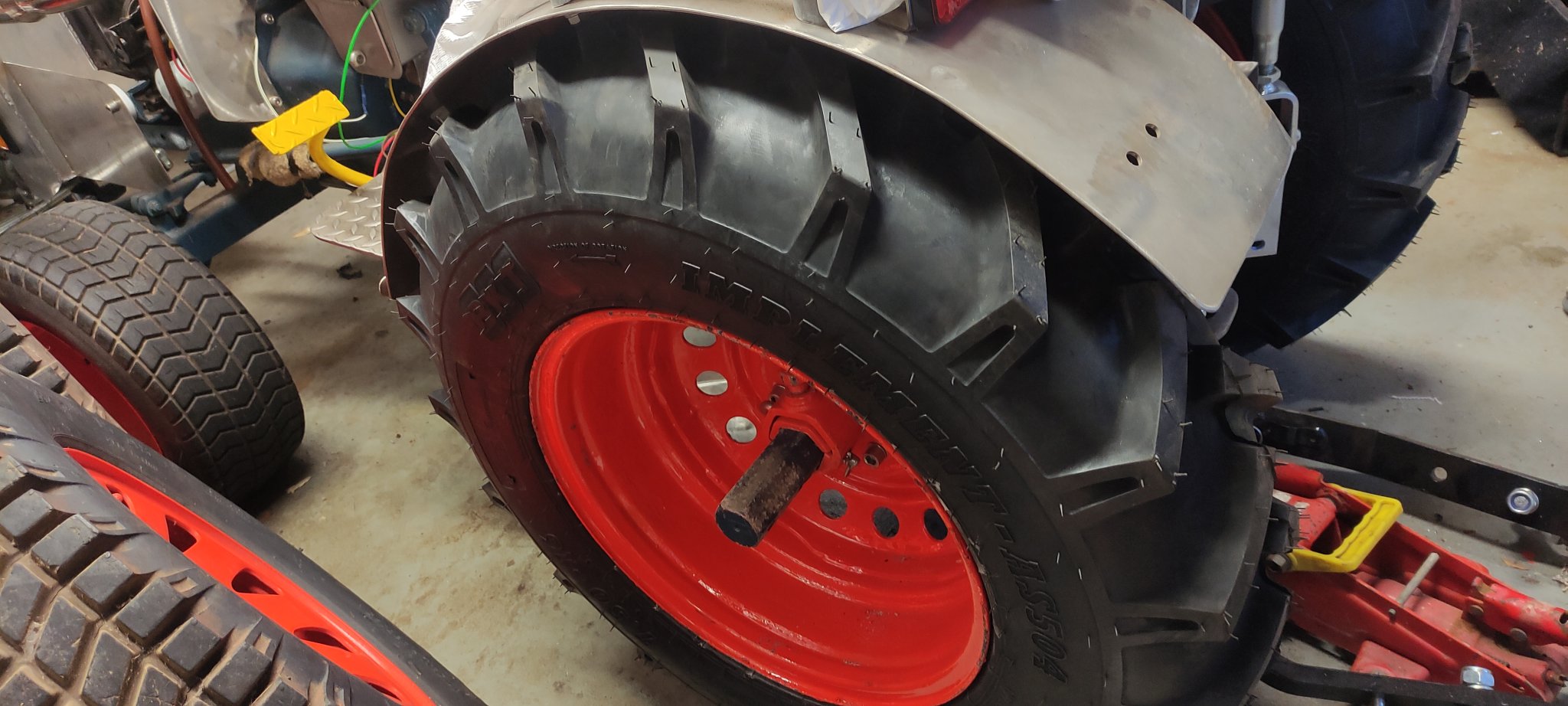

Had to turn the wheels inside out ...but delighted with them . I placed them in the closest position with 2 wider positions available

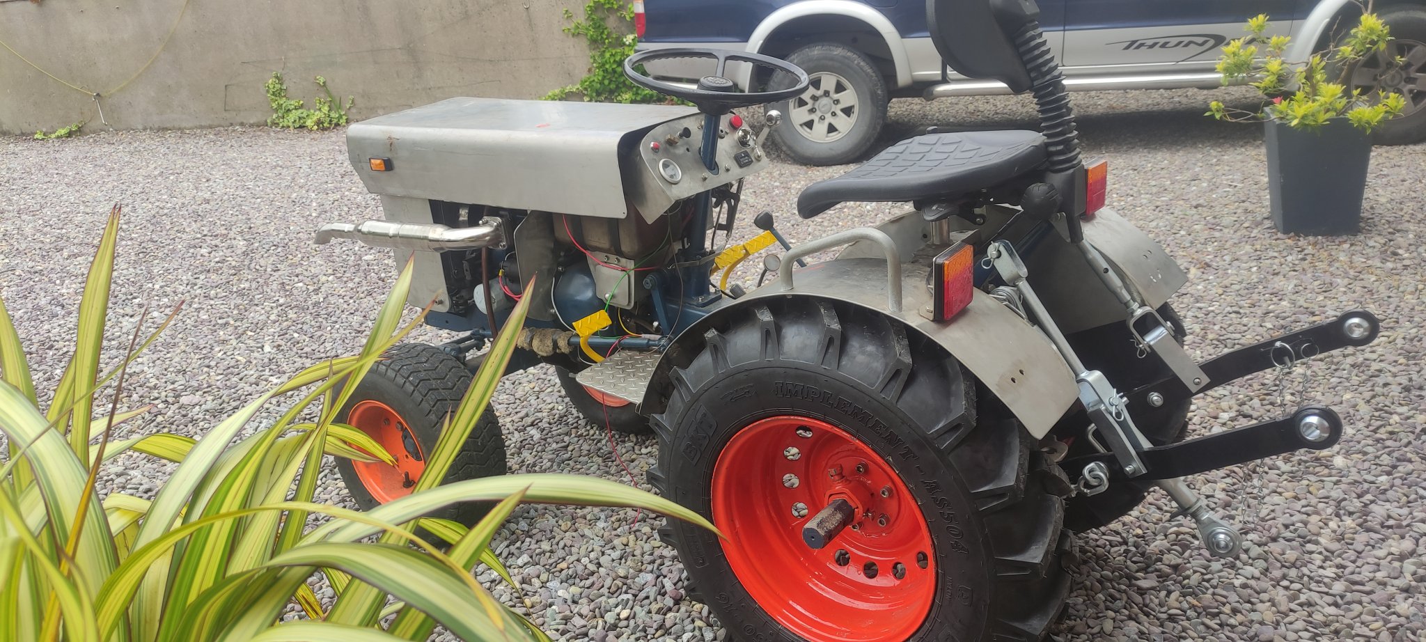

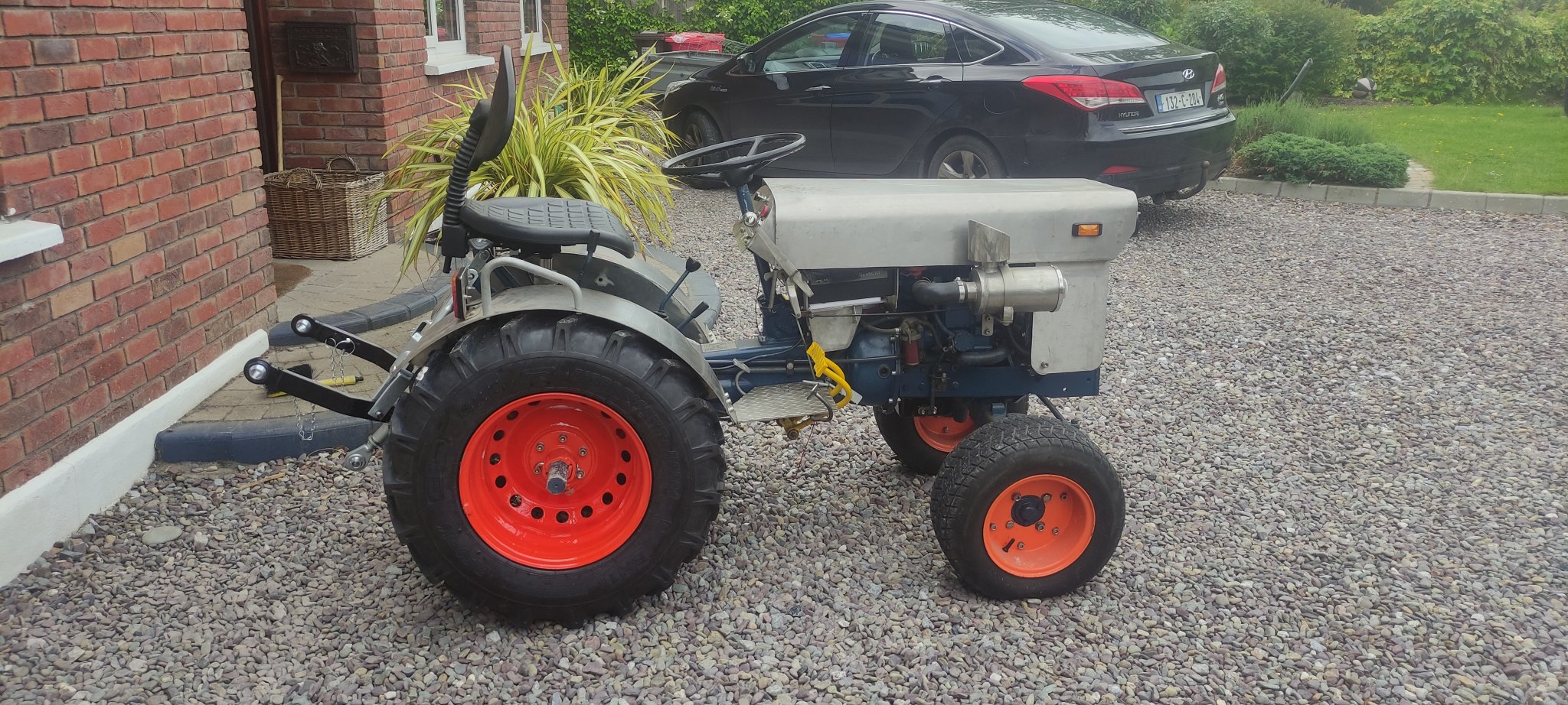

Not fully completed but enough done for this season. She is ready to do a bit of work in the field now.
I've a few guards to make up but as I work out the kinks it will be fine.
Must also make up some weights / ballast for the front but I can add them after.
Thanks to everyone for all the help ,ideas and input ...I really didn't think I'd get there.
