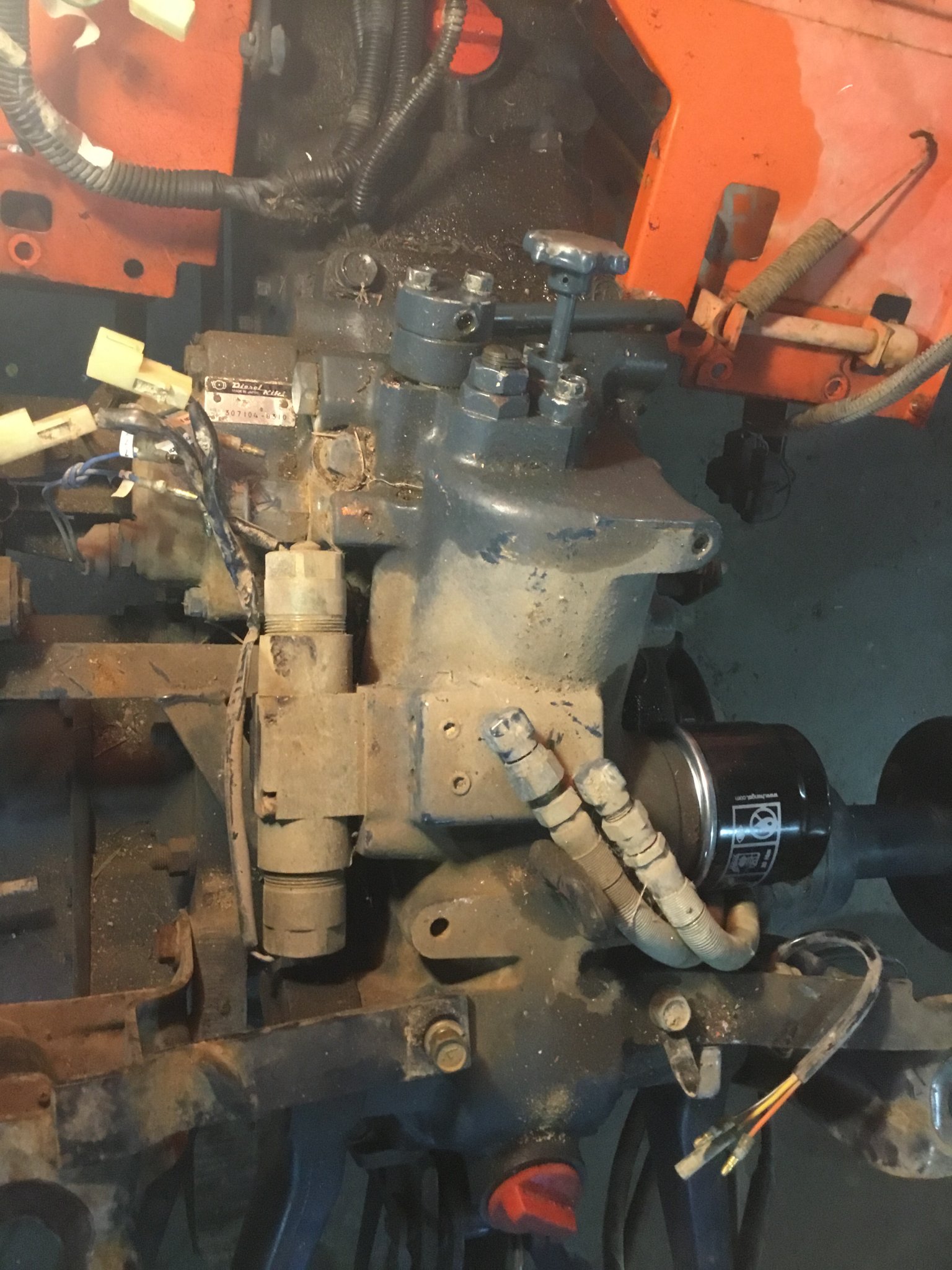

Well , been all over the wiring and have found nothing….the ram on th right side of the hitch works fine hydraulically with its manual switch , the control valve is under pressure , and I can lift the three point up and down by hand with no resistance!
But no hydraulic operation on the three point itself…

There may be a push rod between the cylinder and the arms to move the arms. It may be missing, bent, broken, out of position?
I don’t even recall how to get to it but it is in line with the piston movement.

Well , I’ve scrapped the monroematic and installed a simple joystick operating the lift solenoid 2 way valves…..
leaving the hydraulic ram on the one arm to give me level control…it works like a charm, very happy!

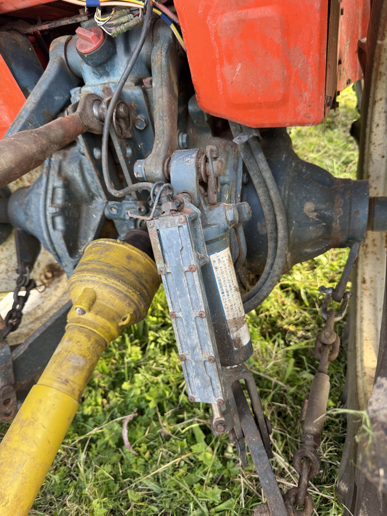

I just replaced the rear wheel and cover over the filter! I also drained 3 gallons of excess fluid! …. Don’t know what the previous owner was thinking?

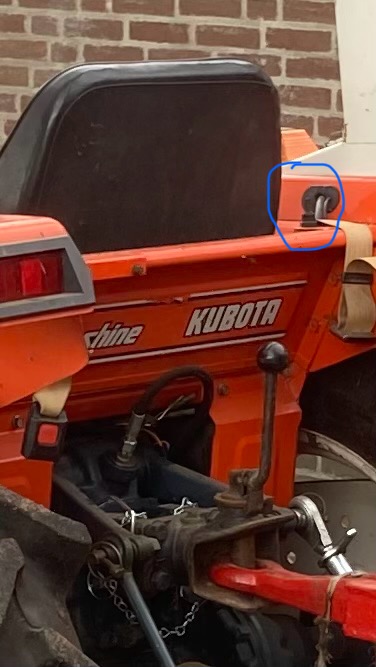

Hi,
a question about the light in the back in this picture. How is it wired? And does it have a separate switch?

Hi,
I own a Sunshine L1-225 and try to figure out how to easily install worklights.
I don’t see the photo with a light…if you mean the back facing single light behind the seat it has a wire run from the ignition switch thru a on/ off toggle mounted to the left of the seat!
Yes, that’s the light i revered to. Thank you for the quick answer.

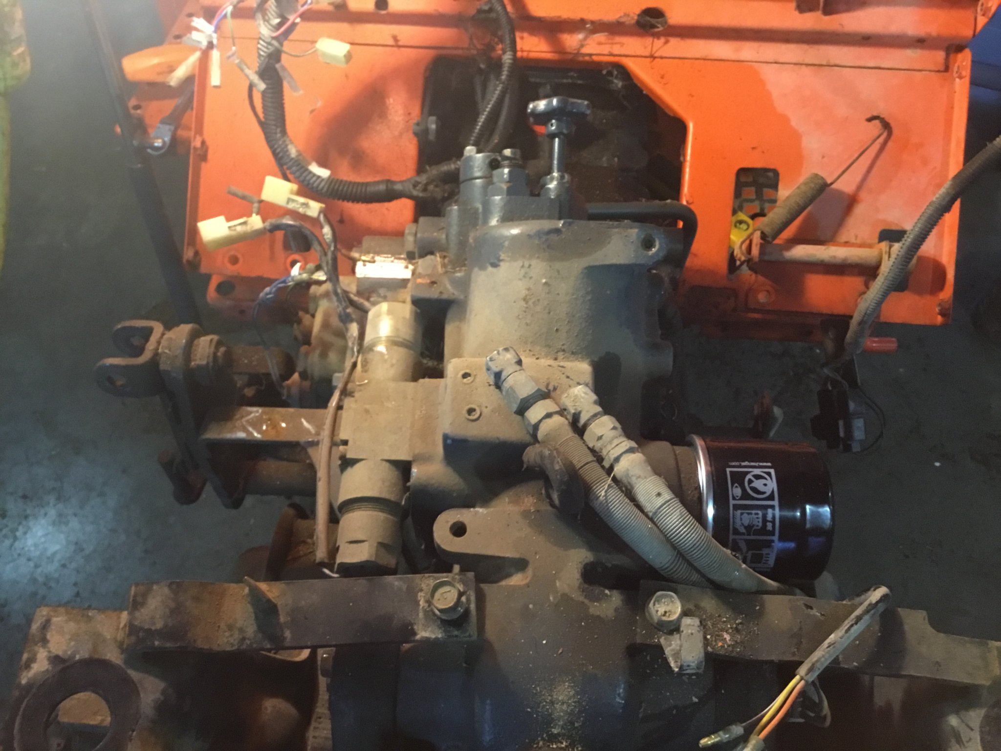

Can you share you connections to connect the switches for the lift and for the leveling cylinder. I just purchased a similar tractor ( can't find the model so far). I'm not sure which solenoid does what at this point and it would speed things up a lot if you can share. Thanks

Bearville, can you post some pic of how you plumbed the valve for the lift? I have the same system and all works except the solenoid to lower the 3 pt is bad and I can't find a source anywhere for it. I would be happy doing the same thing. I'm sure with time I can figure out how to do it but it would save lots of time if I could see how you plumbed it in.

As long as the solenoids are still good, you can wire in a toggle switch to the two solenoids on the top electric valve. One solenoid controls up and the other controls down. THe lower two solenoids control the up and down of the 3 pt itself. Nime works the leveling cylinder great with a toggle but my down solenoid is fried so I cant lower it, UGH cant find a replacement anywhere.
