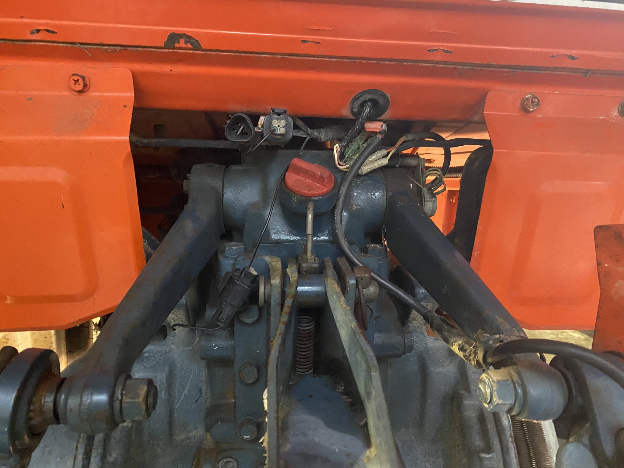

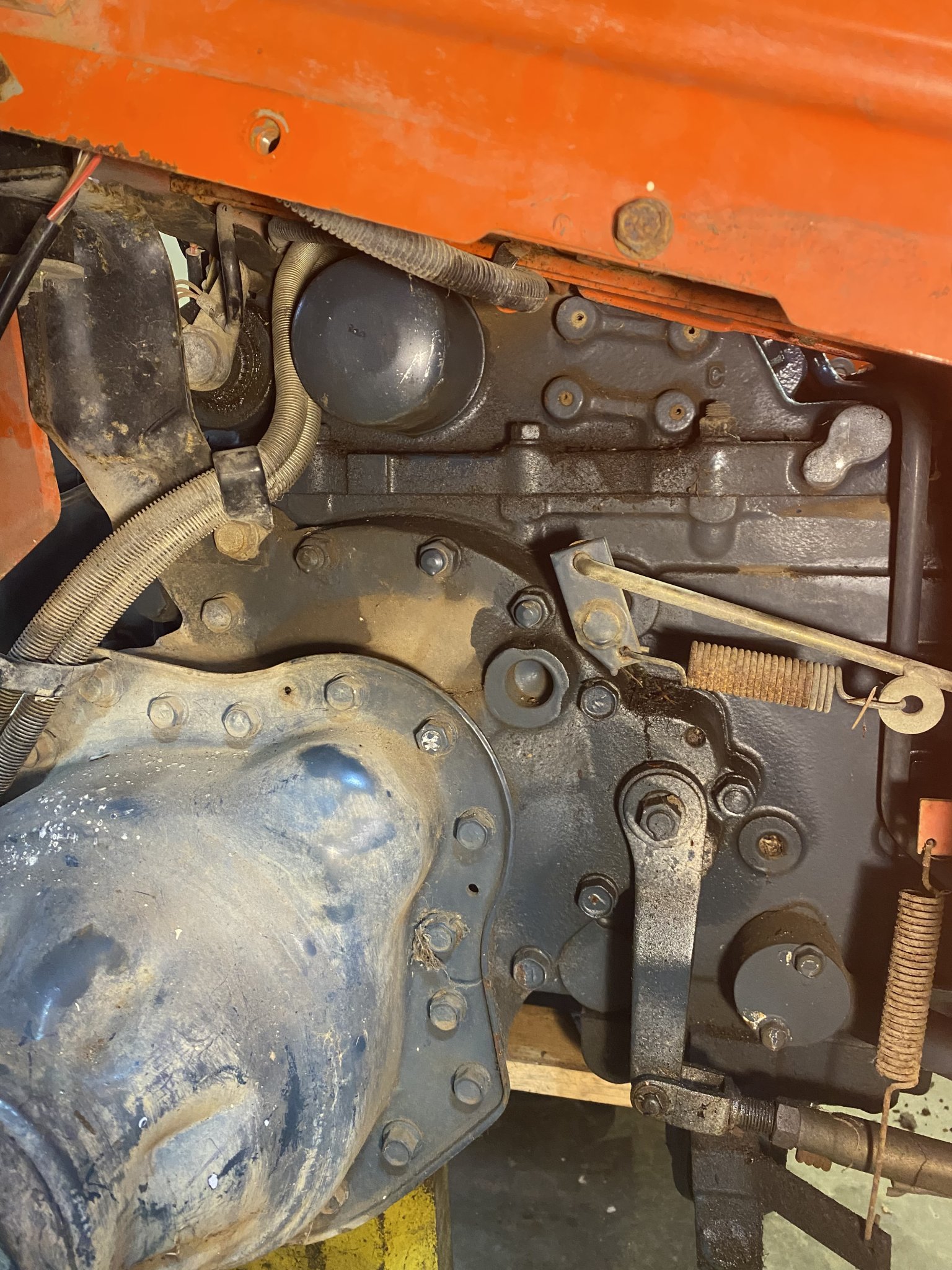

I just got the tractor and found the 3 point hitch inoperative and want to start with filter and fluid change, but would like to know numbers and capacity’s ( presently the trans is way overfull) . I pulled the speed control valve and encountered a big gush of oil , releasing the arms…it seems I have a restriction somewhere….

Speed control valve?
Oh you mean the three point drop speed valve, right.
And yes if the three point was up, pulling that valve will cause the piston to shove oil out.
If the valve was turned all the way one way it will lock the three point.
Does it have a loader on it, or any other added hydraulics?

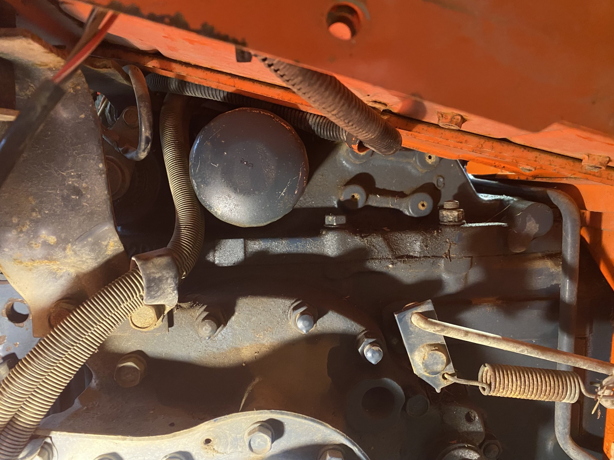

Take a couple pictures on the right side around the Hydraulic pump and filters.

I'll set you up with the manuals when I see your setup and that will help us both.

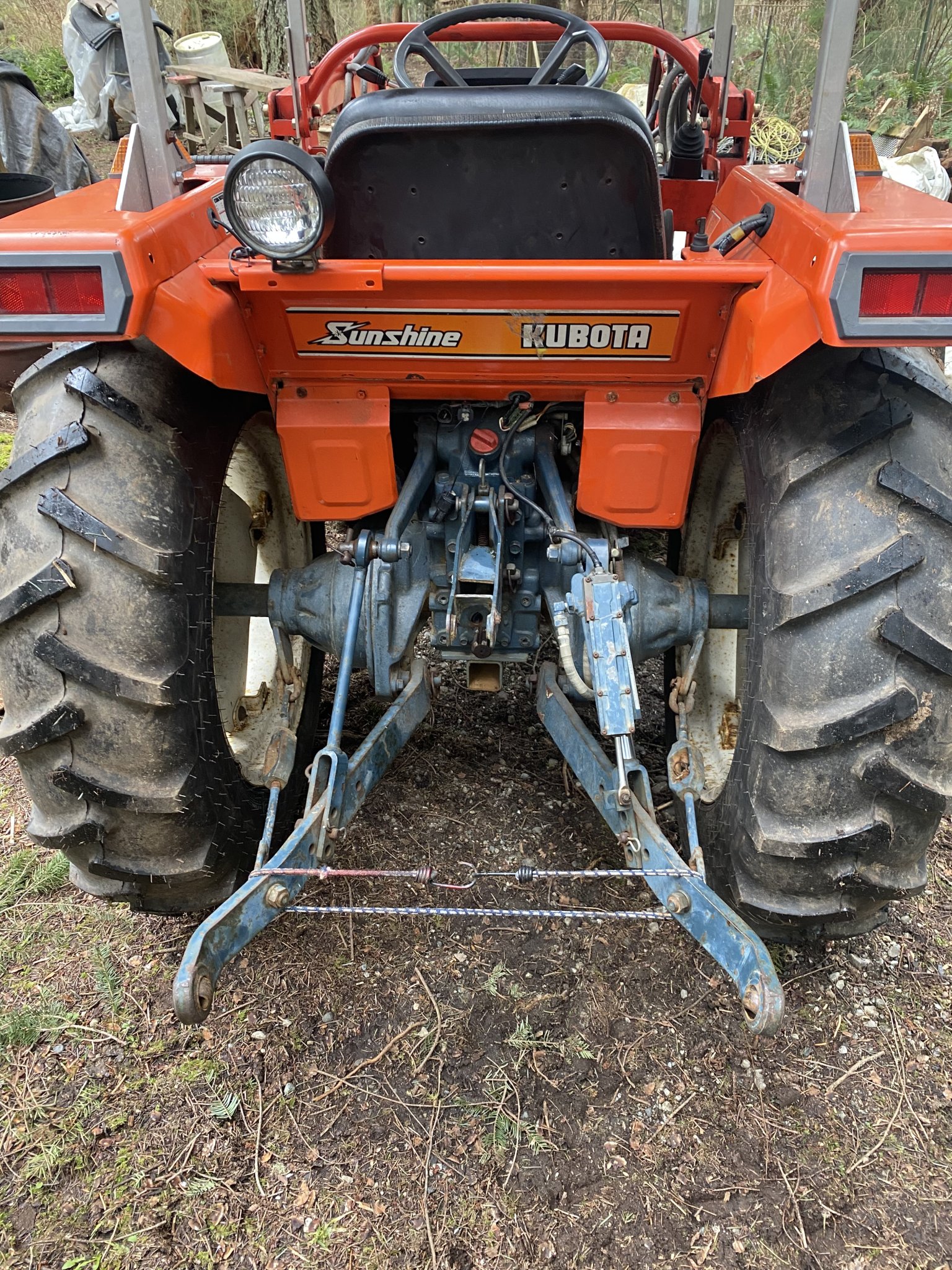

Can you do a couple more zoomed out so I can get a reference where parts are?

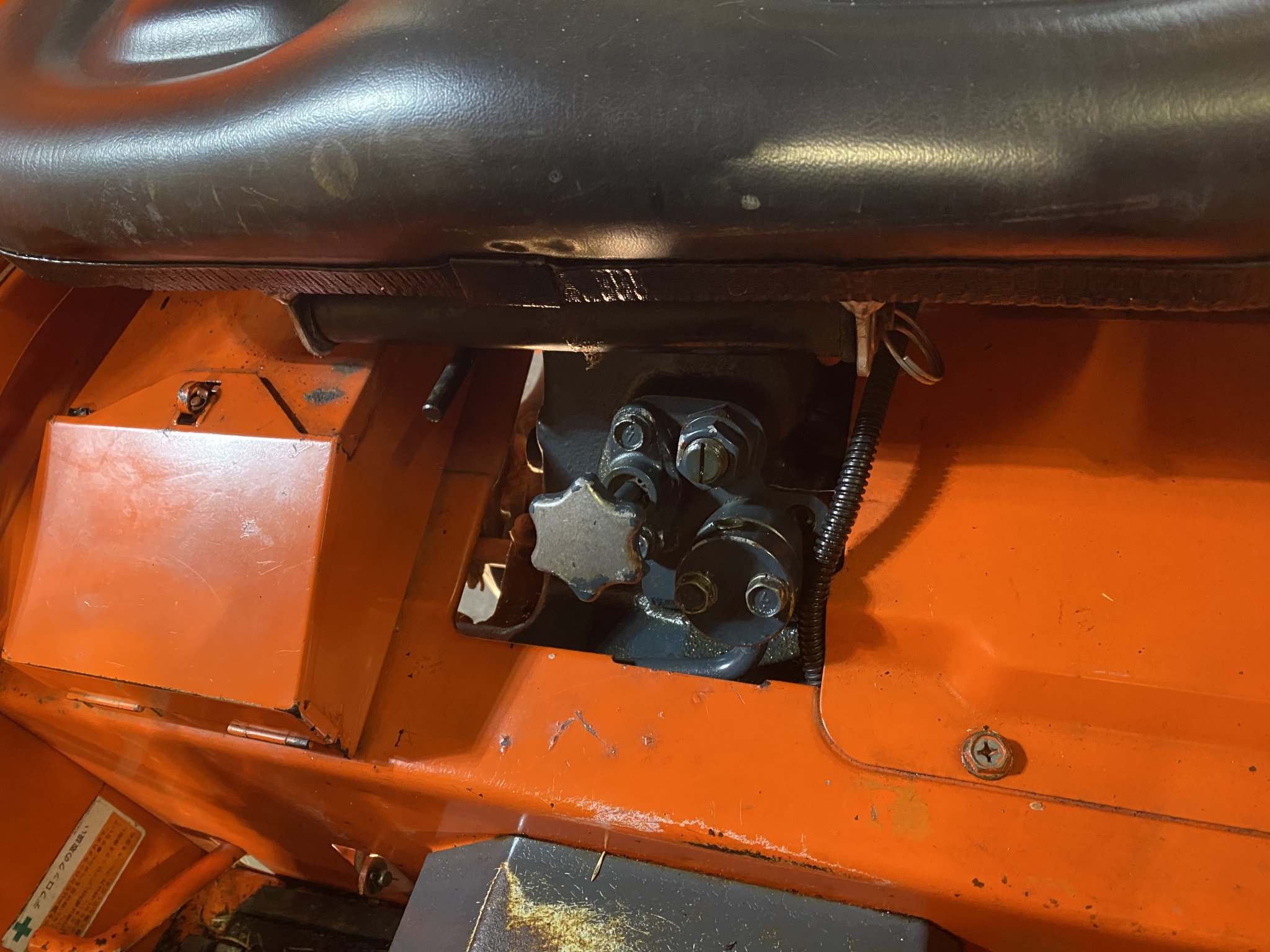

Is the three point controlled by a lever on the right side by the seat?
The reason i ask is some of these models have Monro Matic controls for the three point, with are electric controls.
Also if they hooked the loader up wrong that can cause issues with the three point operations.

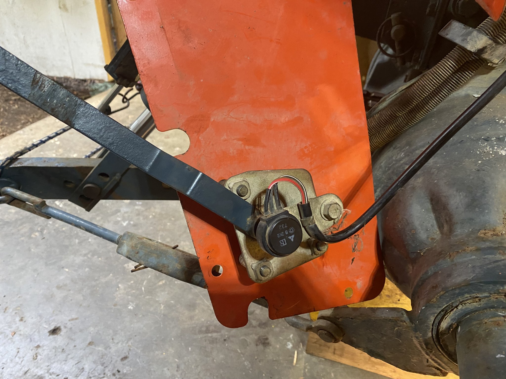

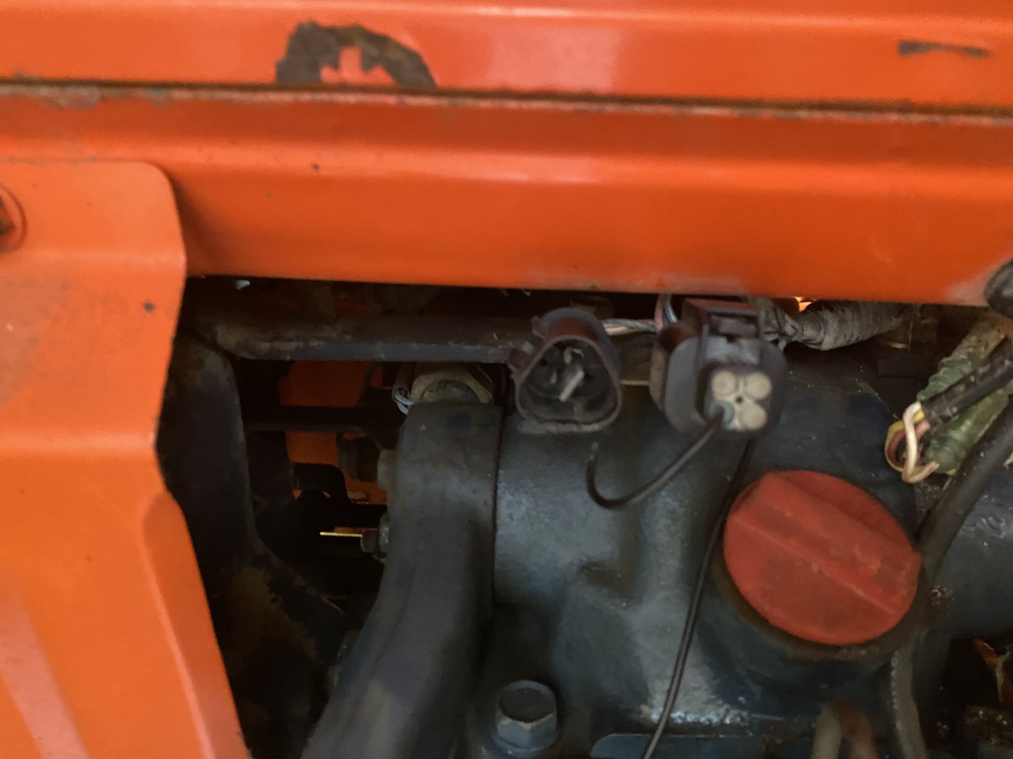

The three point is controlled by the lever on the right side ( the back of it is in one of the pics..I removed it with the panel covering the filter)
And it is the Monroe matic set up… Which I don’t need ( can it be bypassed)?

Now I’m wondering if the extra fluid is to accommodate the loader ! Usually extra oil blows seals but maybe it’s not an issue here?

No you don't need extra oil with the loader attached.
Your right in that too much oil just blows seals.
No you can't easily change it to a manual operated system.
As far as your three point goes, I will have to see if any of the manuals I have address that, it's not used on any US or EU models and are rare and the only manuals I've seen are in Japanese.
To start with inspect all the wiring and fuses looking for any faults.
