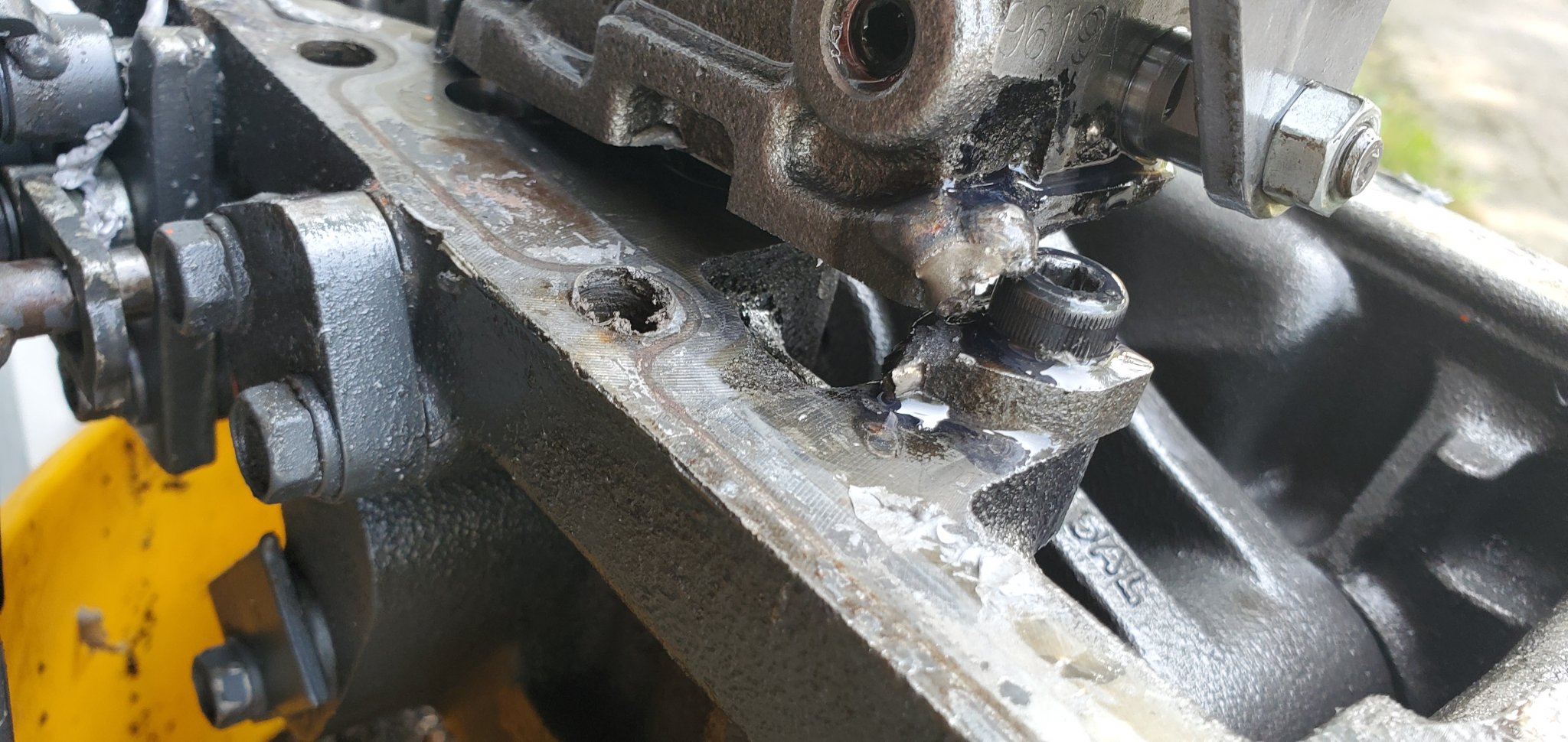

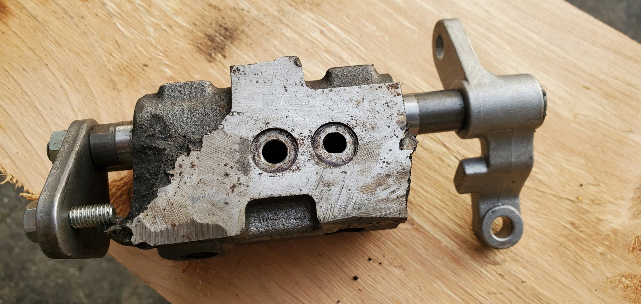

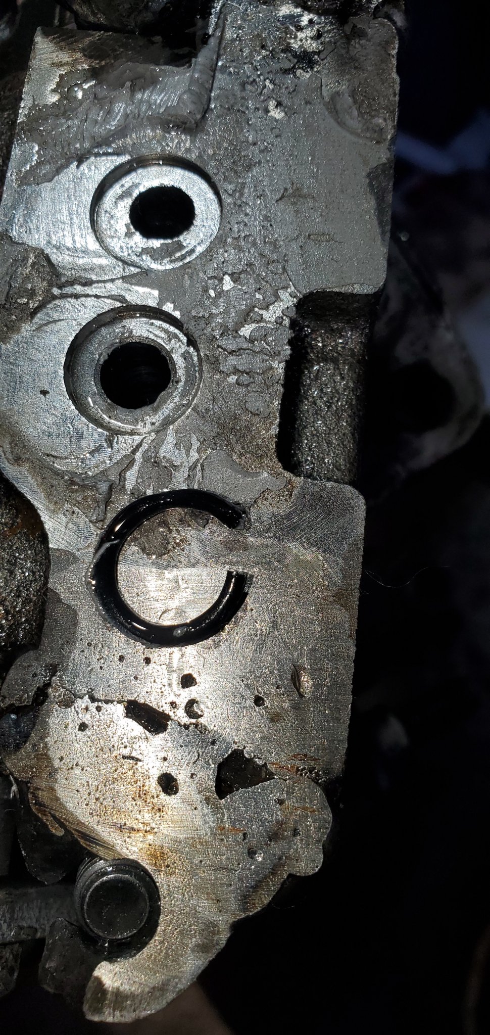

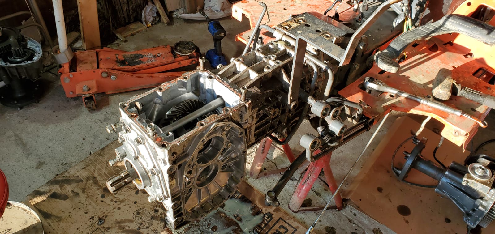

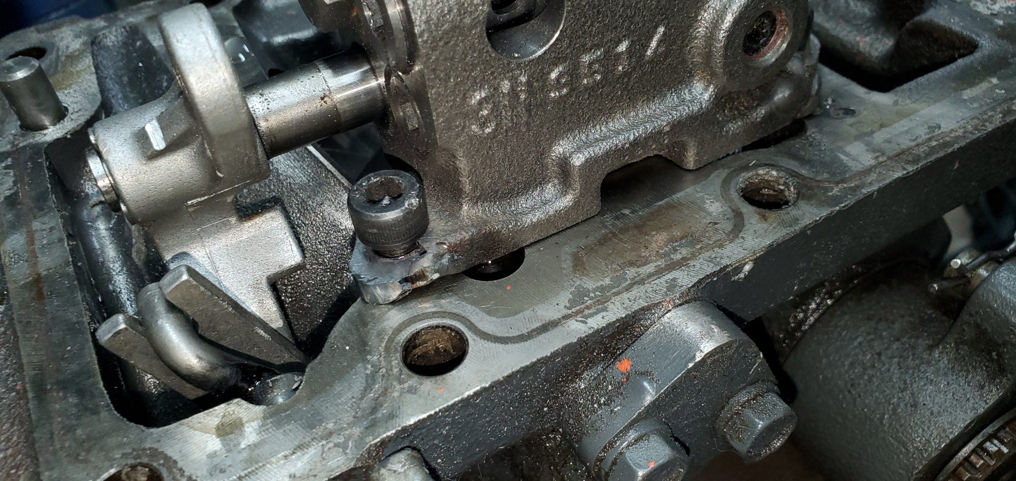

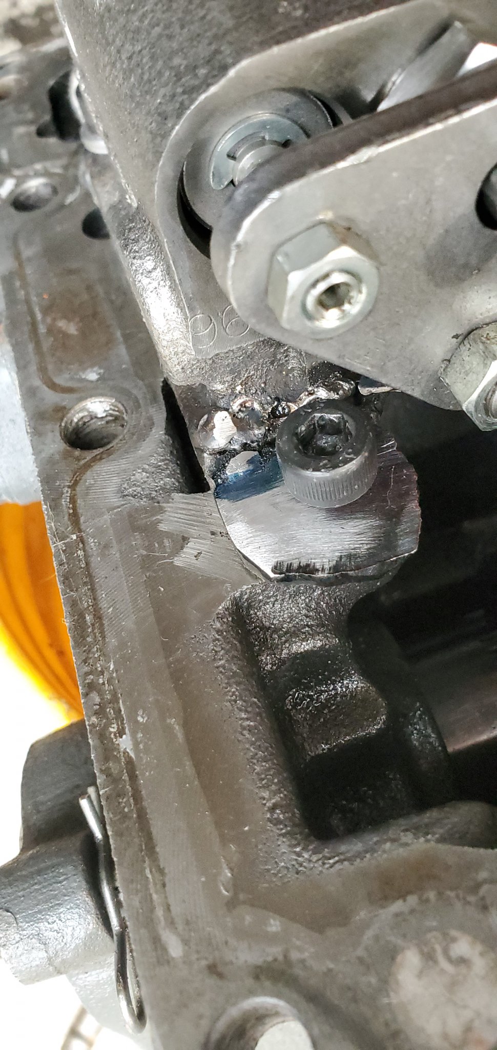

I know what caused the 3pt Hyd control valet to break and i have fixed that. I just need to install the new Hyd Control Valve.
a: shows the broken control valve
b: shows control valve removed from the tractor
c: shows case opened up
d: also the case opened up
e: shows the valve fix
f: shows valve and recovered o ring
g: shows valve installed after repair
h: shows the relief I ground into the 3pt piston rod to clear the Hyd control valve
k: shows case back together
