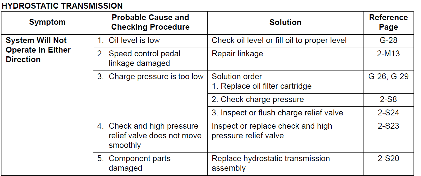

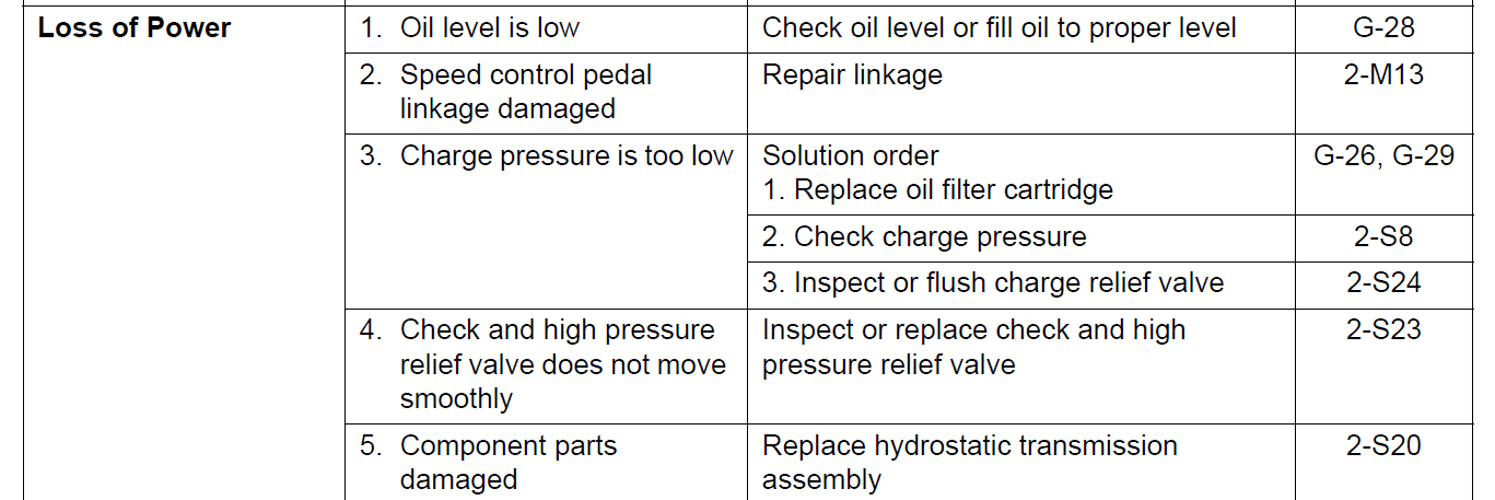

Follow the troubleshooting in the manual.

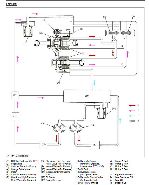

I dug up the manual and looked at the diagram. I see where the HST gets its oil from now. Makes more sense what the poster above indicated RE the PTO and charge pressure.
14 is the power steering pump, which pressure not used by power steering is directed at the PTO clutch and then through the filter, and into the HST. I would assume you already replaced the filter. If power steering is OK and PTO engages all the time, but still have loss of power, I still suspect the PRV is the cause. There could also be a restriction between the filter and HST.
I own the manual, I have ran troubleshooting tables. Not seemed to resolve anything?

If power steering is failing, I think you solved your problem. The pump is bad. According to the diagrams I posted above, power steering is supplied by an engine driven pump that is inline with the power beyond pump that drives the FEL and 3PH. The power steering pump also supplies pressure for the HST to function.
Since the power steering is before the HST, check pressure going to the steering unit first, if good pressure, then it could very well be the steering gear causing it.
