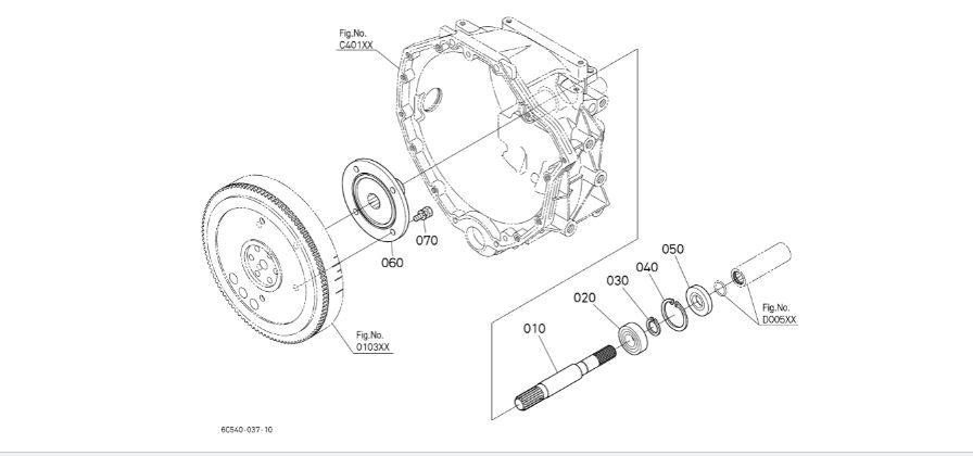

Then what is the clutch for on my 2601? I see a PTO clutch but there is also a larger clutch.
28,676
5,099
You don't have a travel clutch on that model.
Only a PTO (hydraulic) clutch pack.
You have 2 pedals on the left hand side right, they are both brake pedals.
28,676
5,099
It is a clutch HOUSING, and this is what's inside of that housing.
NO clutch!
Just a hub (60) that bolts to the Flywheel (fig No. 0103xx) in the picture.
You really don't believe me when I tell you, you don't have a clutch do you? :unsure:
