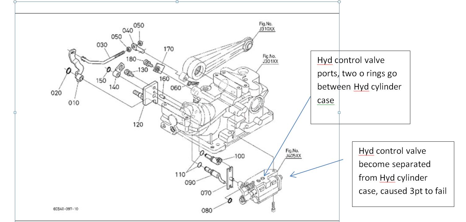

Picture 8 shows where the Hyd control valve was cracked.
Picture 9 explains how it was cracked.
Picture 7 shows the connection point of the control valve with the Hyd cyl Case, this piston is what raises and lowers the 3pt.

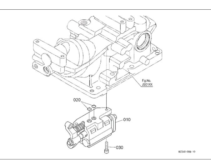

Can you show me where the 3pt hyd control valve is on this drawing, please? I am referring to item 10 in this drawing?
No code has to be inserted here.

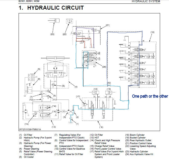

I have some clarity on this now, there are two hyd circuits, one controls the motion, steering, and bucket. The 2nd controls the 3pt. So, does that mean they are not connected in a series, can the 3pt operate or not operate independently of the other 3? This would explain why I was able to continue to operate the tractor as a 3wd HST frontend loader instead of a tractor!
34,263
9,481
Circuit 1: #3 on the picture runs the steering and then the PTO control.
It does not control the feed directly to the HST.
HST, is run by a separate pump just to the right of the M (tractor's motor) on the picture
Circuit 2: #2 on the picture runs the Loader, the BH if equipped, and the three point.
At the words where it says "one path or the other" is where it would route through a BH if Equipped (up facing line), if not equipped with a BH then it goes to the three point control (right hand path).
The reason all this matters is that if there is an issue in either Circuit #1 or Circuit #2 it does effect the fluid that is also shared by the HST.
One issue can be foaming of the fluid.
