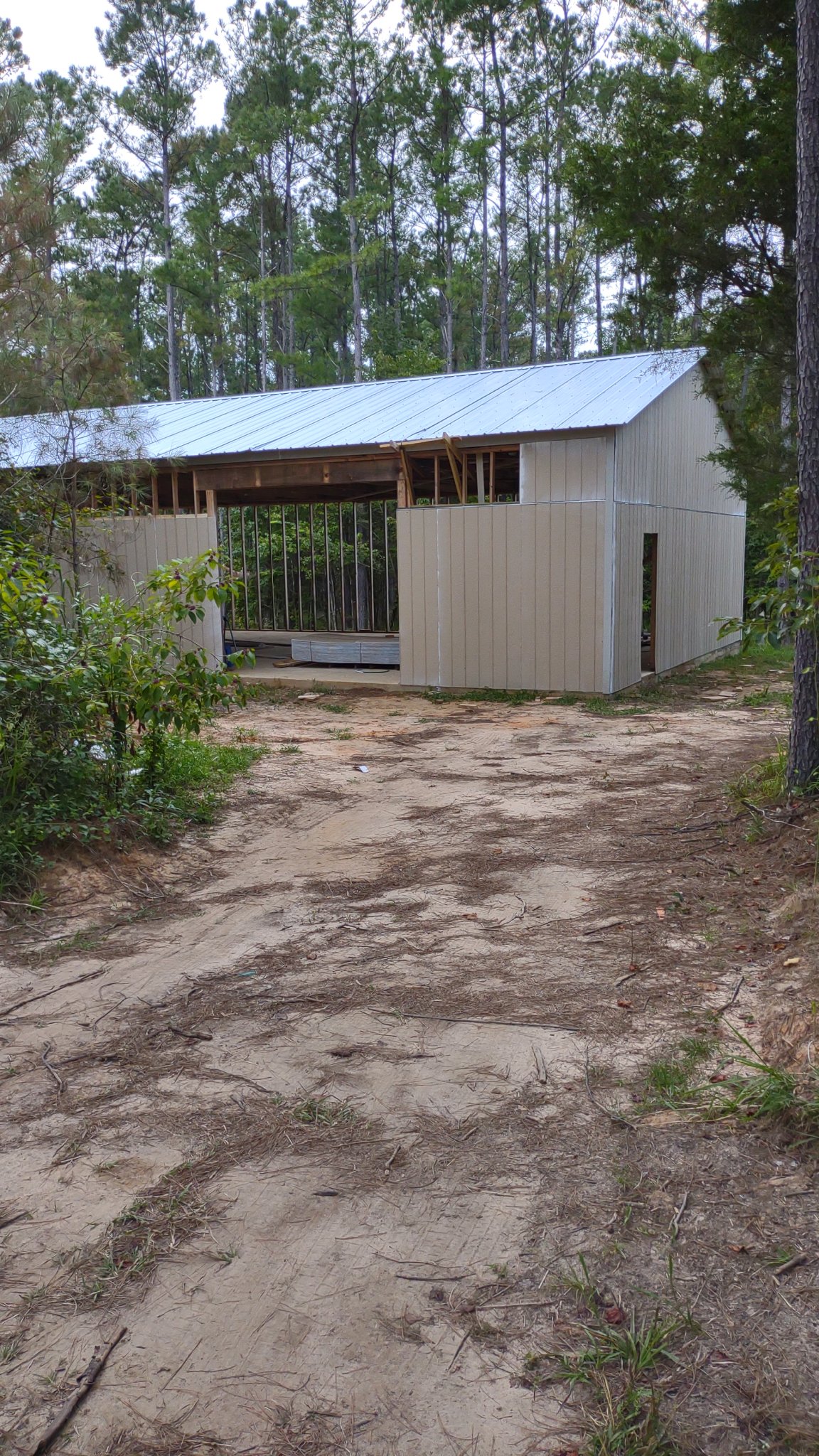

BIL helped me get the bands up over the truss ends and finish siding on one end today. My neighbor's geese came in to roost as I was picking up.
I helped them clear out a thicket along the county road yesterday. They found, or rather the yellow jackets found them, Saturday. Seems the little boogers didn't like the chainsaw noises. Ten got my BIL and one got my sister. We still haven't found the nest hole.

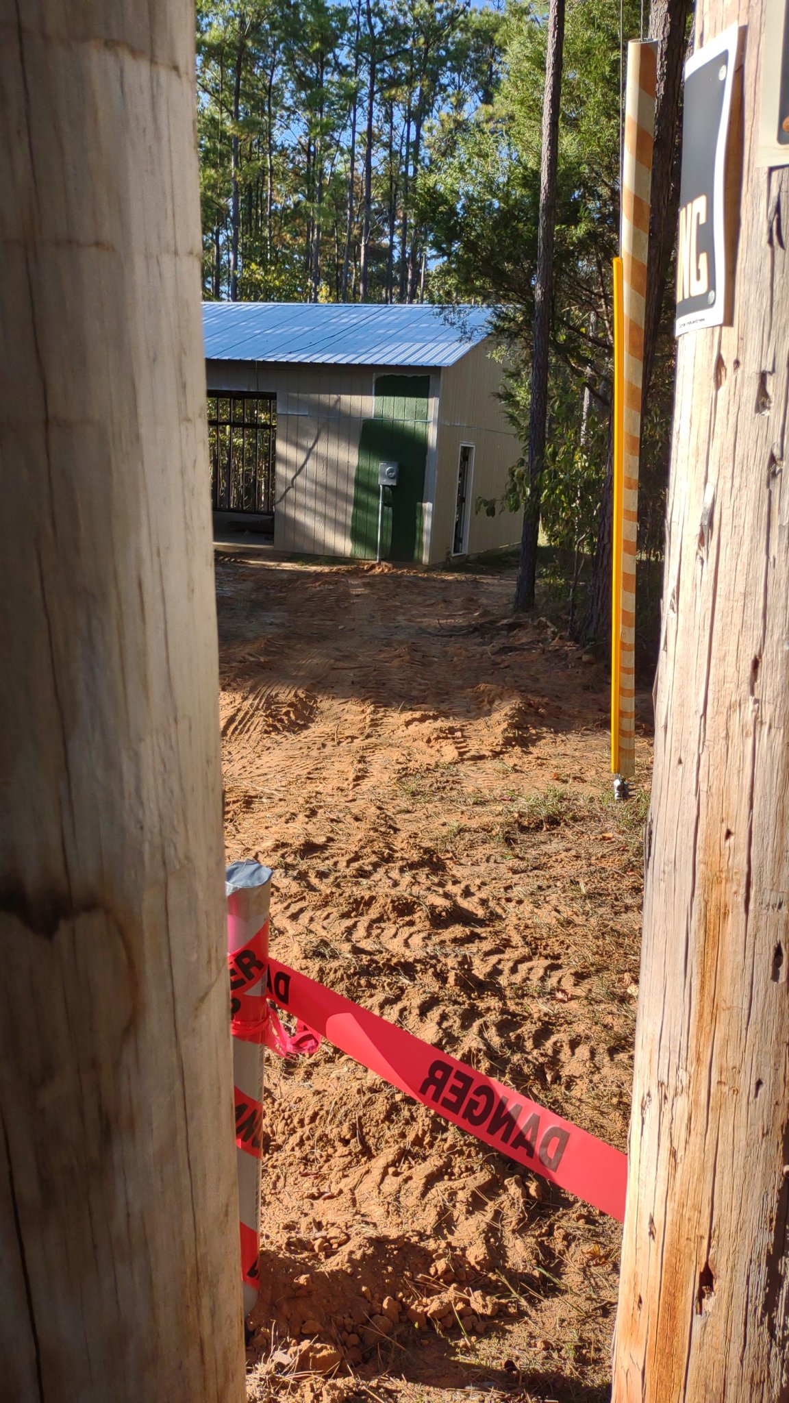

The front and east end are essentially done. I've mounted the meter base and breaker panel. I need to find an electrician to tell me how to do the grounding and bonding to the utility's satisfaction.
I've started siding on the west end. This corner is higher off the ground, so I've started using the forks to hold the panels up so I can nail.
PoTreeBoy
L35 Ford 3930
Mar 24, 2020
4,121
2,542
WestTn/NoMs
Yesterday and today, Katy and I dug a trench for the 2-1/2" electrical feed, ran the conduit and started back-filling. Hopefully, tomorrow I can backfill, run the warning tape and drive the ground rod. Then the power company can install the transformer on the pole in the foreground, and run the conduit up the pole and wire to the meter.
The green paint around the meter base is a color test plus I wanted a good coating under the meter base, etc. I think I'm going with it.

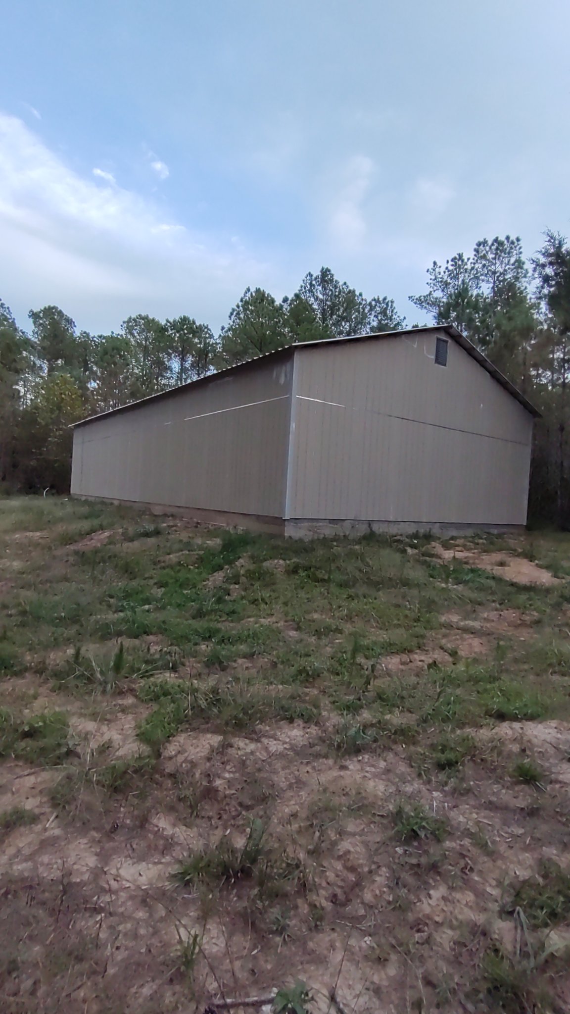

Siding is finished! I was on the ladder about mid-wall when I heard a low clucking sound. I looked over my shoulder as five turkeys nonchalantly walked by single file.
The power conduit has been backfilled and I heard back from the power company this morning. Everything looks ok and the connect fee is $300 (sounds cheap to me). Since they have to call 811 (to dig 3' from the end of my conduit, which I just trenched, to their pole :rolleyes:), it'll be done next week, JIT. I need to do more wiring for lights - it's pretty dark in there with the walls closed in.

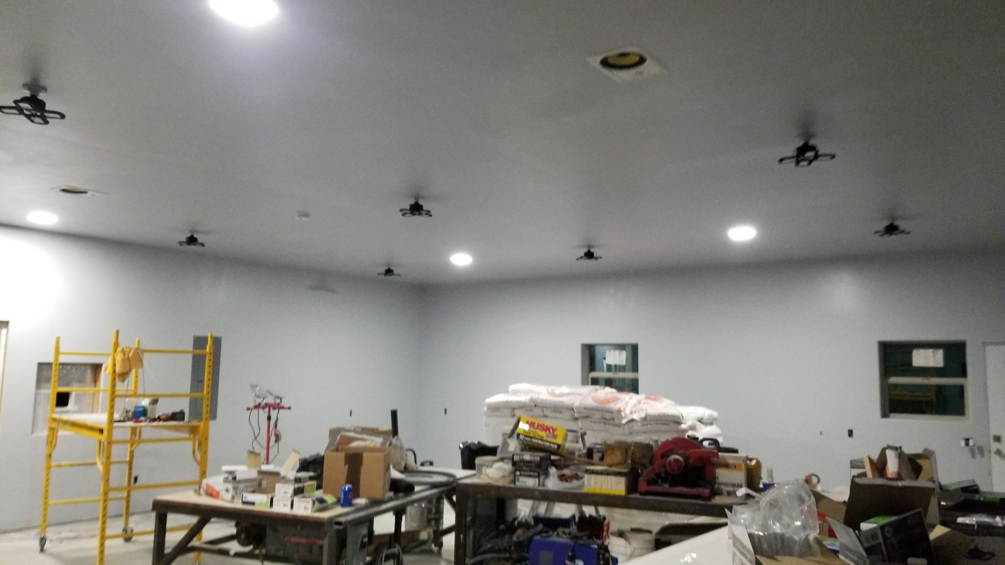

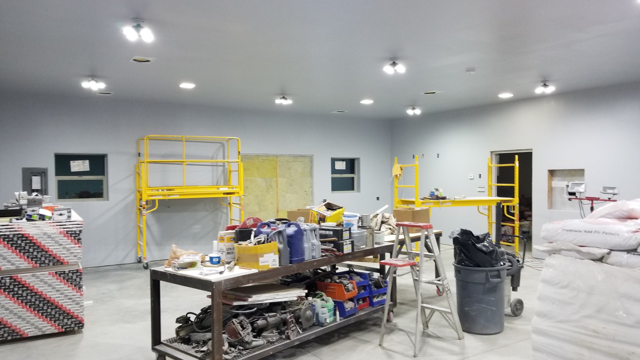

I'm planning on the fan-type LED NorthIdahoWolfman showed. I've got 2 80w (ordered 150w, box says 60?, bulb says 80), and 4 28w to start with.
I'm planning 14 porcelain receptacles, starting today.

As of yesterday everything's complete inside, lights, receptacles, two eave vent fans, miscellaneous framing. I'm sure I'll add receptacles, as needed. Still lacking are:
* Main door - coming soon, I hope
* Insulation - I considered having foam sprayed on the roof's underside, but $4,500-5,000 was more than I expected, so I'll do without.
* Roof screws - have to finish several hundred screws and plugging a few misfire holes.
* Paint - the downside of wood siding vs metal.
