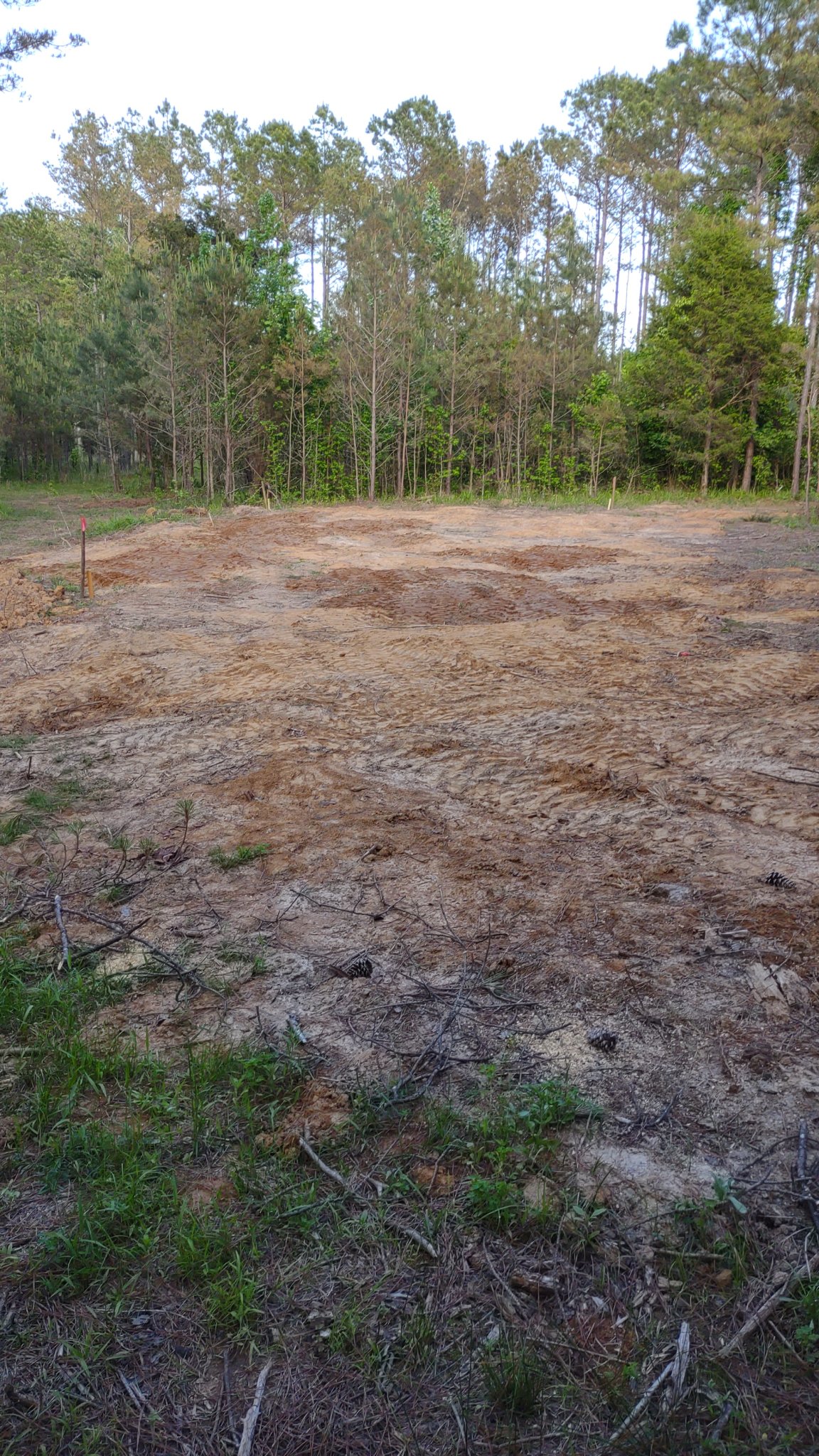

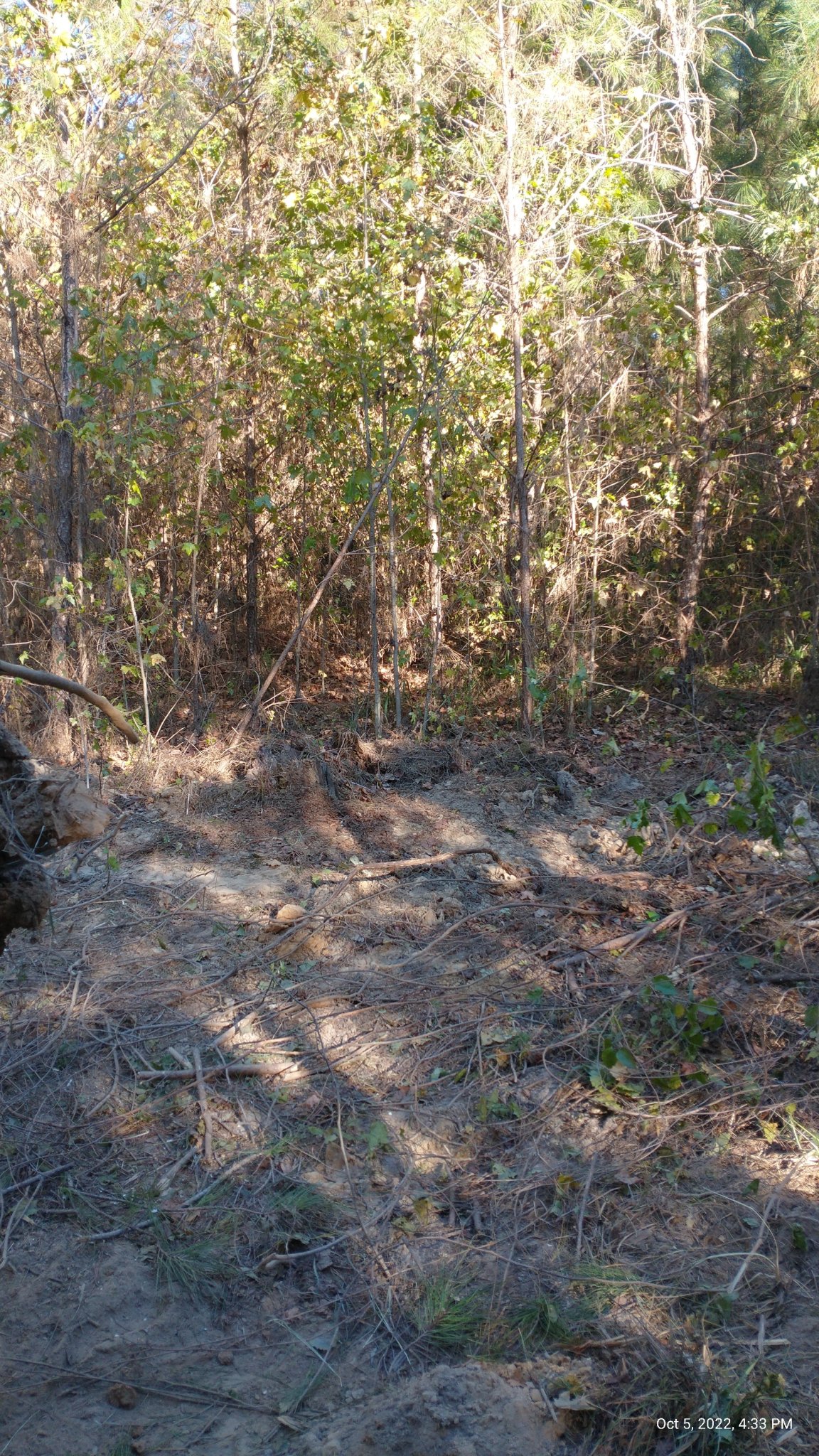

I picked a spot close to and parallel with the power line that serves the area. So I can get power installed cheaply, and it's accessible. Unfortunately, it was harvested and replanted about 7 years ago, so it had a thick stand of pine and weed sweetgums ranging 1 to 6 inches, as well as a half dozen pine stumps 24 - 30". Katy and I pulled, dug, cut and hauled trees and vines for a while, a real bonding opportunity, to make an 80x100' clearing.

Toward the end, I discovered that the ground on top of this hill is not red clay but yellowish loess about 6 ft thick. There's a narrow band on the east side of the Mississippi delta. Also, previous owners apparently created some terraces for farming. You can sort of make out one on the left side of the second picture. There will be a 1 - 2' drop behind the shed.
I finally arrived at a 30x60 size. 30' gives reasonable size wood trusses and is the depth of my sister's shed, which has worked well. I thought I would have space for longer, but 60' fits and will be plenty.

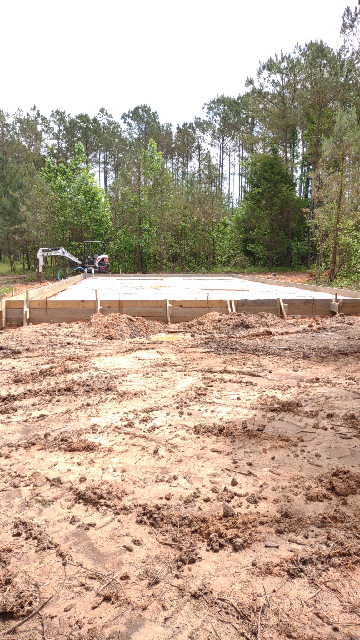

Mon 5/15 - form and fill. Plan to pour Wed
Tue 5/16 - rough in plumbing, place plastic sheet and mesh between showers. Wed pour is out, maybe Fri.
Wed 5/17 - showers much of the day.
Thur 5/18 - cloudy early and scattered showers, but missed us.
Fri 5/19 - ? Looks iffy to me to get trucks in and out, but I'm not making the call.

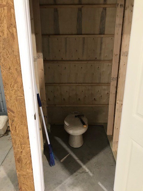

Rough in plumbing is for a potty, or just usable water and drain?
I HIGHLY recommend a potty, if you haven't planned for one! If you haven't done the septic tank yet, just stub out for one later. You'll be glad you did, if that's not already the plan.

Roughed in 4" vent and commode in one corner and ran some left over 1-1/2" PEX as a conduit to run water supply. I may never use it, but it's there.
They did pour today and it seems to have gone without a hitch.
I'm about 90% on 10' studs. We've been using a 10' 30x50 for years and it's been ok. A rolling barn door will still be 9'.
