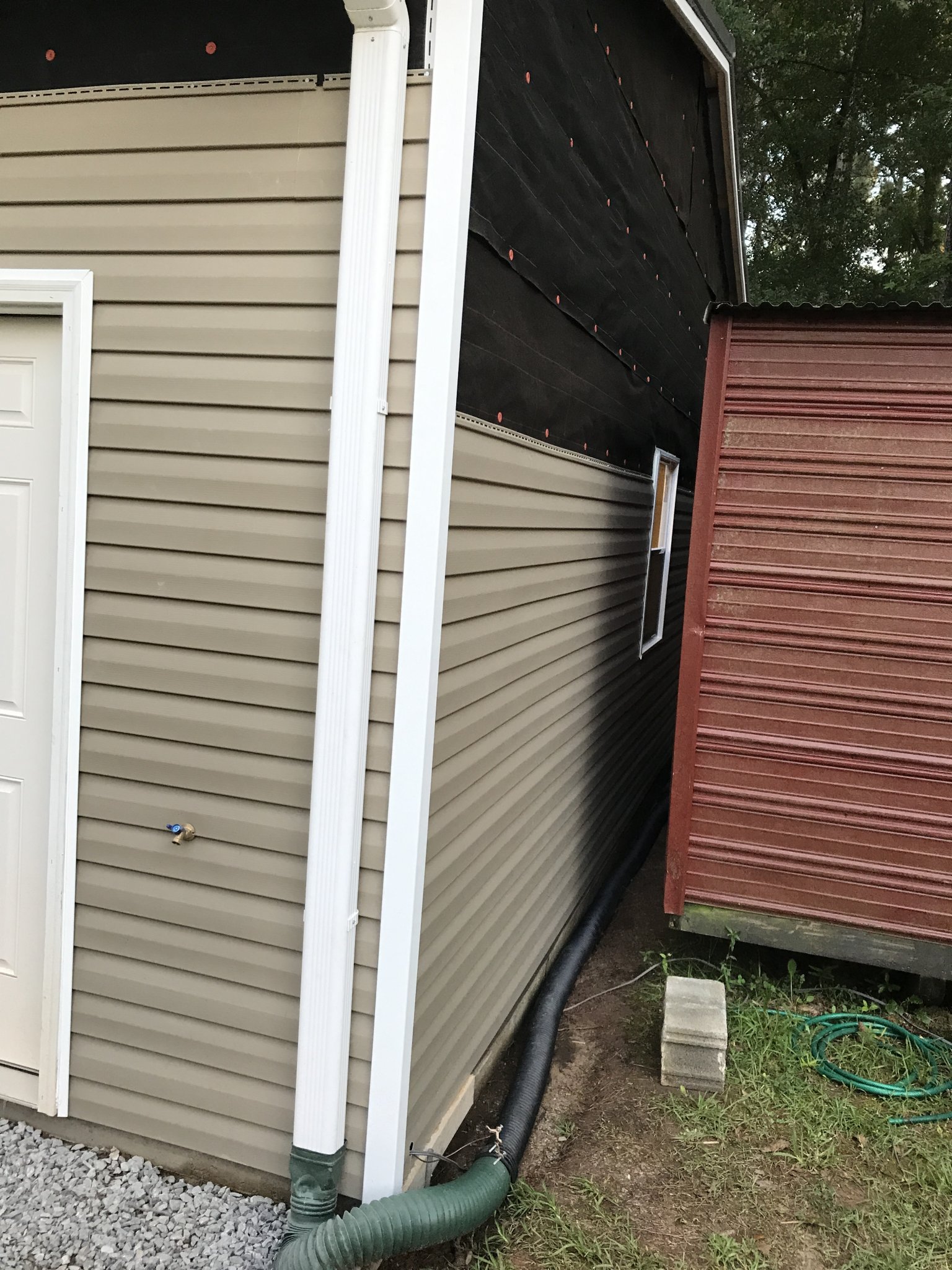

Fixed the gutter on the back side of the shed. I put a self drilling/tapping (stainless) screw in EVERY hanger through the lip of the gutter. No more separation unless something really bad happens. Got the starting strips on the east wall and j-channel around the east window. The gutter repair was a digression because of the tons of water pouring exactly where it really shouldn’t. Got some serious erosion in today’s rain and everything just keeps getting softer and muddier. Feel like I’m fighting a losing battle sometimes. I want to finish the shed, but if I don’t stop the erosion, it’s gonna slide into the ditch behind it.

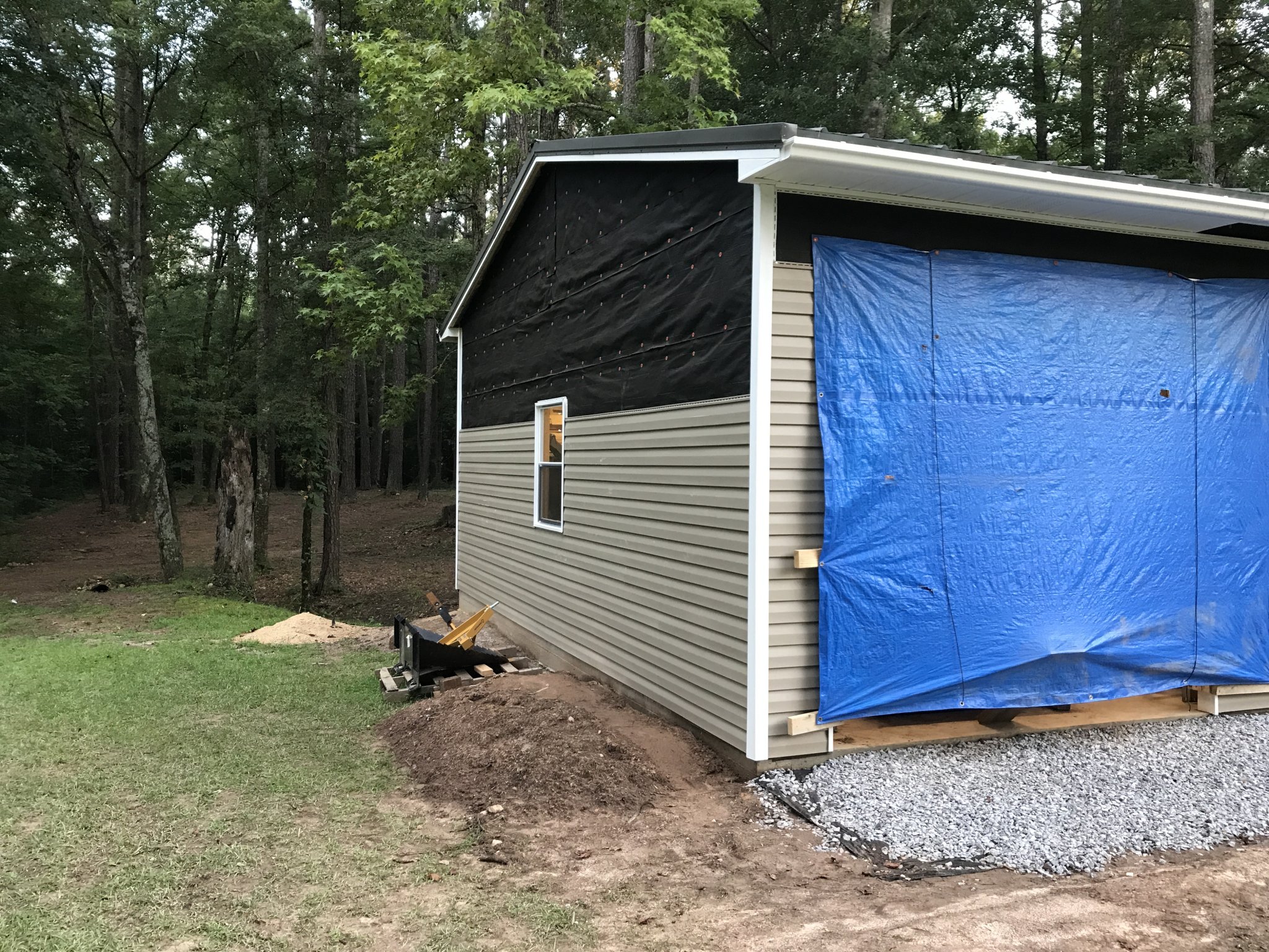

Siding going on. All corners and starting strips on, and installing panels as high as I can reach with no ladder first. Can’t do the wall sections around the doors until I get the roll up doors installed. I’ve got screws for holding the tarps across the door openings in the way. The plywood I used for the sheathing was a big mistake. The humidity has warped it so much if it weren’t for the screws holding it on the wall, it would be in another state by now. Makes for interesting stuff to put vinyl siding on the wall. Glad I put studs on 16 inch centers. I’d never get it pulled down flat enough to cover. Got rained out after we got the 3rd course on the west side. 9 courses on the short wall section to the right of the walk-in door, 8 on the west end, 7 on the back side, and 3 on the east end. Starting the first panel on the west end was sorta like wrestling a rhino, but it gets easier after the first one is done.
More noticeable progress.
6,113
3,411
Gotta ask...how were you able to get in between the old shed and new, to attach the siding? Maybe your screen name should be Old “skinny“ Paint. LOL
There's more room than appears in that camera angle, but the side of the old shed is getting pretty clean with the traffic through there. I can actually walk through there, but then again, I have to run around in the shower to get wet. The missus says I can stay dry under a clothesline in a rain storm. Seriously, when I started this project, I weighed 195. I now weigh 168. The heat/humidity has slimmed me down quite nicely. Got rid of a lotta inactivity weight from being outta commission with the shoulder surgeries. Shoulders are doing nicely, but the left still gets a little sore if I do too much reaching up, so I'm having to pace this siding install. Much easier on my old joints carrying 30 pounds less weight around, however, the dehydration at times is pretty rough on the ticker. I have to be very careful and keep plenty water in me. I keep a 3 gallon Gatorade cooler nearby with WATER in it. I'll have maybe two pints of Sports drink through the day, but the rest is good ol' High Quality H2O. I have Bradycardia (low heart rate) and if I get still a few minutes, my heart rate may drop down in the 30's, which is not good if my BP drops with it. Haven't ever passed out, but came pretty close a few times. Cardiologist waved a pacemaker in my face last time I went. Every time I go, seems my rate is dropping a bit lower. The only good part about Bradycardia is that it makes me an expert at taking grampa naps.

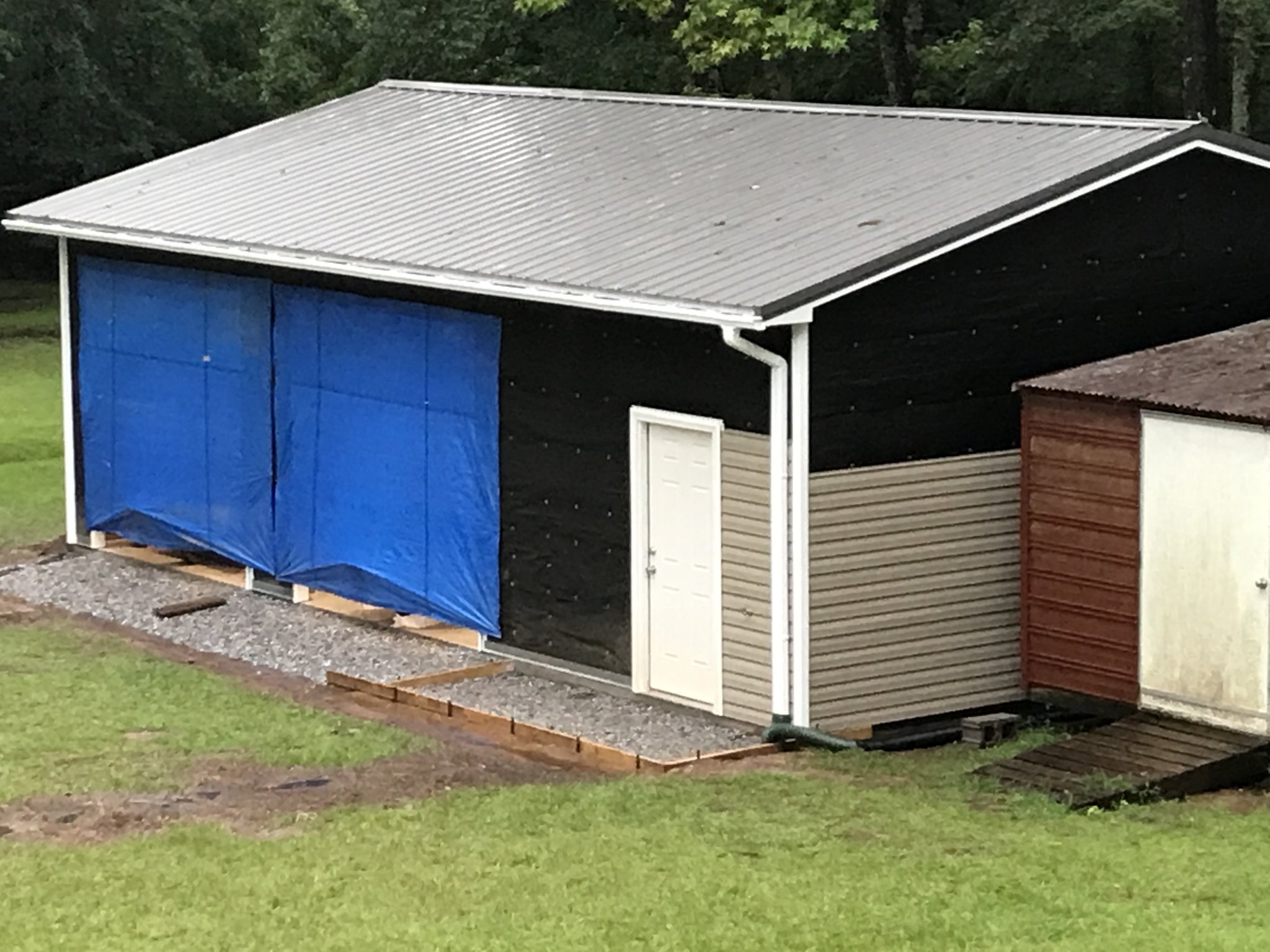

Soffit started on the front wall.
23FE9A54-52D0-4F63-BA4A-4B542910D610.jpeg E76F9269-3C79-46F4-847D-41D62E1A6ED9.jpeg
May finish the front wall tomorrow
9 courses done on both ends. Did 6 of ‘em by myself on the east wall yesterday before anyone else got outta bed
Fatman’s Squeeze aka the west wall.
Picked up pavers today for the stoop in front of the walk-in door. Gonna make that 4x12 for a little sitting area for when the weather is cooperating. Might add a lean to over it later.

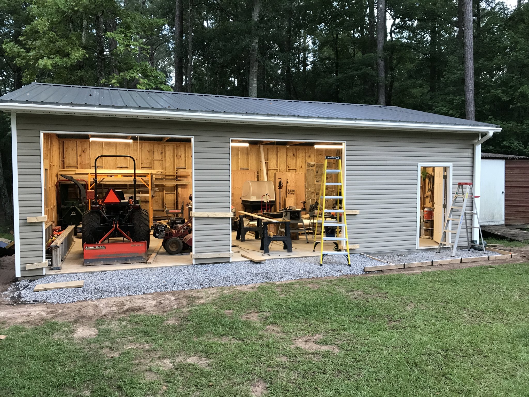

Front outside wall FINISHED!

Absolutely love it!!
Thanks for the flowers. Not too shabby for my first siding job. Learned lots and most of it was to follow my instincts. Figured out that I’m about 10 pieces short on the vinyl. Doh!
