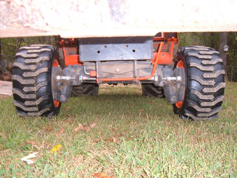

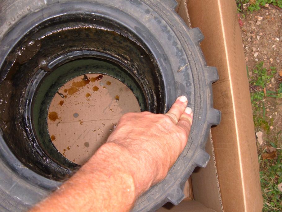

Well, budget FINALLY said I could not wait any longer for this. After 9 years, and a LOT of weather checks in the front tire sidewalls, I just could not delay any longer. Both front tires were getting slow leaks that Slime would not keep up with. (Yeah, I know, Slime is terrible stuff.) SOOOOO, the girl got some new shoes ! ! ! It was a bear to get them changed, but I wasn't in a rush to get it done.
Any thoughts about putting RV antifreeze in the 18X8.5-10 fronts? I don't like the idea of Slime, and MOST of the thorn vines have disappeared. Yeah, beet juice probably would be heavier, but nobody handles it around here. Thoughts and suggestions appreciated.
