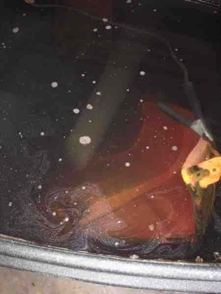

Well it hasn't been working quite as good as I expected from the pics and video. Went back and started looking at what I was missing. What I've come up with is a simple mistake :eek:
When mixing in the washing soda. Pour the soda into a container of hot water to get it to mix thoroughly :eek:
So when I get home tonight, I'll drain the tub. Mix the washing soda in hot water a little at a time and add to the barrel. Then fill the barrel and mix again. And then try. :rolleyes:

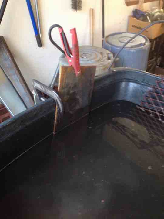

Still trying to get the tank to work like it's supposed too :D Great article. Gonna try adding some more pieces of metal to the tank and give it a tune up :D probably got the positive too far from the fender. Gonna drop a longer piece to the bottom of the tank, jumper to it with some jumper cables and see what happens :D

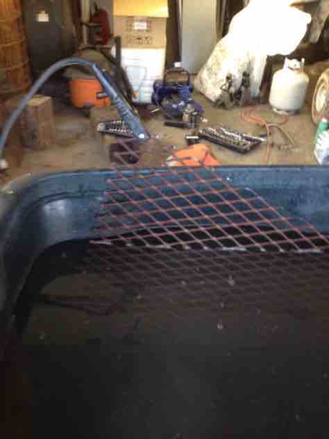

Bigger surface area needs more cathode surface area.im thinking like a rebar grid. Hope you are working in a ventilated area, gasses go boom!

Dropped in a piece of expanded metal, and a second piece of steel. Cleaned up where the positive is attaching to the pieces. And ground a spot on the fender for a good ground.
Getting 10 amps on the gauge, and the stew is really cooking now :D

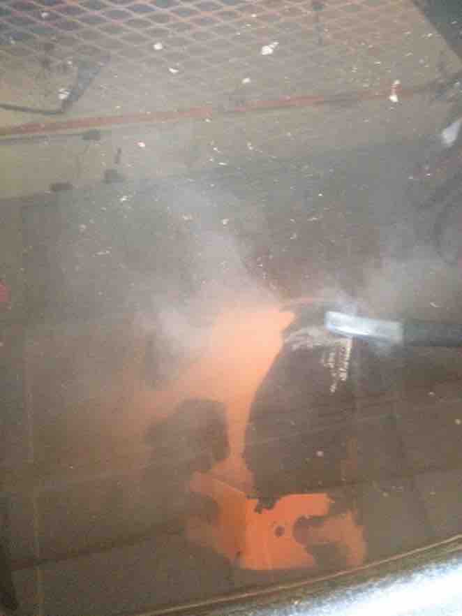

This is how it was cooking last night.
Big difference between the two!!!

I have been watching this with interest, outside of the guys in Arizona we all have some rust to deal with. I have never tried it, but have been doing some research and found one reference that electrolysis is line of sight. I would believe this to be true, ions move in a straight line between the anode and cathode. Its not like they are dissolved and in solution. The reference suggested using multiple pieces of rebar and positioning them for line of site around the work piece.
