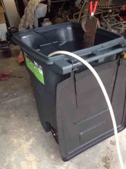

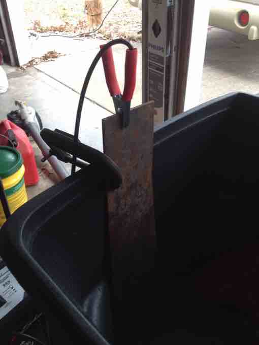

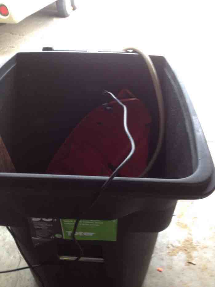

Getting it set up to try a fender. Using a 96 gallon trash tote.

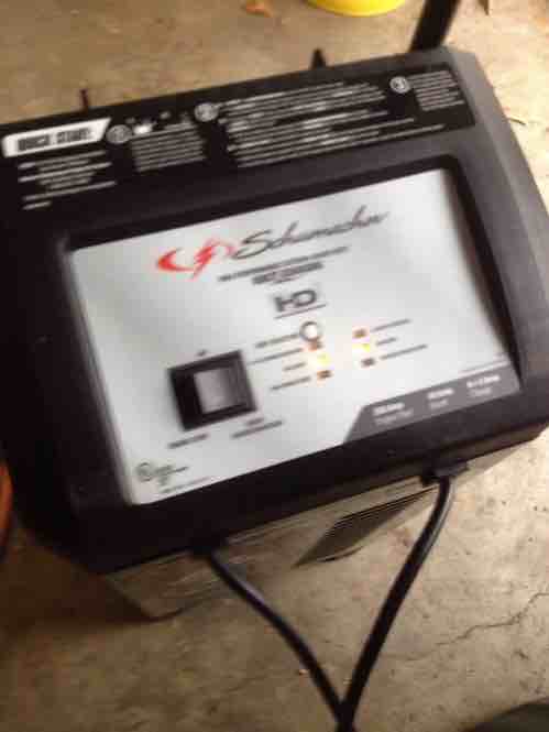

Only snag that I may run into is my battery charger.
When I purchased the charger for the house, they had changed technology. The charger is one of them new fangled "smart chargers" that's computer controlled. Probably gonna have to run into the shop and swap battery chargers :rolleyes:
Gonna try this one out before I make a trip to town.
11,063
9,118
Actually it's working :) Got her set on the 40amp setting and it's already bubbling :D thought about bumping it to the 200amp boost :eek: but figured that would be overkill :rolleyes:

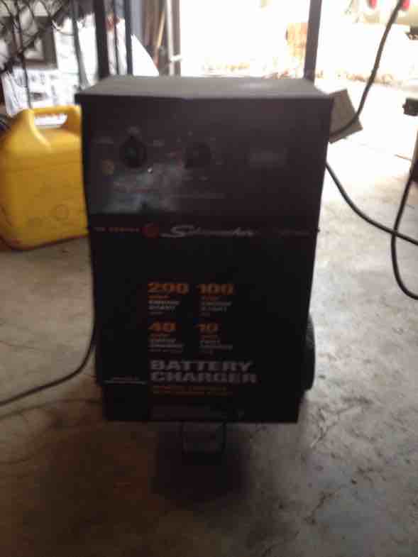

Never mind :rolleyes: just walked out to check it and it shut off :( gonna run to town and swap chargers. Don't have a spare battery I can donate to the cause.

don't get over zealous - two many of them thar amps will cook it good! the 40 amp is too much for the continuous output of the charger, that is why it shut itself off - ifn you leave it on the 2amp, 5 amp or 10 amp (whatever the low setting is)- it should stay on continuously.;):)
11,063
9,118
Actually that new fangled one has some sensors in there to where it switches to maintain, it also senses if there is a short in the battery and how much of a charge it has.
Got the charger swapped out and set on 10 amp.
The stews cooking out there :D

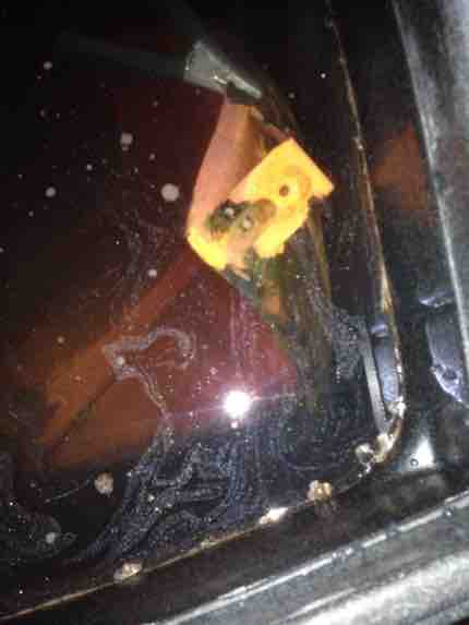

The video that 85Hokie posted is what sold me on giving it a shot. Especially if it removes the paint :D:D If it does a good job on the fenders, I'll probably pull the hood and do that in halves :D:D We should have some idea come morning ;) I did see some paint flakes floating on top of the water. But that could have been some of the stuff that was bubbled all ready. The rust had worked under the paint pretty good in spots

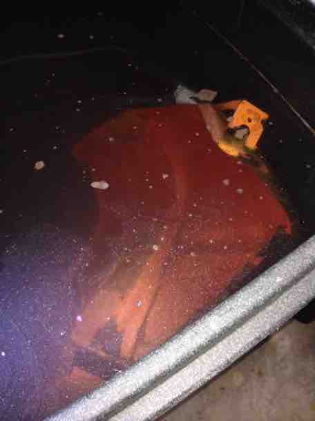

So far, not as much progress as what was in your video. But then, I have almost 10 times as much solution as well :rolleyes: Bet it's gonna work much slower :rolleyes: I am seeing some pieces of sticker, and quite a bit silver looking stuff floating around on top.

Looking good brother - how much of them "suds" you place in there? You do have a lot more water than the video - I think you will be happy tomorrow morning!
11,063
9,118
At a table spoon per gallon of water :rolleyes: The whole box :D Took six cups according to the math. 96 gallons plus or minus of water. Box was just under 6 cups.
