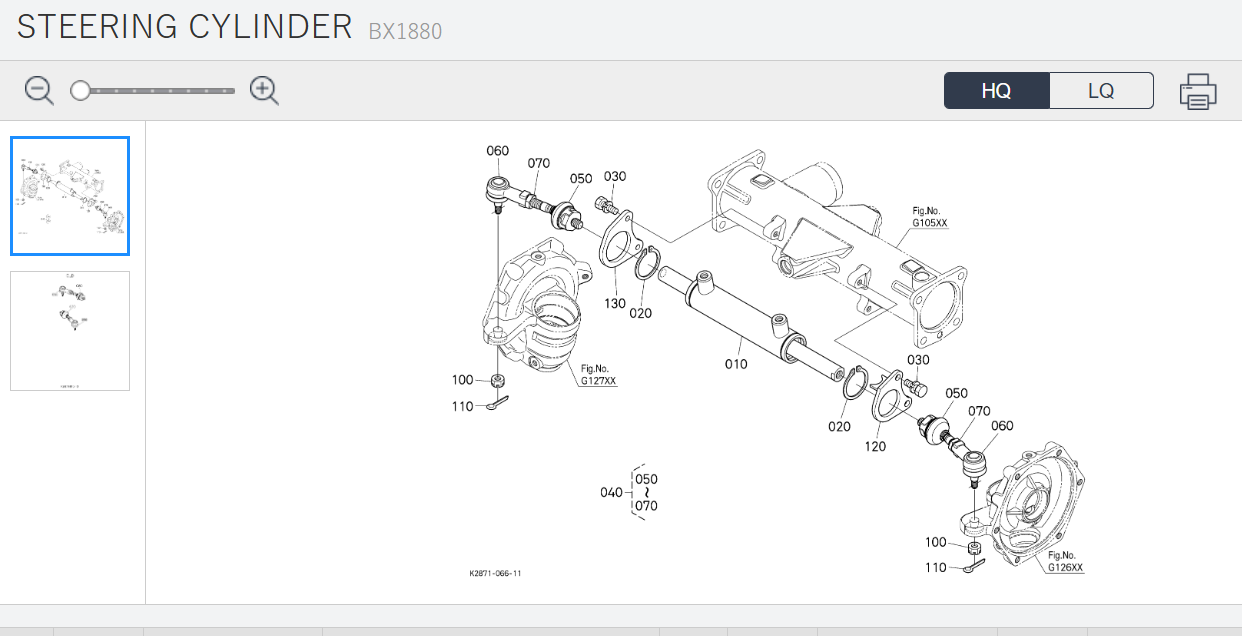

(I don't know how to open messick's illustration to paste it here)
My tractor is a BX23D MLB The part of concern for me is part #60 in this illustration where the tie rod fastens to the steering cyclinder.
I can understand the problem in the OP with tightening (or loosening) the steering cylinder rods to the tie rods. It would take a "thin" wrench for the tie rod end plus I don't have a wrench large enough to grasp the flat spots on the steering cylinder to hold it while either the nut is being tightened or the rod is turned to tighten. The largest wrench I have is a 25mm. So, one side of my steering shows several threads because it's not tight. I'd like to correct that but how? I have vise grips that I could use on the cylinder which, because of short handles, are harder to hold while trying to tighten the nut on the tie rod end. I could probably do it if I had a skinny wrench. (Nothing skinny around here...not horses, dogs or chickens. :) )Any suggestions would be greatly appreciated.

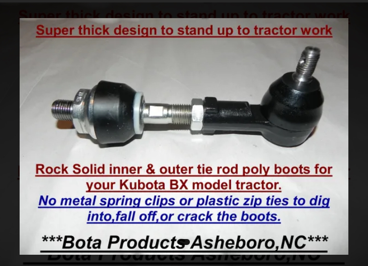

He and I designed (rather - he did 95%) of making a split boot for the axle shaft that splits much like the tie-rods do.
He did a great job - the boot slid around the axle and 6 very small nuts/bolts held it together.
Hell - he sold the entire kit - wrench, bolts, nuts the entire thing.
I emailed him a while back - said it was somewhat successful, but he kinda stopped.
Looked something like this:

OK...here's a screen grab...best I could do. I'll figure it out eventually. Part referenced above is #60

OK...here's a new diagram...learning how to do this...
BX23D steering cylinder tightening problem
