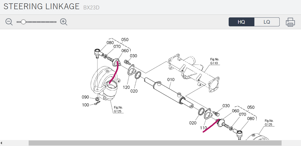

My tractor is a BX23D MLB The part of concern for me is part #60 in this illustration where the tie rod fastens to the steering cyclinder.
I can understand the problem in the OP with tightening (or loosening) the steering cylinder rods to the tie rods. It would take a "thin" wrench for the tie rod end plus I don't have a wrench large enough to grasp the flat spots on the steering cylinder to hold it while either the nut is being tightened or the rod is turned to tighten. The largest wrench I have is a 25mm. So, one side of my steering shows several threads because it's not tight. I'd like to correct that but how? I have vise grips that I could use on the cylinder which, because of short handles, are harder to hold while trying to tighten the nut on the tie rod end. I could probably do it if I had a skinny wrench. (Nothing skinny around here...not horses, dogs or chickens. :) )Any suggestions would be greatly appreciated.

The BX23D had a poorly designed set of ends, new ones have flats to grab it.
Use 2 pipe wrenches one on each side and turn, don't worry about the cylinder, it will spin.
grab it wheere the purple points not the threaded ends.

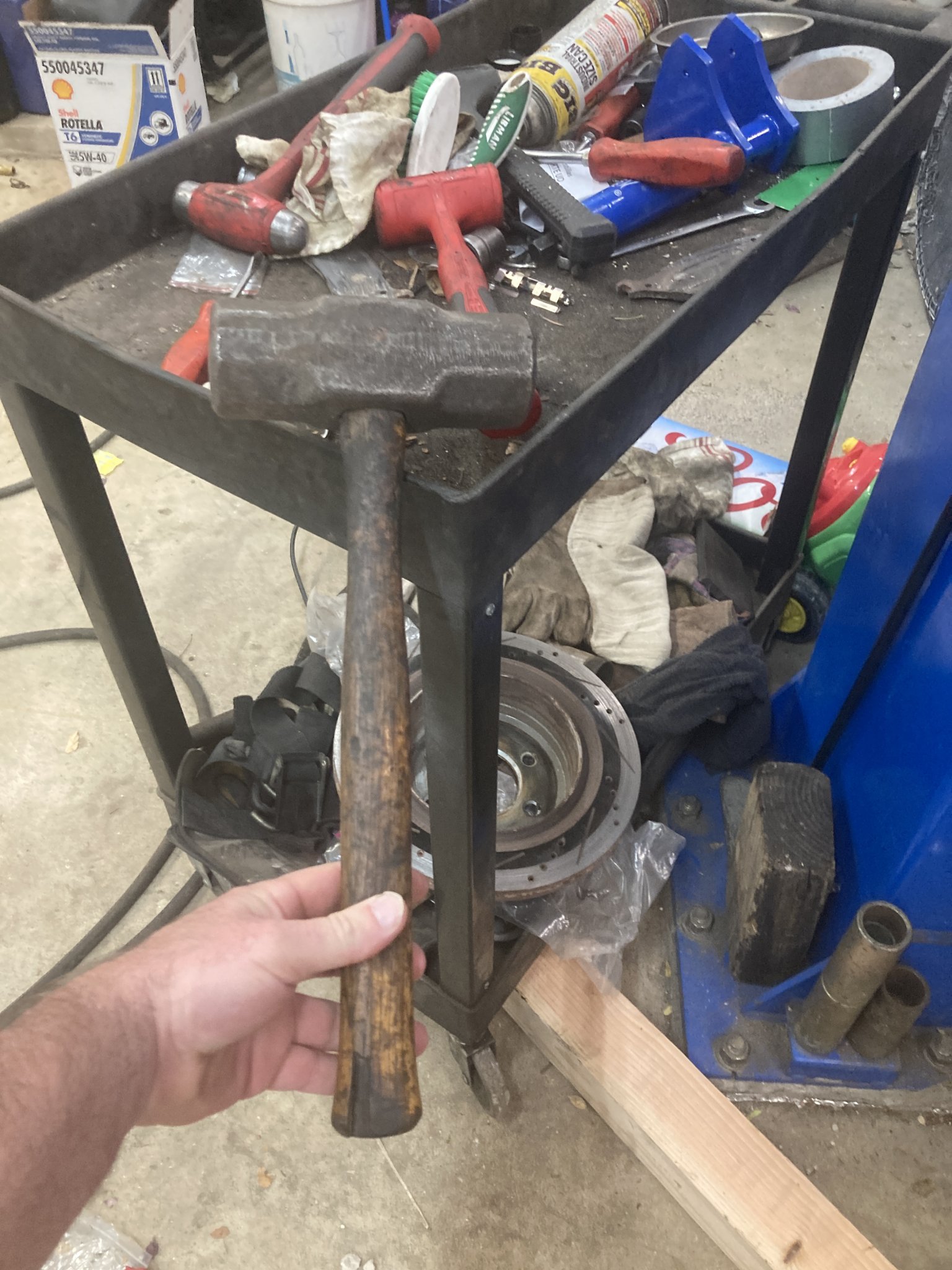

This is exactly how to do it. Smack that knuckle with a BFH and it will pop free.
I'm not a tractor expert, but I have been doing automotive/trucks for 30+ years, and I have never used a pickle fork that I can recall.
IMHO pickle forks are for .......well....giant pickles I guess? :LOL:
This homemade BFH has literally popped "thousands" of those joints apart. Its a 10lbs sledge I mounted on a hammer handle decades ago.......
BUT if you F'ing miss......your going to be visiting the ER with a crushed/split wide open finger/thumb.....Ask me how I know..... 🍻
I believe a picture will help explain. Everything is assembled on the tractor. The issue is that the cylinder rod is not fully screwed in to the part where you have drawn the purple line. If I turn part #60, you're right...the cylinder rod turns, too. I need the cylinder to be screwed into part #60 all the way.

While I don't fully understand the situation, and I will go through it in the spring, when I change my steering cylinder on my BX, I get the impression the OP's question has nothing to do with the steering cylinder, and everything to do with the ball ends that point down 90 degrees from the cylinder rod axis.
Maybe the thread has taken a turn that I missed?

That why you need 2 pipe wrenches one on each part (60) at the same time and that will tighten the one that is not bottomed out into the cylinder.

Think of trying to screw two couplings onto a pipe nipple. You can start both on by hand but eventually you need to get it tighter with two pipe wrenches (or channel lock pliers). If you hold the pipe you will tighten one coupling. But if you put both tools on the couplings and turn both tools one coupling will tighten up until it is as tight as the other one (rotates both the tight coupling and pipe will rotate together). Eventually you will be tightening the loose coupling and eventually both couplings get tight onto the nipple.
Just use both threaded parts as the object to have the wrench on and let the tube turn when it wants to. Eventually a shoulder will contract the tube (on the tight side) and then that side will stop the tube from turning and the other loose side will start to get tight into the tube.

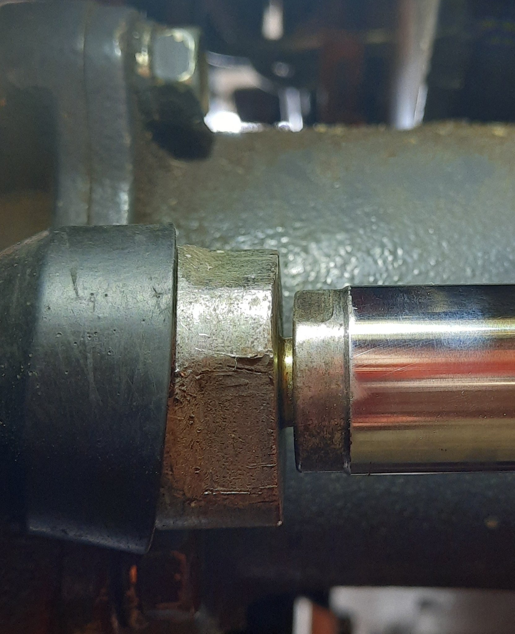

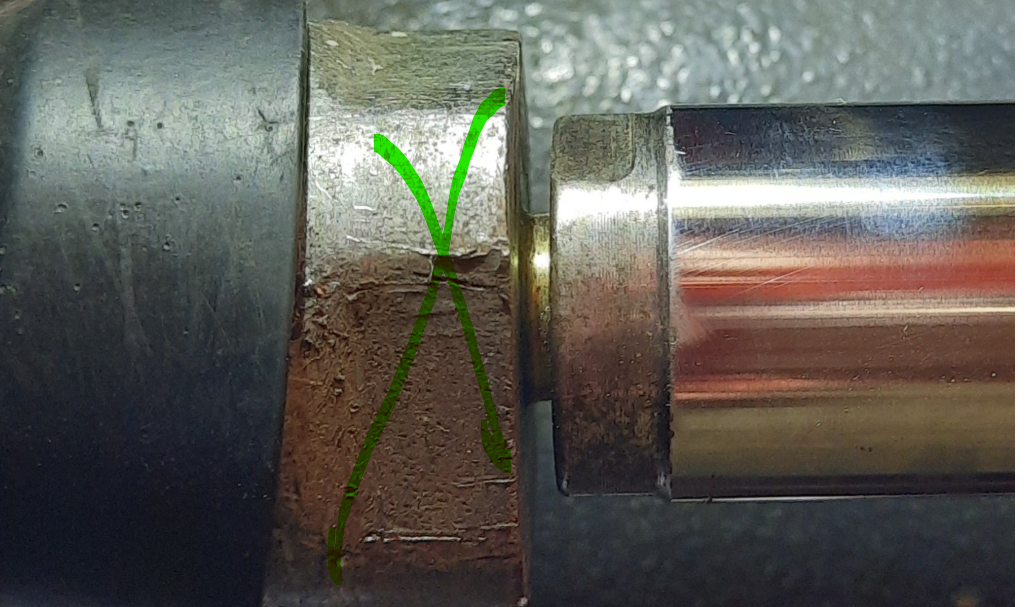

I understand the use of 2 pipe wrenches but it would seem that a pipe wrench would gouge into the steering cylinder rod. Here's a picture of the problem with the "flats" visible but, again, a wrench is too thick to fit on the flat on the cylinder rod. The other flat would easily work with a pipe wrench.

I think the Wolfman may have been talking about using two pipe wrenches when removing part 80 from part 60… but I’ll let somebody that knows give a definitive answer.
TG
I was thinking @North Idaho Wolfman meant to hold the outer case but I now see the problem more clearly.
I would get a good rubber strap wrench and see if that works to hold the ram to tighter up the #60.
example
You might want to take the part completely out and measure the length and hole depth to make sure it will screw down to the shoulder. I don’t know that it matters that it is tight to the shoulder or not.
TG
Put one pipe wrench on this part and the other pipe wrench on the same part on the the other side and turn them the opposite directions.
This will tighten it right up without touching the cylinder.

I.... have a few quality but cheap wrenches that I use for dealing with lock nuts and things like this. I simply took the wrenches to a grinder and made them a little thinner to fit. 12, 13, 14, 15, 16,17mm Old SK tools.
I have bicycle cone wrenches as well but they are extremely thin. Good steel, but not good enough for this job. Though if I had several of the correct size, they could be stacked to make a 'laminated' wrench.
