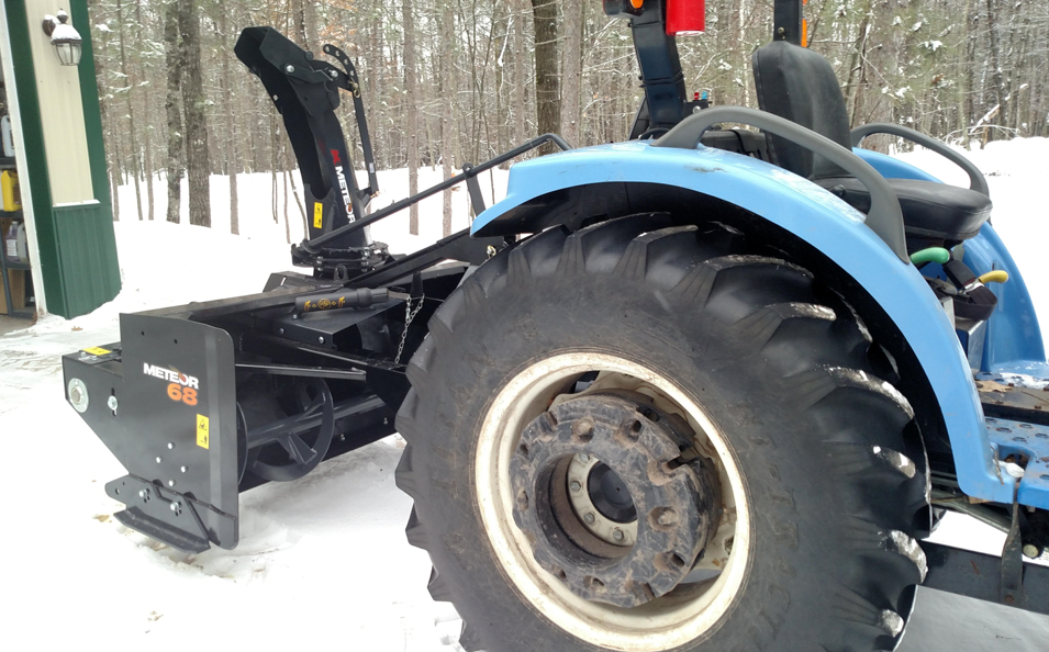

I have owned a Meteor traditional 3pt snowblower and now have a Meteor Rear Pull Snowblower. I love, love, love the rear pull.
