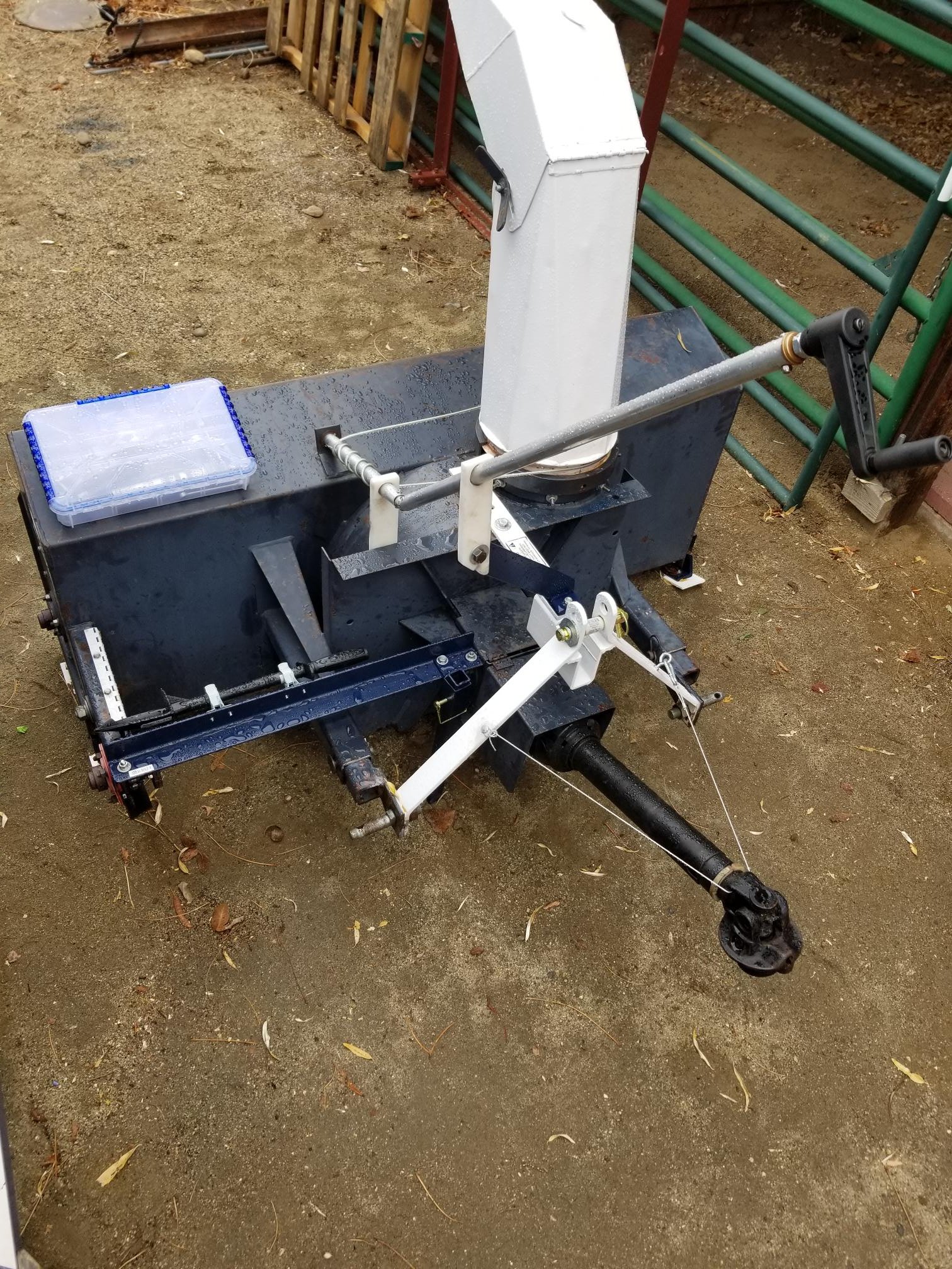

I found & bought a used Buhler/Farm King/Allied 60" snow blower. Chute, manual chute rotation crank & cable assemblies all in poor condition, looked like it was used it to catapult rocks. But the key issue was all the drive components & bearings were tight, in good condition, with no excessive wear or play.
The unit also has four different 3-point frame adjustment length positions, secured by pins on each lower arm. The previous owner had moved the lower arms out about 8" past the longest pin hole location & tack welded the arms! Probably did this due to the PTO shaft being too long.
I ground off the welds and used the closest/shortest mounting location to my 2501. I reworked & lengthened the chute rotation handle, included a Ujoint so I easily can reach it without getting off the tractor. Also added plastic runners to skid shoes, a waterproof tool box for grease gun, shear bolts & wrenches. Chute got repainted & lined with UHMW sheeting.
The Sierra's are supposed to get slammed this week...so I'll soon find out about this stout Canadian-built snow-blower!

Forgot to mention modified the top link attachment to be QH compatible...
