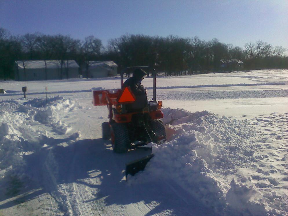

I personally have my rear blade installed backwards, as Vic reccomends. This is still very effective, and does not cut into my gravel driveway as much. I use the loader, but only when I have to stack very high, or lots of snow. I have my toplink adjusted so that the rear blade points slightly up when raised. I can push the deep snow in reverse and stack it up to about 3-4 ft in one pass.
I would suggest for your situation, to use the rear blade pointing backwards, and angled in the same direction as the front blade. You can then have your front shoes set much higher, and use the rear blade to cleanup, and if there is a situation where it is easier to backup than to push.
Even If you cant use both at the same time, it still would be setup for a very versitile setup.

It looks like having the blade turned to the rear would be great. Make a pass with the loader and the another going backwards. Making 2 passes in one will be a lot less time in the cold.
