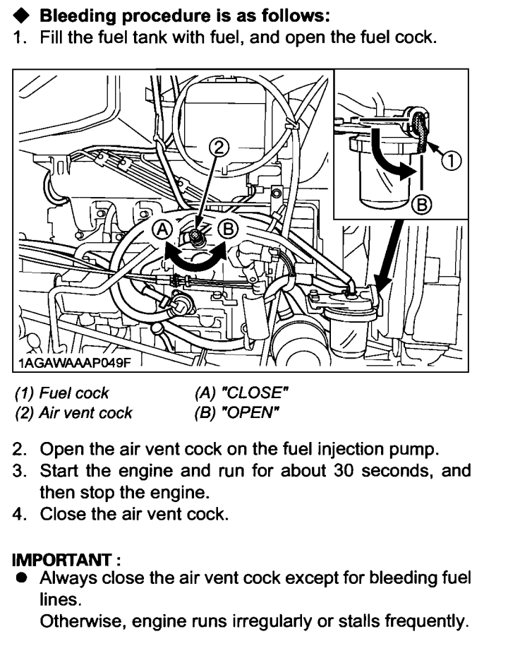

That model is semi self purging.
On the side of the injection pump is a valve to purge it.
Remember to close the valve after your done!
Open the valve and then crank the engine, it should push all the air out of the lines, and start.
if that does not do it, then you might have to crack all the lines at the top of the injectors and bleed them there too while cranking.
Unfortunately as I have already tried to to open the valve, and to bleed the injectors already, but can't get it to start.

May not be water (or bad fuel); could be some trash blocking the injectors. (And it could be a LOT of air, which can be difficult to purge.) If you haven't already done so, find the valve that NIW mentioned (Service Dept Vic points it out in the vid that Mike9 posted) and open it, then crank until it fires, then close the valve.
