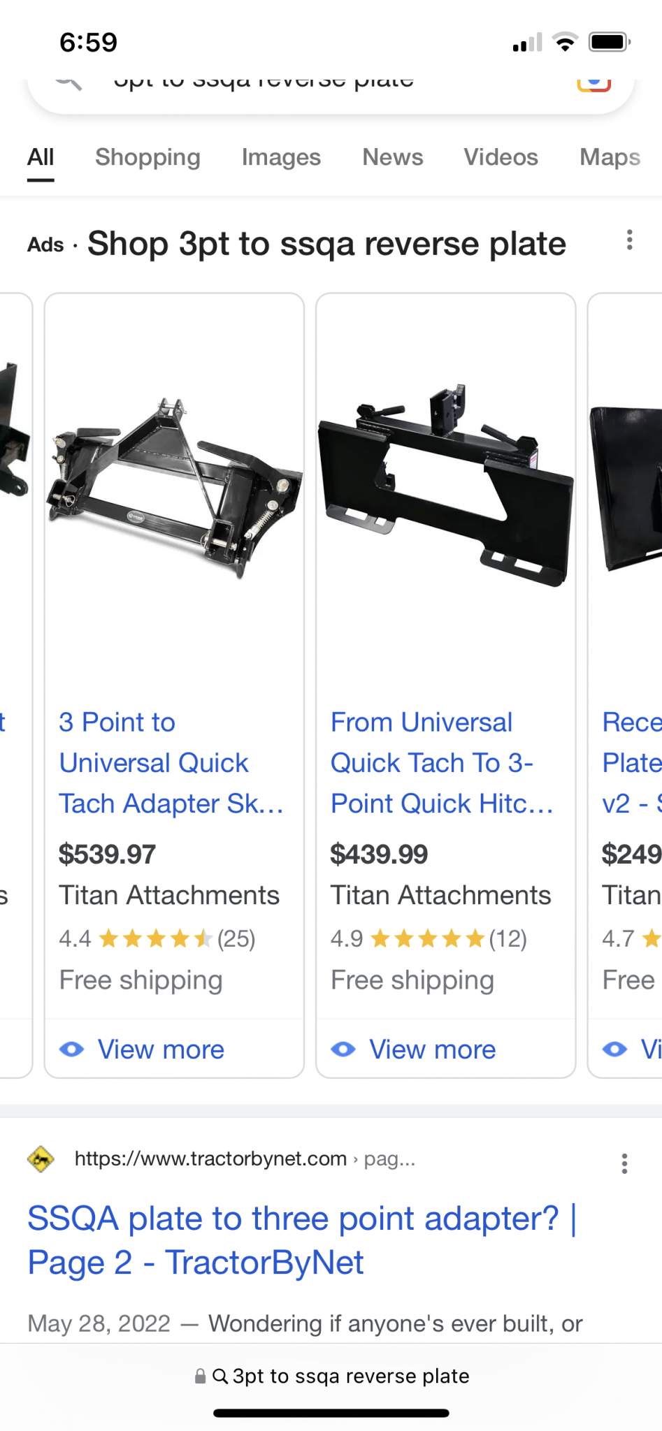

I do have front forks already. Is a reverse plate something I would need to fab up or can be purchased and attached to existing forks? I don't have access to a welder.
They are just a few clicks away…I thinking if you search 3pt to SSQA adapter plate or reverse plate you will find what you are looking for.

If you already have SSQA, then you can buy a plate that basically lets you attach SSQA things to your 3ph. Something like this: https://www.amazon.com/3-Point-Attachment-Universal-Quick-Attach-Equipment/dp/B008HS6KMO
Thank you. I was thinking of trying something like this in the meantime.

Cheap and easy. Having two sets of forks rather than one that fits both ends means you can use both at the same time. However, those ones don't fold up, and don't adjust width. Those things are valuable to me. Depends what your storage space is like, and whether you might lift different sorts of loads with them.
