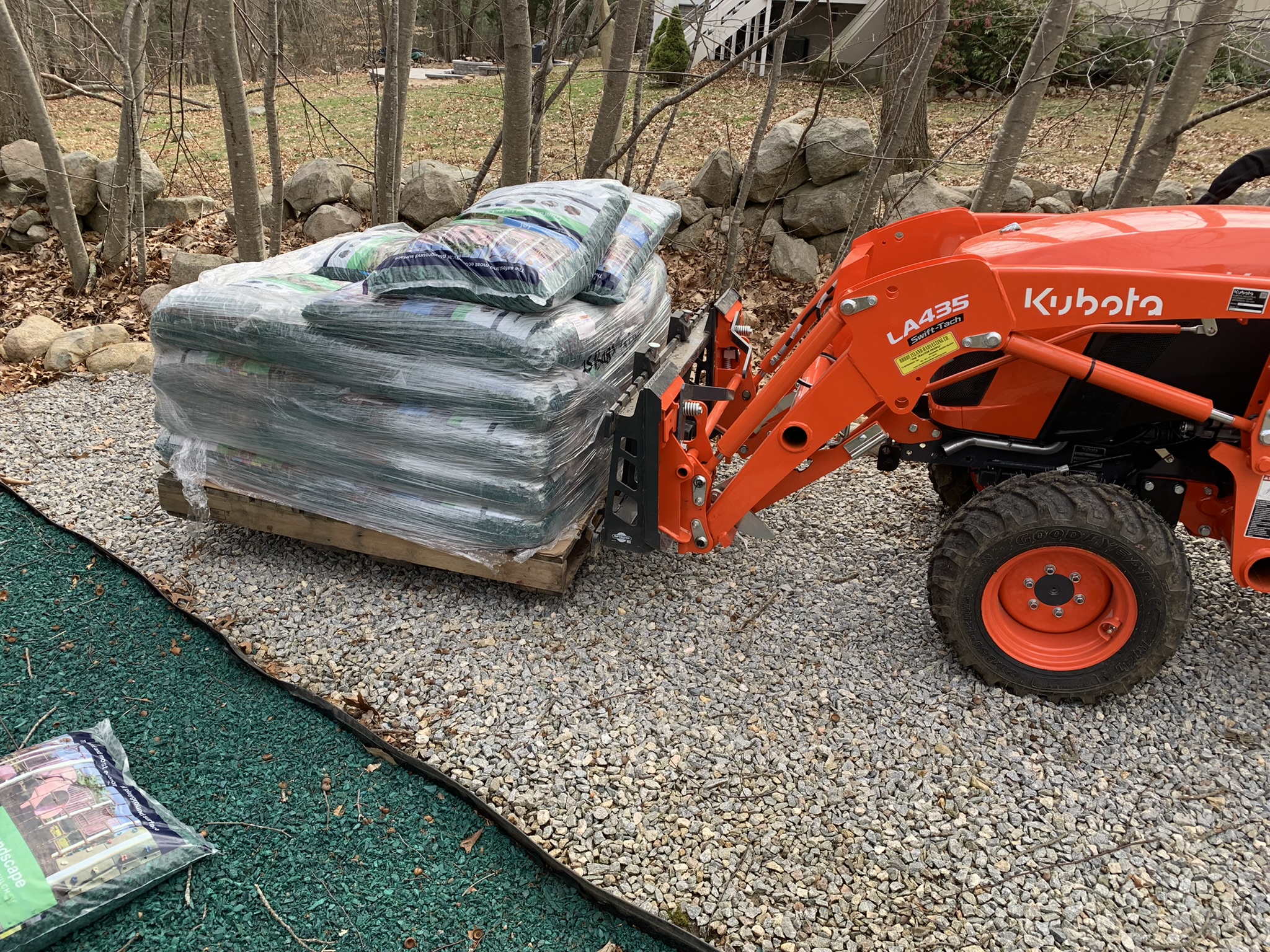

I have a B2601 with R14 tires. I have had that thing maxed out. I had a pallet with 960 lbs (plus 200 lb forks) on it of rubber mulch for my kids playset, so lots of weight far out, and a couple inches off the ground. The tires didn’t care. The turf tires are really squishy. Try the R14s if that’s your only concern. They do fine on grass, but provide a stiffer sidewall and better traction in dirt.
I was moving some large rocks a couple weeks ago. The loader was completely maxed out. Had to curl and do all sorts of tricks to get the loader up enough off the ground to move safely. Again, tires barely had an squat in them.
Unless you’re just looking for a reason to upgrade. If that’s the case, I agree with the others, go for the MX. Stuff like that is how I convinced my wife to let me sell my BX and get the B.
