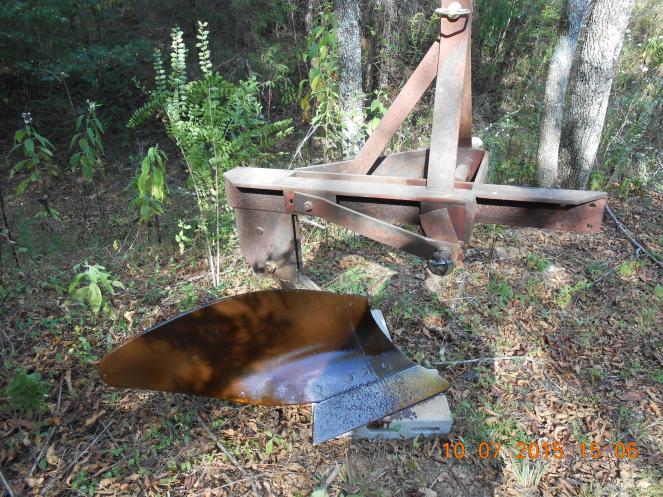

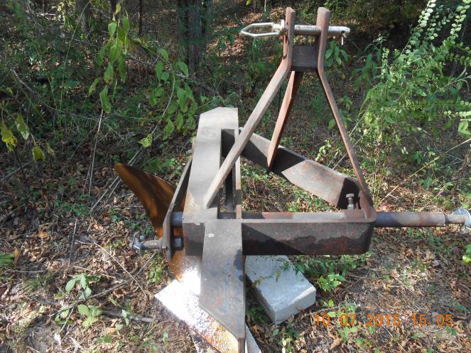

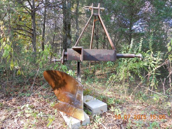

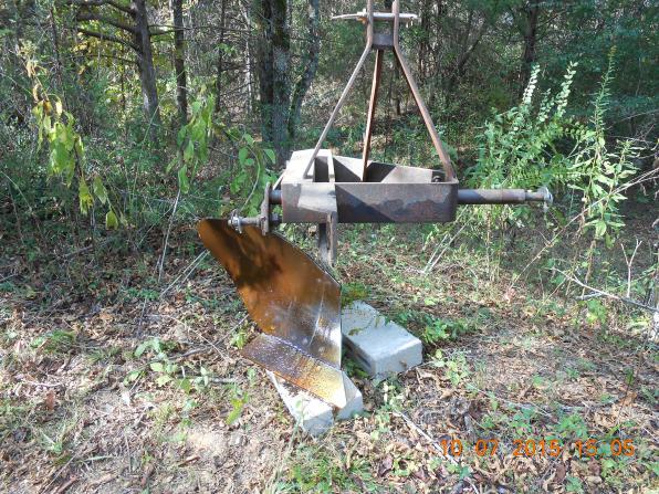

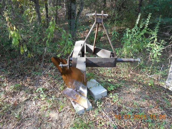

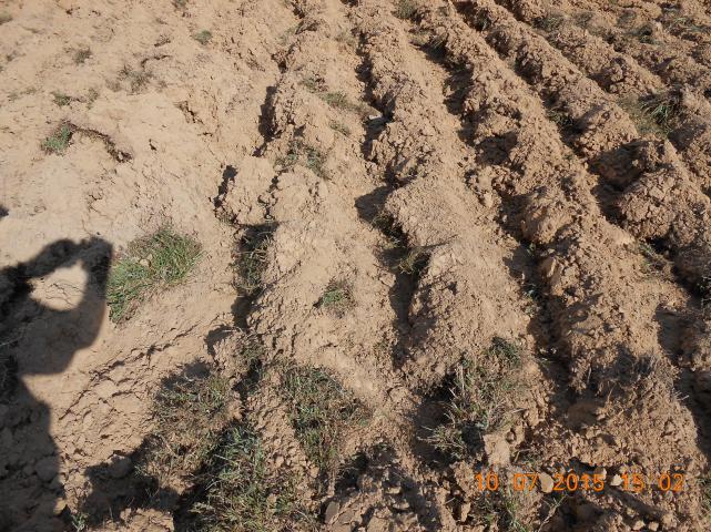

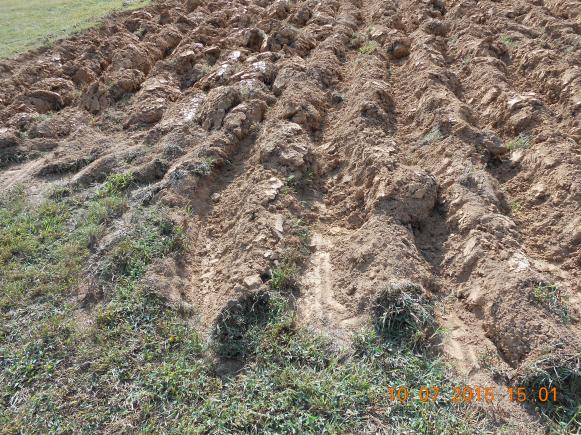

No matter how I adjust this plow it wont cut out, over, to the row that I just plowed before. Forgive me for not using the correct terminology but it leaves a gap between rows. Ive plowed before several years ago and remember correcting this problem but dont remember exactly how. Besides it was a different tractor and different plow.

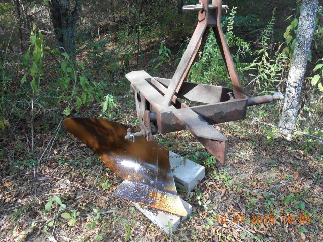

I have the adjustment bar all the way over as you should be able to see in the pictures. After making some adjustments on the tractors right lift arm and top link then it started plowing pretty darn good except the problem Im having. I took pictures of the worst plowing so you could see some of the bad gaps. I have Hodges stabilizers on so I do think that helps.
Im also staying to the far right side of the furrow to cut over to the last cut as much as I can. Yes I didnt think to take pictures with the plow attached. So let me know if there are any other pictures you need or questions. Thanks
Warped plow ? It looks pretty straight.
Maybe its more out of wack than I think.

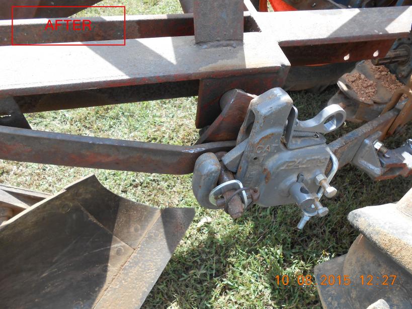

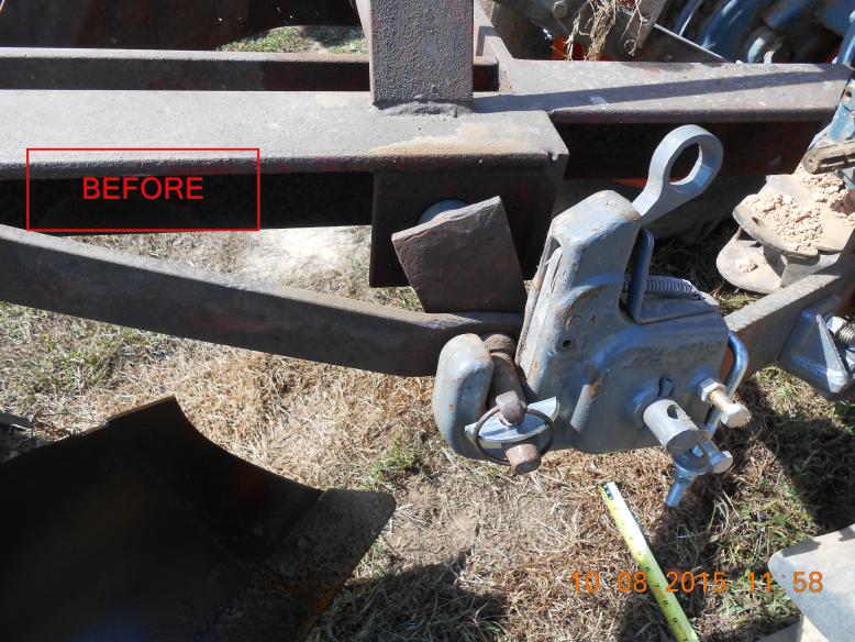

I did have a thought about trying to change the drawbar position. Im going to try one last thing that should be able to be seen in the very last picture. Im thinking of turning/swinging that drawbar pin toward the front or rear or which ever direction Im needing that should swing the back in the direction Im needing. You can also see in that last picture to the left side where I moved the stabilizer bar to a different position and there are more holes there to try so I must try.

Maybe I'm off, but looking at all the pictures, it looks to me like it's not going deep enough, hence it's not pulling over enough dirt to throw it over far enough to cover the gap. :confused:
If your only hitting half the moldboard it will do that.
It get more depth you will need to do some adjustments, might be able to just move the connecting links up the arms towards the tractor if you have multiple connection points, also pointing the tip of the plow slightly downward will help keep it from floating and keep it at the proper depth.

I was able to twist the drawbar pin and I also got a little more movement from my Hodges stabilizers and together that fixed it. I took a picture of the results but after I fine tuned it got even better.
Standard R1 tires, 16" plow, pretty dry, thanks for the link and all the other great help.
I cant believe the adjustment was that simple. Drove me crazy. Especially since I could swear I had it in that same position the first time I tried the plow.
