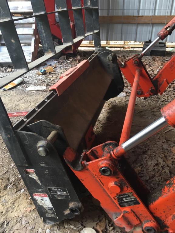

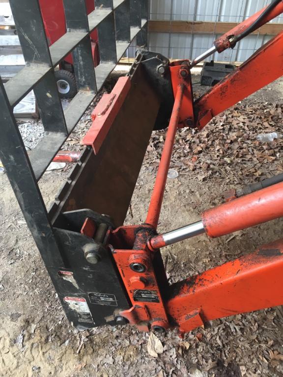

This is exactly like the Kubota style I bought for mine. I prefer them to a SSQA because it has no moving parts to break. I paid about $300 from my dealer. I leave a set of top pins in my stuff so I don't have to change them every time I switch it out.
