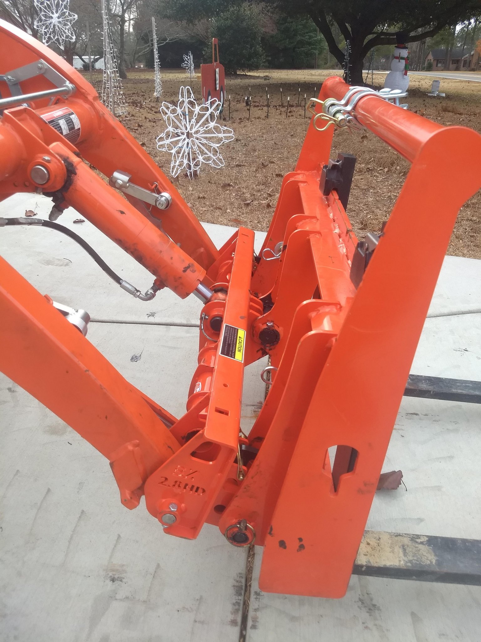

? what keeps the forks from rolling off,when you tilt the loader fwd ?
or the other way...
what keeps the forks locked on or secured to the loader ?

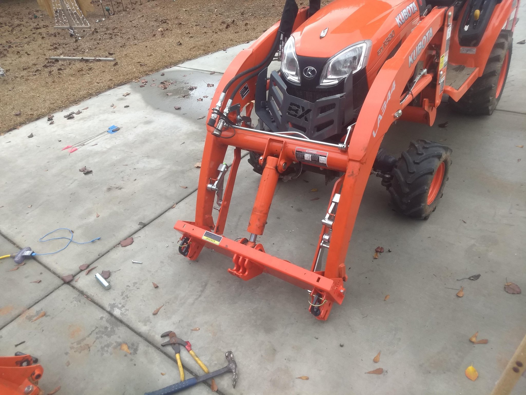

When the lower pin is installed…the Kubota-style is fully locked-together..same as with a full pin-on attachment.
The guy who made mine is Dan Heibert: danannah (at) gmail.com
ph: 20four-362-798four (Manitoba)
Since my tractor came with a FEL and Bucket already Pin-On style… this adaptor saved me having to modify BOTH the FEL and Bucket and Pallet-Forks to SSQA…saving me weight and money.
Frankly, after two-plus years of experience with it….this was the simplest solution to a QA system imaginable.… No moving parts…No way for a lever to become dis-engaged during operations…No significant additional weight added to the loader… and it will just as easily hook up with TractorMikes’ pin-on SSQA with no modifications required to use SSAQ attachments also.
SSQA is probably the standard for new equipment in the future but if you’re acquiring a used machine with a pin on FEL ….I”d think twice before automatically modifying the FEL and all my attachments to SSQA when such a simple solution exists as the Kubota style QA so inexpensively and can keep using attachments you might already have.

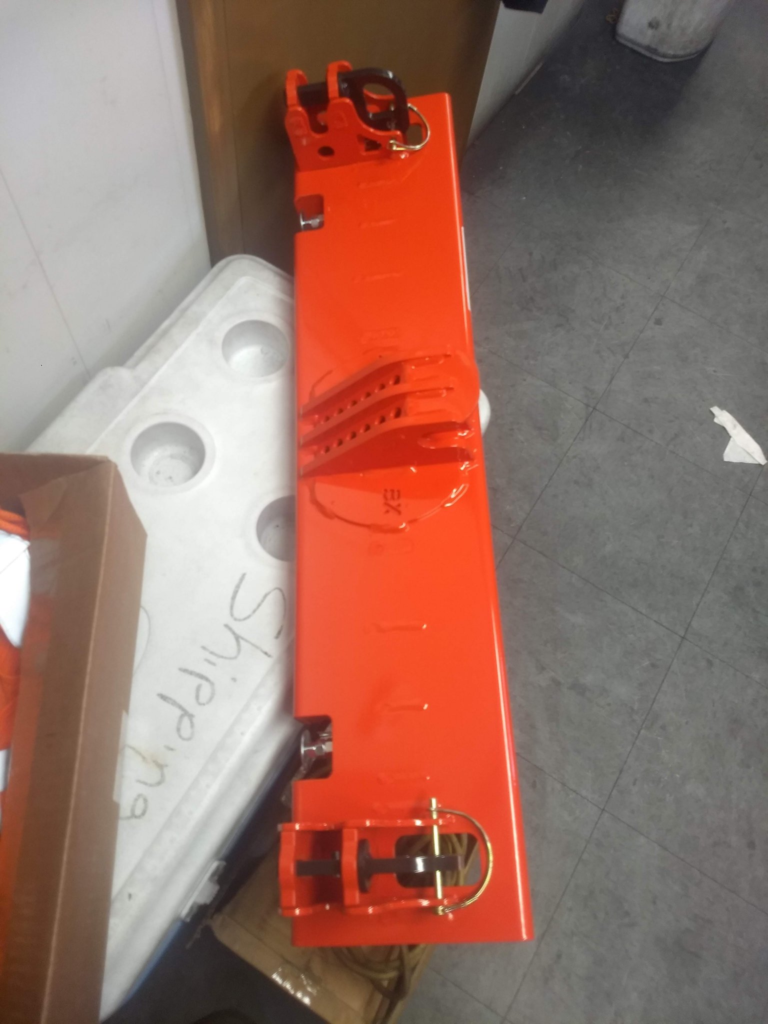

This is the AI2 quick attach. It's similar to the old Kubota style. I recently purchased mine for $600 shipped. It's lighter than ssqa, keeps the load closer to the pins than ssqa, and very easy to install.
I've seen the argument that it's less desirable than ssqa because it's "proprietary", but it's no more proprietary than the pin on loader. It works with existing pin on BX implements. Many, if not most, ssqa implements that weren't designed specifically for a BX are too large and/or heavy for a BX. Everyone who makes an SSQA attachment specifically for a BX also makes it in a pin on version.
I plan to use it for bucket, grapple, and forks. Each of which are readily available as pin on, so I'm good to go. Tony at AI2 also sells a blank plate that works with his QA to allow a DIY fabricator to make or modify just about anything he or she wants to work with the quick attach.
