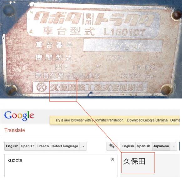

Eric I was kind of wondering about those stickers being in English also. It has a lot of Japanese writing on it also as well as the metal Id tags anyone know what the PS 15 means on the tag.
The rear tires also say for Japan only.

ps is the symbol for pferdestärke, which is German for horsepower. The symbol ps is used in both the German and Japanese markets.
pferdestarke is the same as metric horsepower, or I should say ps is the symbol for metric horsepower.

It's 100% Kubota, every nut bolt and washer.
It's 100% gray market and not a North American model.
It's 100% awesome!
Get going on rebuilding that top end chances are pretty good that the head was cracked due to overheating.
Re-badge as an L-185DT-the tire size, two extra PTO speeds and the fact that signal lights and horn were standard on the L-1501 and optional on the L-185 are the only differences.
