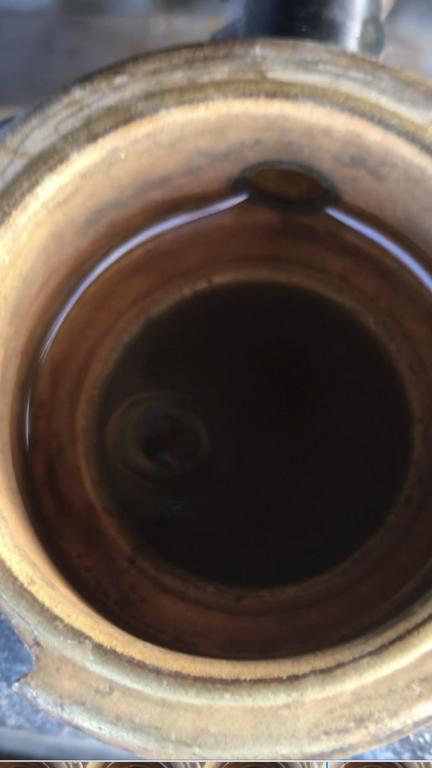

So I definitely see bubbles. I cranked with cap off and thermostat out. After about 10 minutes of idle in mid 70s temperature the gauge was barely off Cold. Bumped it up to PTO speed and definitely have bubbles. I tried to attach video but couldn’t so I attached a screenshot. After about 67 minutes at PTO speed gauge was a little under half temp. Looked at my videos and counted 15-20 bubbles in a 11 second video so I guess it confirms gasket or cracked head or block.
Little good news, on a kubota it's almost never the block (like super rare) and almost always the cylinder head (way too common) or head gasket.
