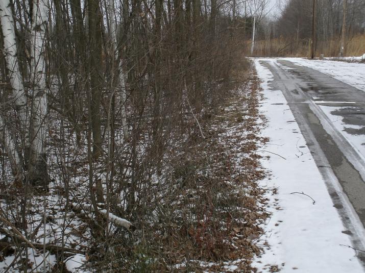

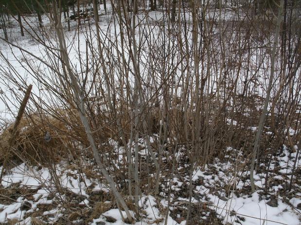

The pictures show what I'm try to cut. I was looking at a flail ditch mower but I'm not sure my tractor has the HP at the PTO (23) to power a 48" one. Looked at some brush hogs, but I'm not confident that will do a good enough job on the small trees. Opinions? The biggest diameter brush would be 1-1/2" diameter.

If there is nothing bigger than that - your 48" hog will cut all of that. I had a 5' hog behind a ford, it would run over things 2,3" ......it would make a hellva noise and spit out splinters of stuff, and some stuff would come back at the operator but the hog would cut it! Not sure the flail would be good for stuff like that.
The real problem is getting OVER top of that stuff - that will be the royal PITA. Someone gonna need a sickle or a chainsaw first!

What they said; no problem.

Rather than drive over it, you could back into the brush and cut it down. That's what I do on larger diameter brush.

As mentioned you'll probably want to back over that. Individual trees won't be that bad to drive over but when they're that thick it can be tough. You don't want to get half way on top of trees and stop. BTDT. Backing up then can cause more damage under the tractor than had you been successful driving over them.

I'd use the bush hog and cut it real high first...going dead slow. Then come back for additional passes as needed....really slow.
Also....that road there....you gonna be slinging stuff all over. Could damage a new Caddy easily as it goes by....need to figger out how to avoid that....also again...don't let any people close by as you cut.:D

One problem I see is that if you cut those off you could puncture tires with the stubs left sticking up. Not sure that you can mow them low enough with a brush hog

Yooper, I had a similar project two summers back. Had about 600ft of brush, most less then 2" dia, but a couple 3-5" and all 8-12' tall.
I did it the hard way. Took a gas powered straight shaft weed eater with a circular blade I had welded the biggest/longest chain saw tooth chain around the entire diameter. I went through and cut all the brush about 3-4" off the ground and had the helper pull and stack perpendicular to the fence.
Then when all was cut, I came back with the same tool and cut the stubs off at ground level and immediately sprayed the cuts with Tordon.
Took my L305 with the REAL :)D) toothbar pointed down and a few inches off the ground and raked the entire cutting into one nice huge burn pile.
It totally cleared the fence line and no stubs to trip on, or bust tires!

The Caroni flail can be hooked up with an offset to one side and does come with brush blades if you want. I mowed down a big wild rosebush patch with mine a few feet at a time to avoid driving over stuff that would hang up the underneath of the tractor.
