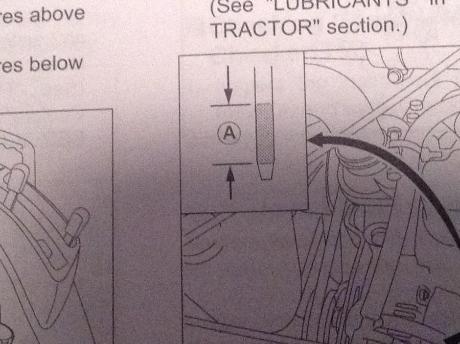

Here is my manual oil stick reference.
And as Kurtee stated it may be unburnt fuel.
Try a sample on paper and a sample from dip stick and try to compare it.
And as he said you may need to open it up.
