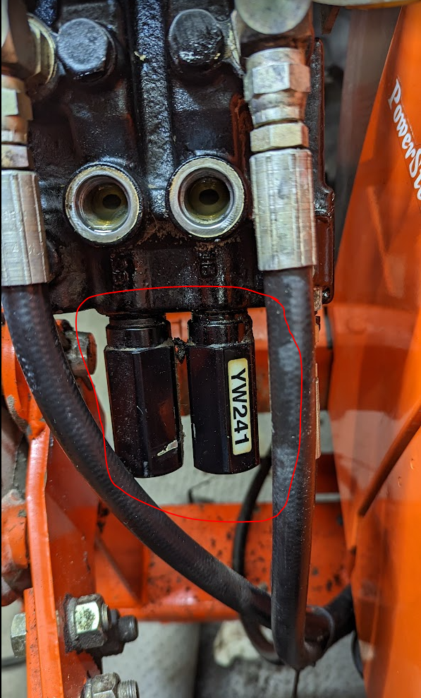

Hey guys, I just recently purchased a 2005 B7610. First tractor, so all of this is new to me. Wondering if anyone can give me some comment, advise, issues or things to look out for regarding this tractor. Planning to use it on my hunt land and also side biz of bush hogging. Just purchased a Betstco flail mower and looking for a 5ft BH. It has a small Hydraulic leak that Im working on, looks simple enough but while working on it I notice the two cylinders on the bottom of the Hyd manifold (not sure of exact name) can someone tell me what these are for? Are they accumulators? Regarding the bucket, is there a way to upgrade the current bucket to a quick detachable one? Any kits out there worth buying? Anyone recommend getting the fluid in the tires? Is this a DIY thing? Im sure I will have other dumb questions later. :)

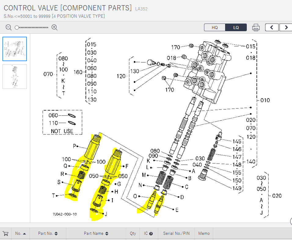

Those CAPS are detent caps / covers.
