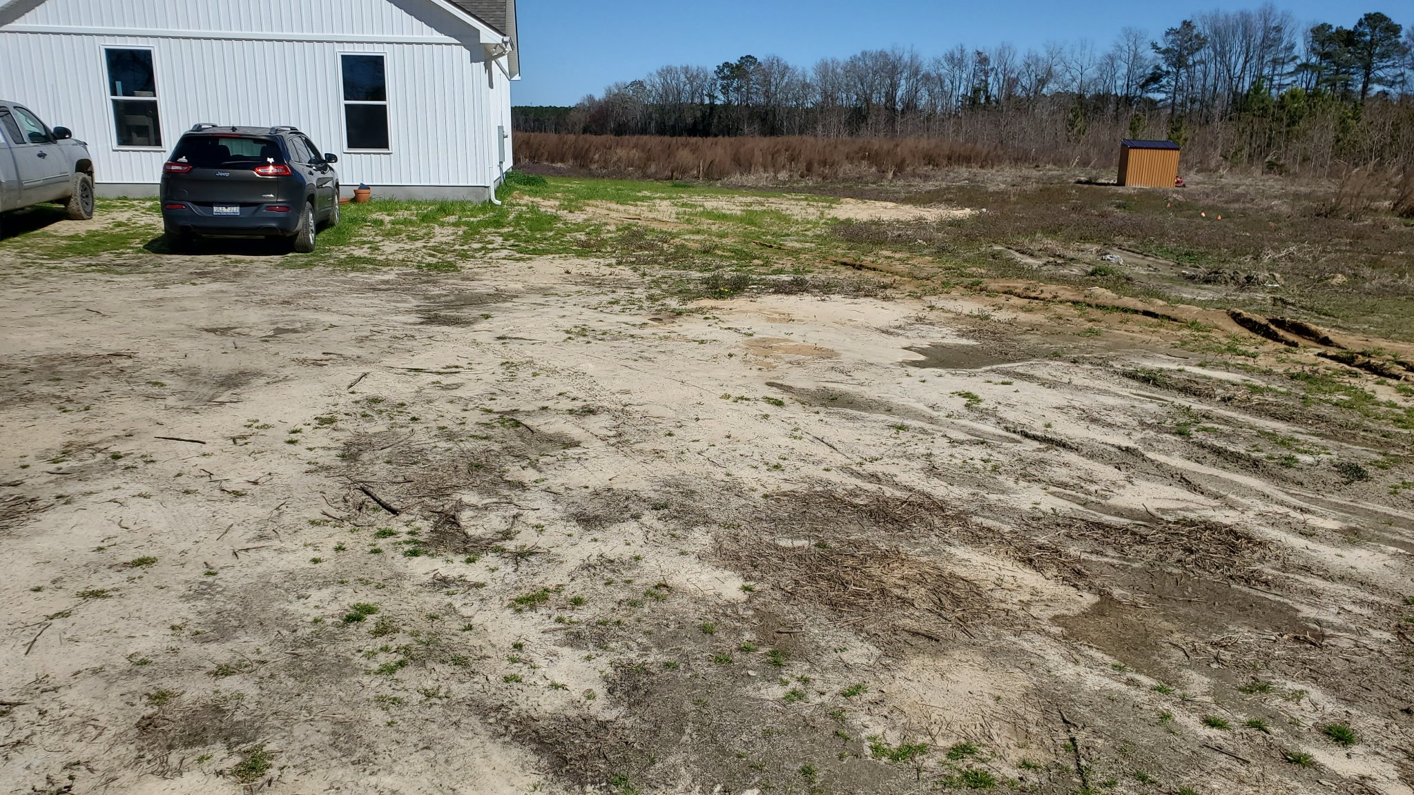

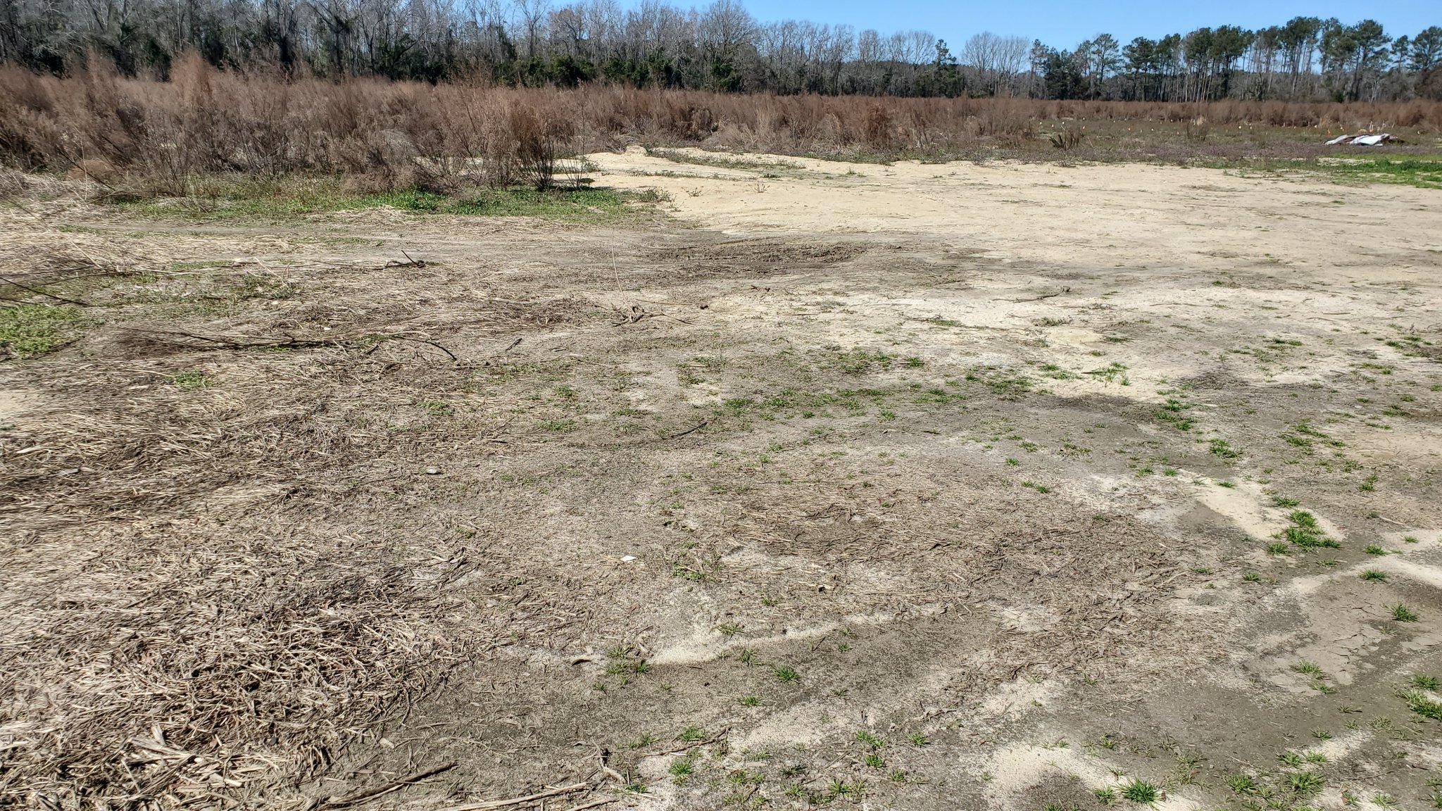

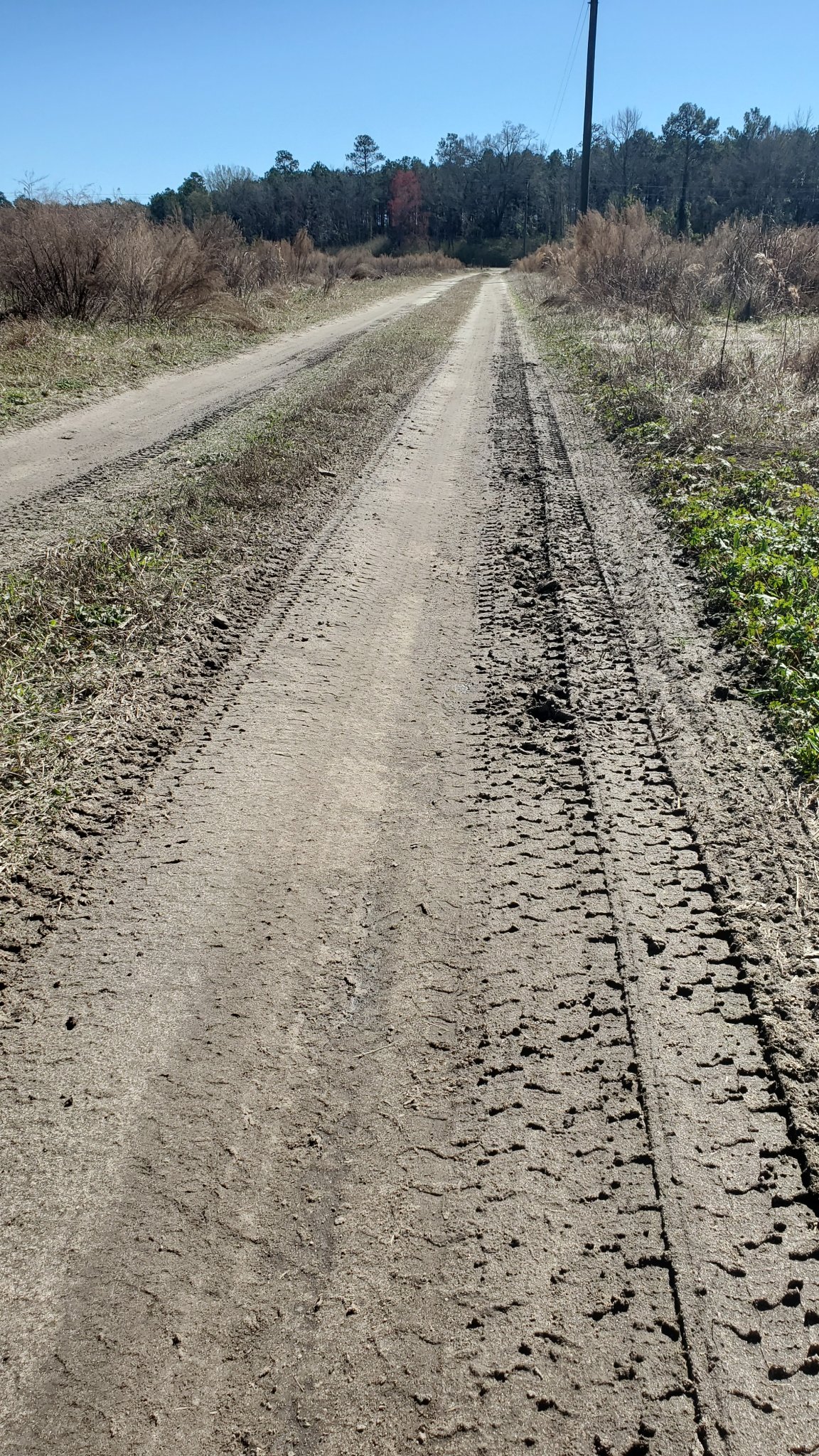

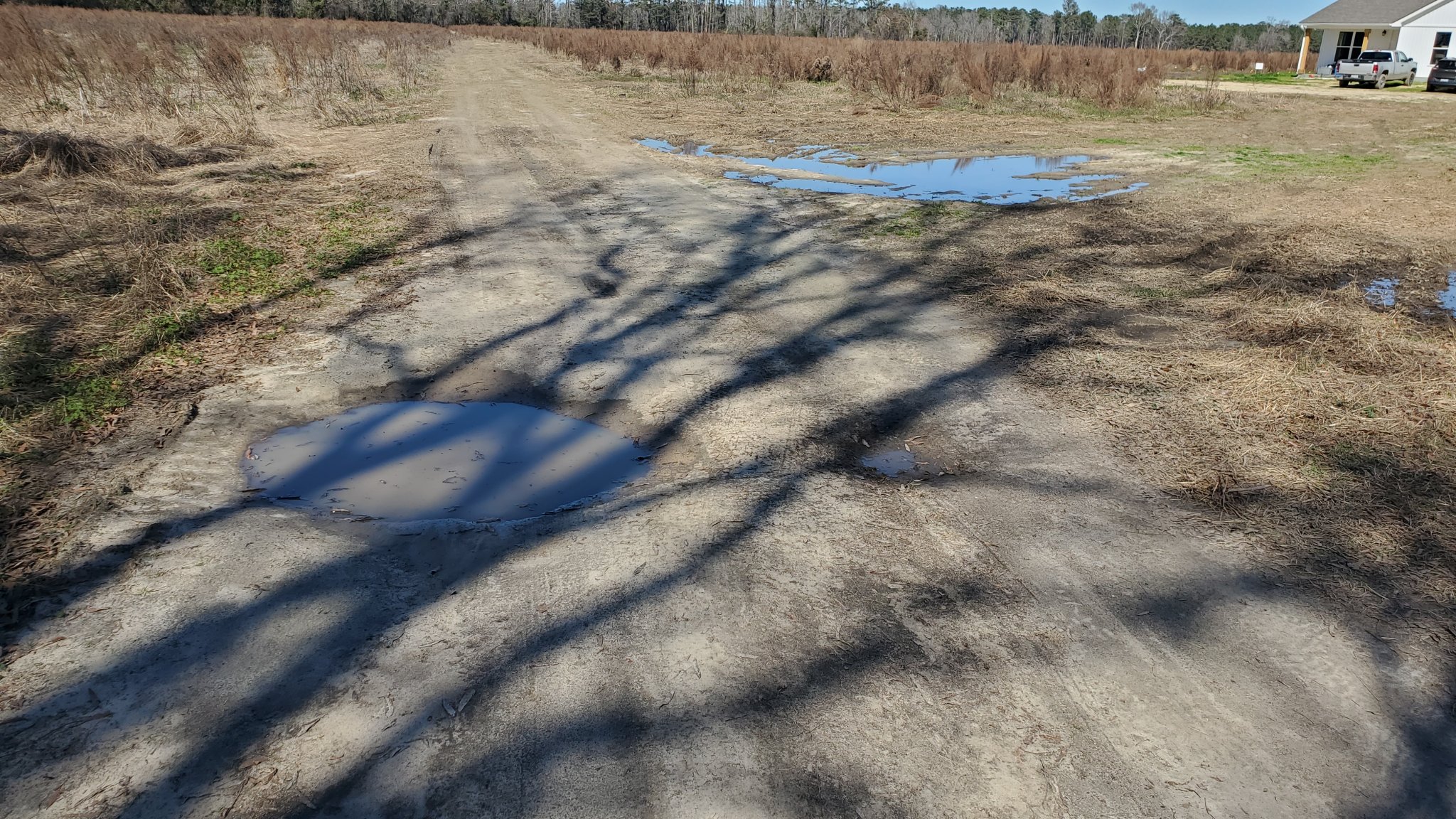

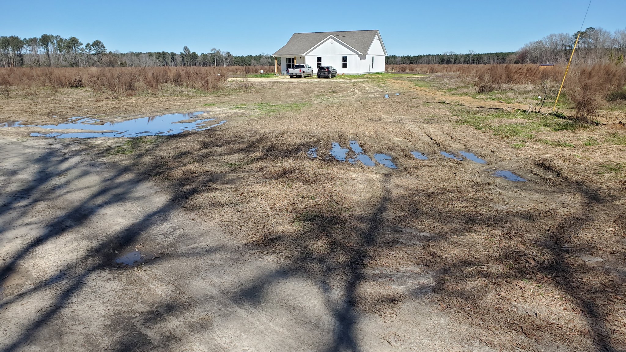

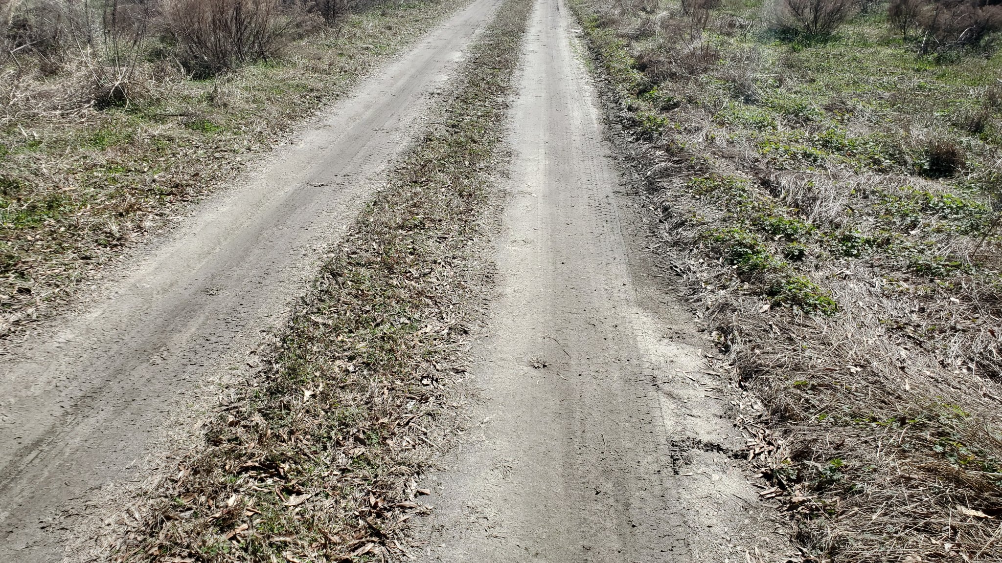

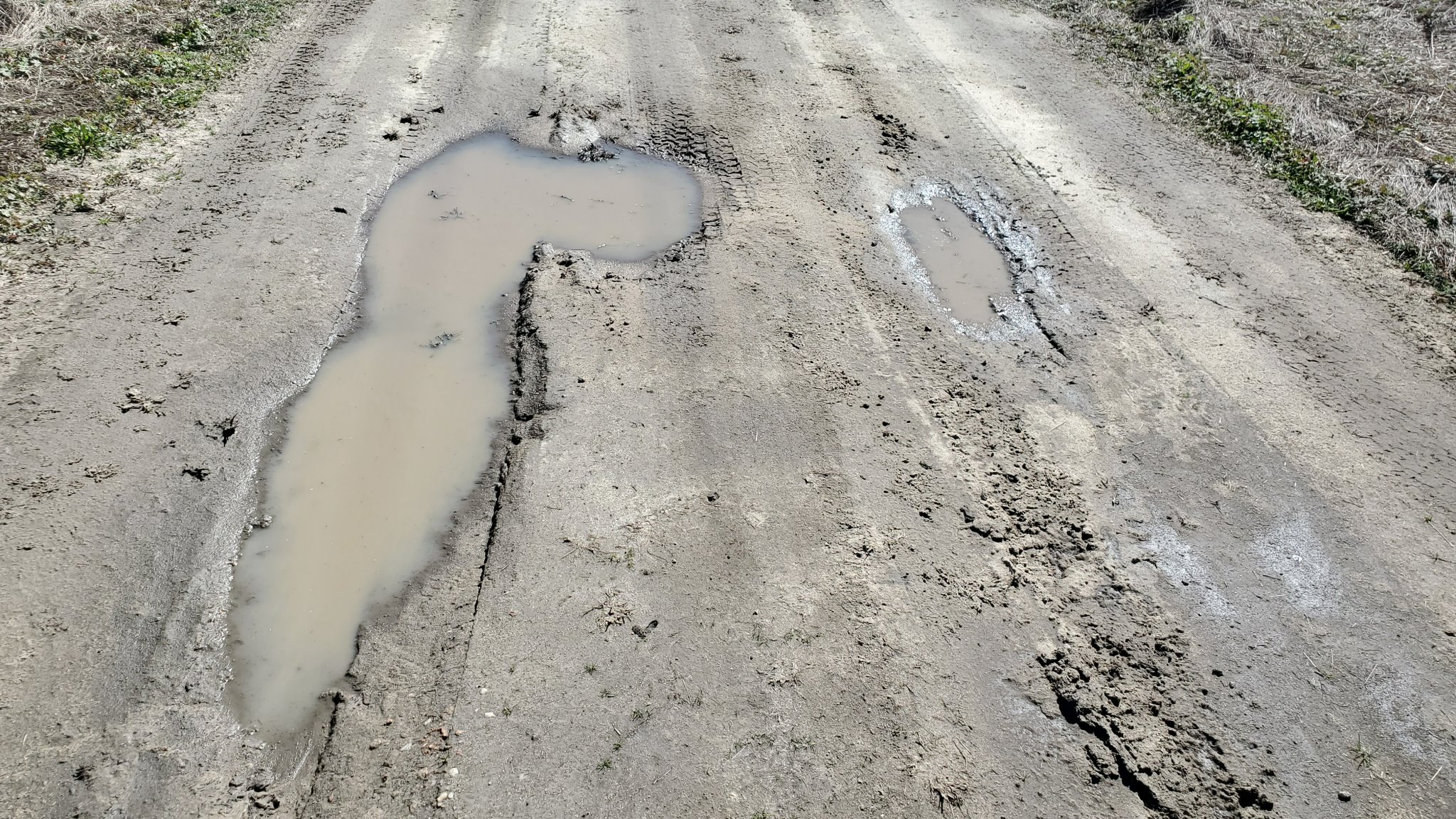

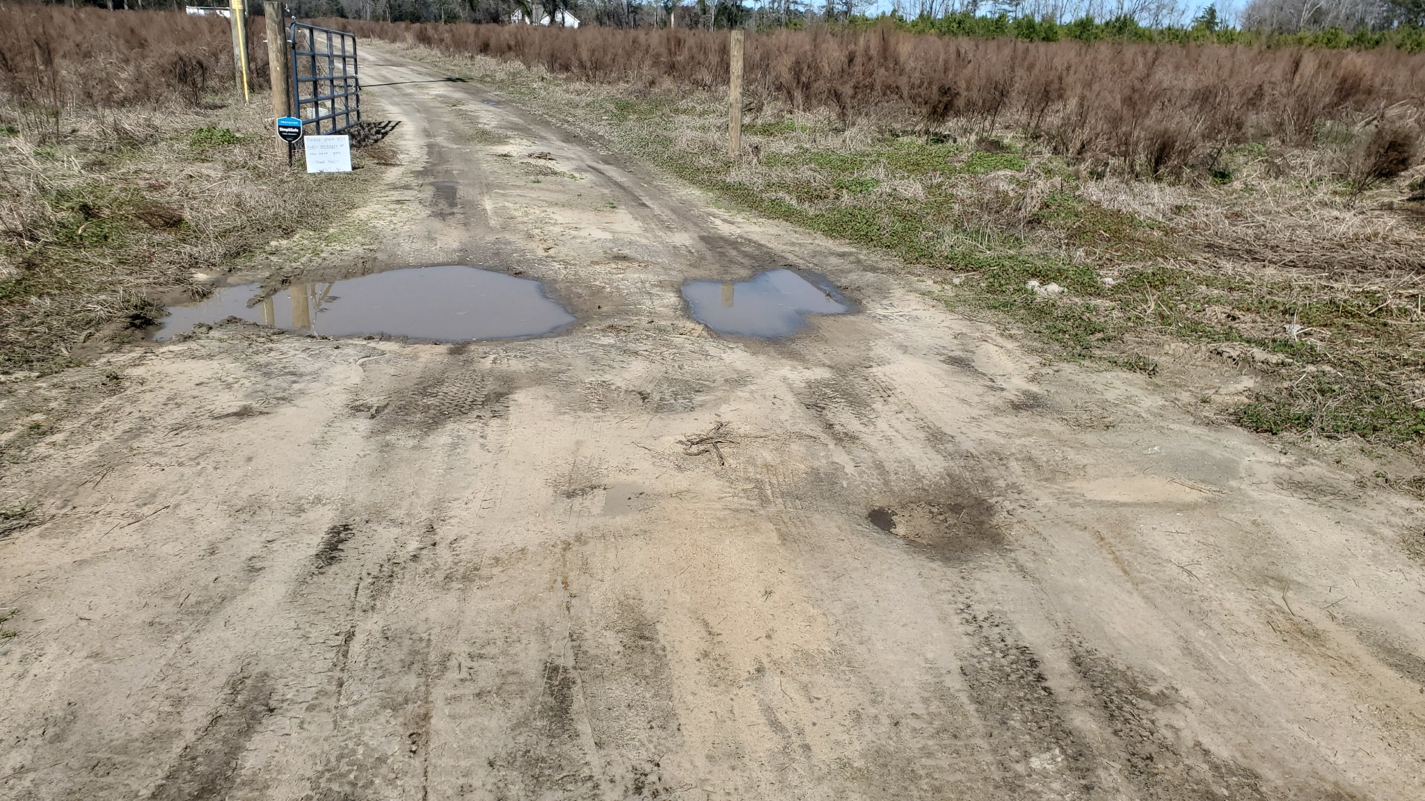

Hello all,
First let me apologize for rehashing this topic for the thousandth time. I cannot find a good discussion about this particular context.
I recently had a new house built on acreage. I am buying an MX5400 for mowing, brush clearing, some dirt moving, and general tasks/maintenance. However, we have some initial tasks that are outside of the normal scope of the tractors use. I have three problems that I need to address immediately. These are in no particular order.
1. There is an existing farm road running through the property. It is about 800' until it reaches our house. The road is very old and has developed more than a few potholes. From what I can tell it's basically sandy fill dirt that has been hard packed over time. When it's wet it either runs off or collects in the potholes/low spots, and makes mudholes. When it's dry the material is very dusty. With all the construction vehicles coming in and out it got much worse. It looks like they wore through the road base down to the soil below in some spots.
2. There is a 200' section between where the farm road is and where our house sits off in the field. During the summer there was no problem. The vehicles coming in and out packed the soil and any rain was quickly evaporated in a day or less. The construction went into November and December and now that section is a giant mudpit that doesn't drain. It takes about 5 days of warm weather to evaporate. We get appreciable rain about every 3-6 days in the winter.
3. The construction company brought in fill dirt, which is mostly sand, to grade/slope away from the house. It is a rough grade and already has some low spots forming about 40-50' away from the house. There are also some small rain washouts forming. The house sits in a previously row crop field, and our soil is mostly sandy loam. It drains very quickly in most areas, but some areas are hard packed because of the vehicles. There is also vegetation growing everywhere.
Here's what I'd like to do.
1. Regrade the driveway, without adding new material (right now). I will add stone later, but we are on a tight budget with the state of things these days. I would like to basically just fix the potholes for now, and ideally add a crown to the farm road.
2. Cleanup and regrade the natural soil area to drain off to the side (I will use the bucket to create a ditch/swale). I will also add stone to this at a later date, but I have to make due with what's there right now.
3. Touchup/regrade the slope near the house.
4. Mow the vegtation and touchup/regrade the natural soil that will be the yard areas surrounding the house.
I can only reasonably afford two implements. I am buying a rotary cutter, and would like to get either a box blade or landplane to take care of these initial tasks, as well as future tasks. I know the ideal answer would be to get both, or to get a harley rake, but as I said we are on a tight budget. I have no experience with either a boxblade or landplane, but I have more time than money and I'm a pretty quick learner.
I'll attach pictures. Please give me your best and honest advice, thanks.
EDIT: I will be waiting to do the work till we either have a couple weeks with no rain, or till April when it warms up enough to be dry in a few days.

I have a grader/scraper. It's great for surfacing a long road.
It is designed to move material from the end to the middle of the road. That makes it easy to build a crown. You drive down one direction and then turn around and come back the other direction. The material naturally overflows the holding areas of the implement and is deposited back on the road.
A box blade pulls material in a straight line. It can overflow the top, but isn't as easy to use as a grader scraper. It can hold more material in the box and can be dumped a little at a time by raising the box blade.
Both have scarifiers which are useful to break up the hard part of the potholes. Of course, I'm biased to a grader/scraper. In my mind, there is only one choice.
4,700
1,010
Land plane not box blade
get model with scarifiers
may want to get a chisel plow (rent?) to help with drainage.
getting the heavy equipment off will help you greatly.
getting the road professionally put in would be much better but you may not have enough money for that currently but they can really do a great job in little time if they are good quality company that does dirt roads often
28,818
5,187
Wow, you're not going to get much out of moving the dirt around, you really need to put something down for your driveway to get anything really workable.
The farm road, yea a land plane. it really does need some new material to work with!
I will caution you, You better have permission to do work on the road, some places get pretty picky about who is and is not allowed to work on a road.
Best intentions can lead to some ugly lawsuits or just plain old head aches!

Can you afford a few loads of the cheap sandy material that your contractor used?
You need to add some additional material to shape that driveway .
Scratching/digging up your current surface is not going to be very helpful.
I would recommend the Everything Attachments "6 Way Deluxe Scrape Blade," but ONLY if you add some material to grade with.
There is a learning curve with using a rear scrape blade though.
The "land plane" (with rippers) will temporarily fill in some of your holes, and it is a tool commonly used by folks with no grading experience.
A land plane on a driveway such as yours might produce marginal improvement,....... until the next rainfall.
The land plane is not a good tool for building a crown.

A box blade can do everything a land plane can do, and then some.
A box blade + Rake w gauge wheels, can do a lot more than a land plane can do.
6,714
4,246
The major issue with a box blade is that it cannot be angled.
Great for moving/scraping dirt/material from A to B, but not for building, and holding a crown.
I agree with you. Other than doing the very rough grading, a 6 way scraper blade is far more useful for road maintenance than a box blade. And far more versatile. Box blades are great for initial leveling and grading of materials and also for cutting dirt to made a level pad. Otherwise I don’t find them too useful.

Thank you everyone for the replies. I still see some disagreement haha. Basically what I've seen till now. I think my main hangup is will the dirt/material really "flow" over the landplane blades? I see people use it to great effect on gravel driveways but this is sand and dirt. I am going to wait till the ground dries out to do anything but I'm still not sure. And whichever I get would have the scarifiers.

Wow, you're not going to get much out of moving three dirt around, you really need to put something down for your driveway to get anything really workable.
Thanks for the reply. I agree it really needs some new material put on it. I have been putting serious thought into biting the bullet and paying for something to put down on the last section that's really muddy.
Also, the farm road is on our property and no one else has access to it. I appreciate the thought though!
Do you have any experience using it on sand/natural soil? I won't have gravel or crushed stone down for a while.

Thanks for the reply. I am seriously considering putting some material down in the really bad section that is natural soil. I don't know exactly how much it will amount to but I'm guessing I'm looking at about 50-60 tons for a basic 10' driveway up to the side of the house. In any case, I had also considered the rear blade, but like you said it works better with new material. I think the blade probably gives my less versatility than a box blade and is much harder to use than a landplane. Correct me if I'm wrong on that.
My driveway is crusher run 3/4 in which includes sand. I've also used mine on dirt. It doesn't work well on either one if they are wet. That would be the same for a box blade.
Fine dirt/sand will pack down.
I guess I had not thought a rear blade was more versatile than a box blade. Maybe it's because of the learning curve. I just see myself making giant divits in the ground with a blade.
You can angle, tilt and offset. Things that you can’t do with a box blade. You can also cut ditches. The angle of the top link determines how it cuts, and if you just want to smooth gravel, you can reverse the blade 180 degrees and it will just smooth, not cut. But get a good blade that has those features and as heavy as your tractor can handle. Light blades just bounce if the gravel is hard packed.
