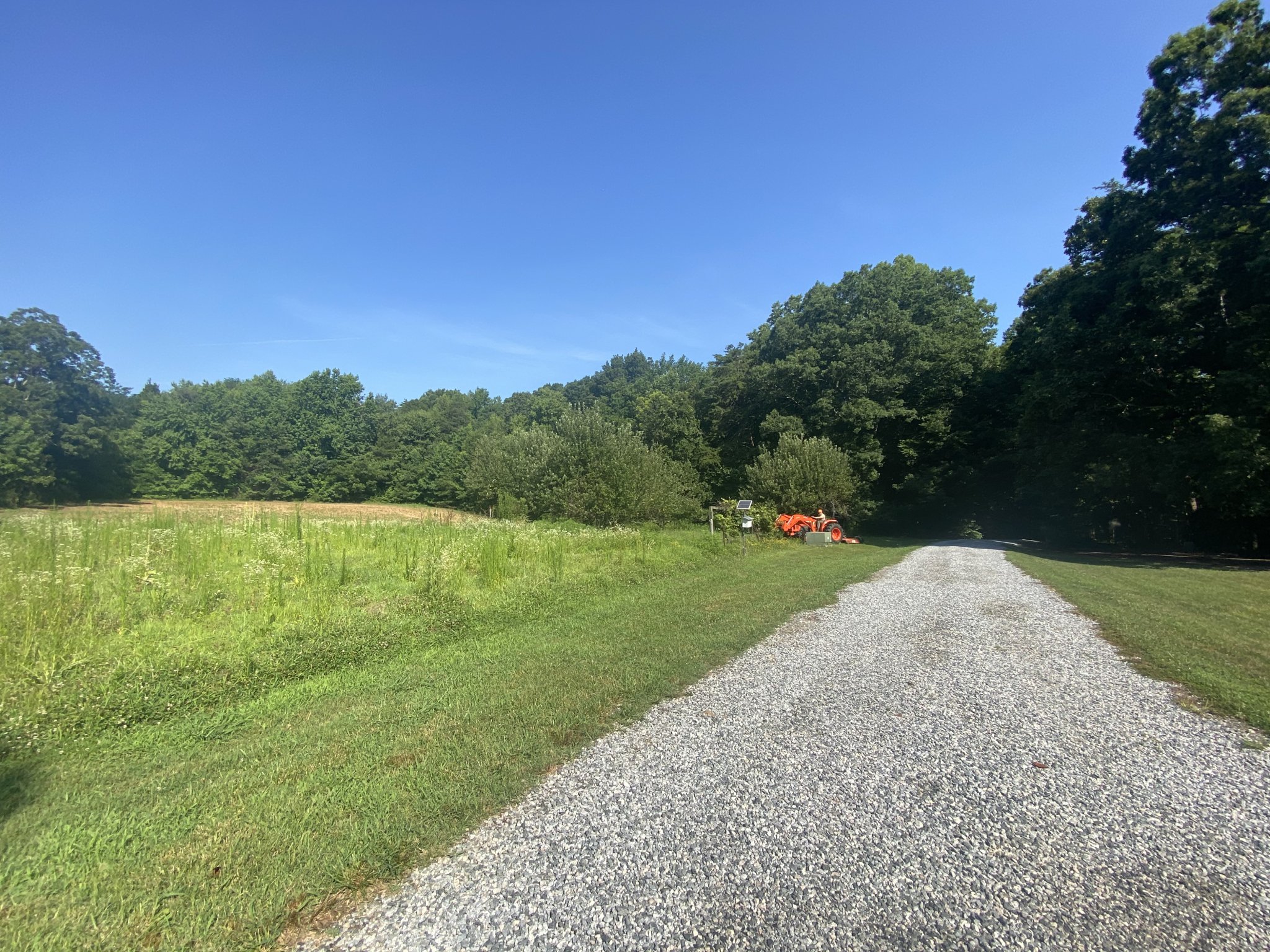

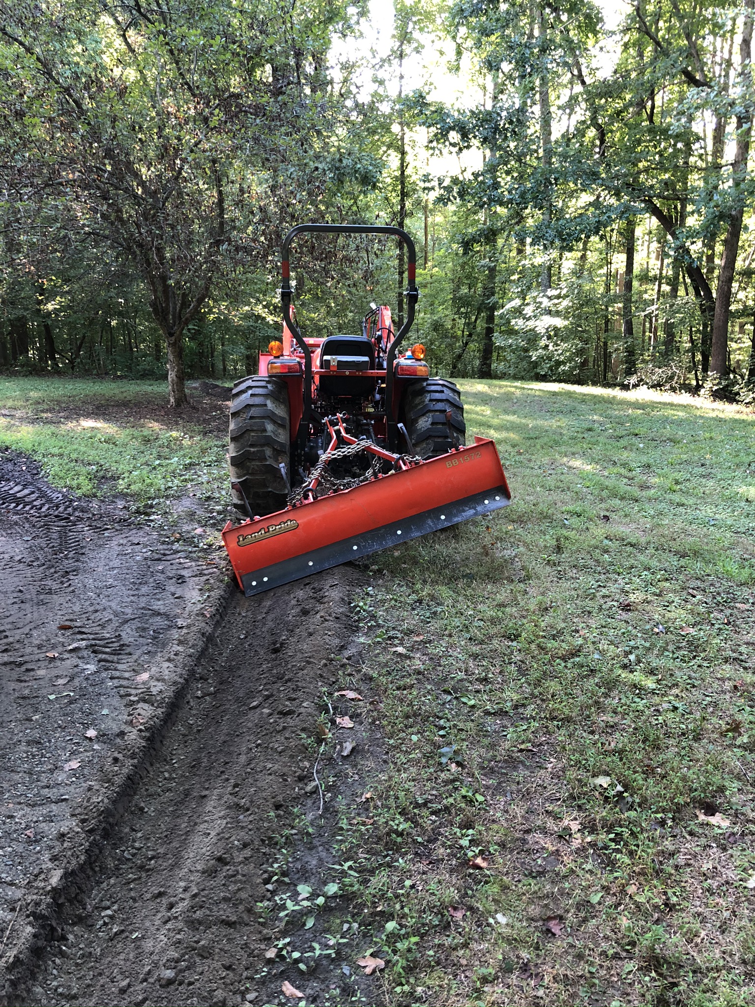

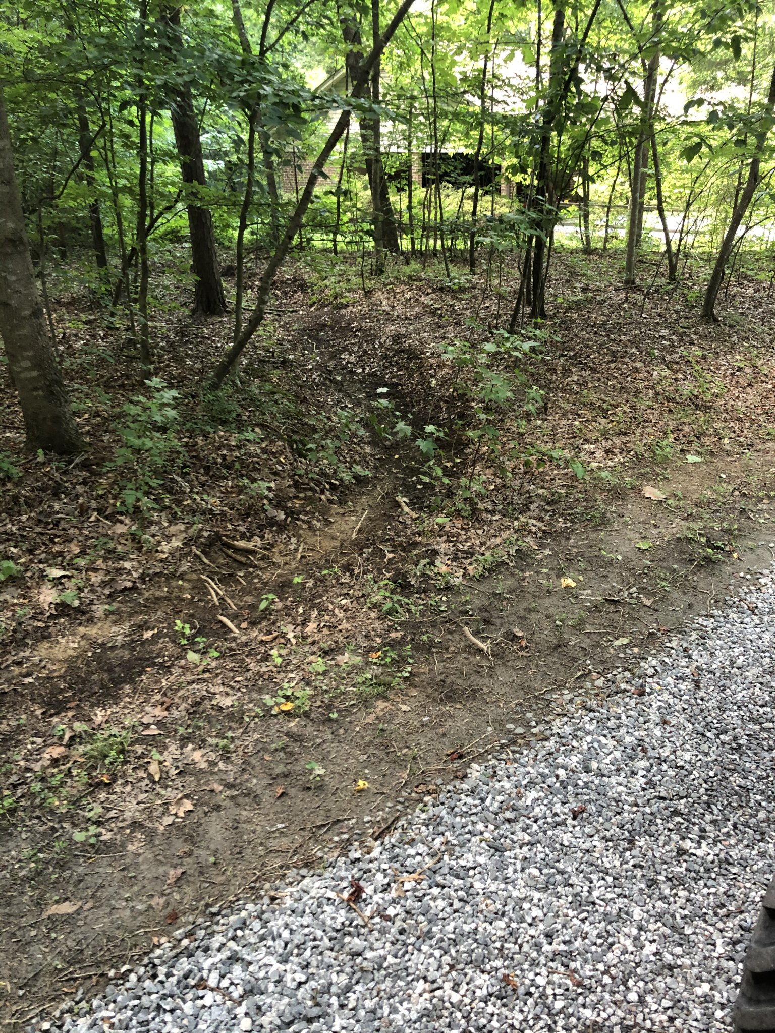

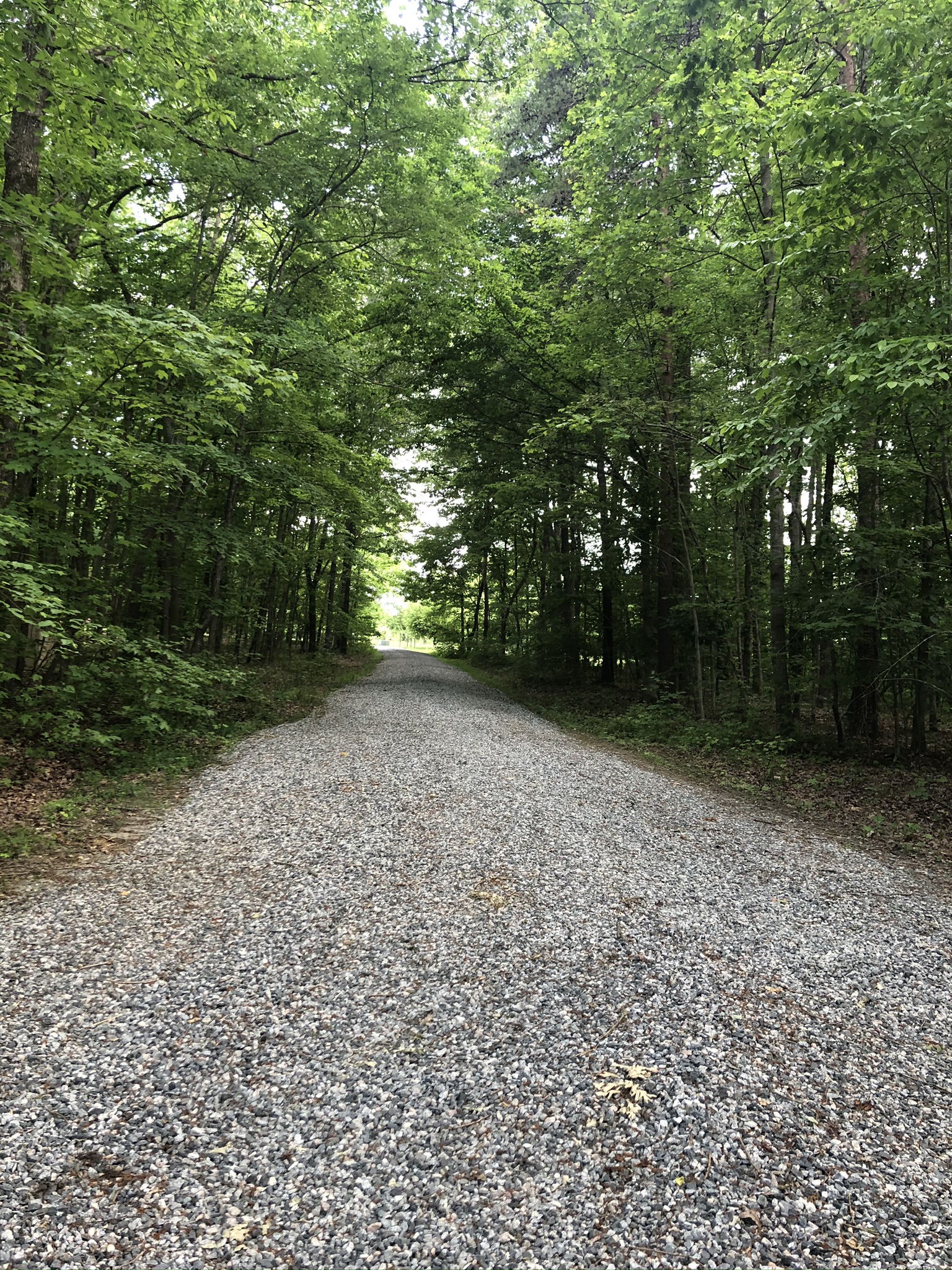

View attachment 96152 View attachment 96153 View attachment 96154 View attachment 96155
Done…
Nothing against the back blade or grading scraper. However the idea that a box blade isn’t capable of moving material sideways, crowning, ditching, creating swales… perform actual grading; that idea is just wrong.
If you prefer a back blade, use a back blade. I really don’t care what anyone uses and I am not selling boxblades so I don’t care if anyone ever buys one again. However, the OP asked for information and in regard to what he can do with a box blade he was given incorrect information. Whether that was because the folks that posted the incorrect information don’t have experience with the implement and are parroting bad info they’ve heard or they do have experience that was disappointing because they didn’t know how to get it to do more than move material in a straight line; don’t know, doesn’t really matter.
I’m not planning on getting in some sort of internet slap fight about this, but no one anywhere, regardless of whatever “evidence” or “authority”, is ever going to convince me that the things I have already done and continue to do with an implement can’t be done with that implement. That would be entirely non-sensical on my part.
From the standpoint of those reading this, there’s a judgment of whether I’m full of crap and actually used a backblade, contractor, photos of someone else’s road. Maybe I’m an 10 year old in Vanuatu who has never seen a boxblade; I’m just bored and like stirring up old dudes with tractors. That‘s the dicey part of a forum like this. Y’all have to decide if what I post is worthwhile.
Regardless what you decide, none of you are going to convince me I can’t do stuff I’ve already done.
