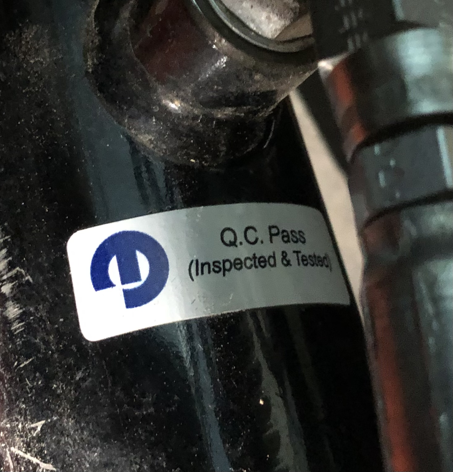

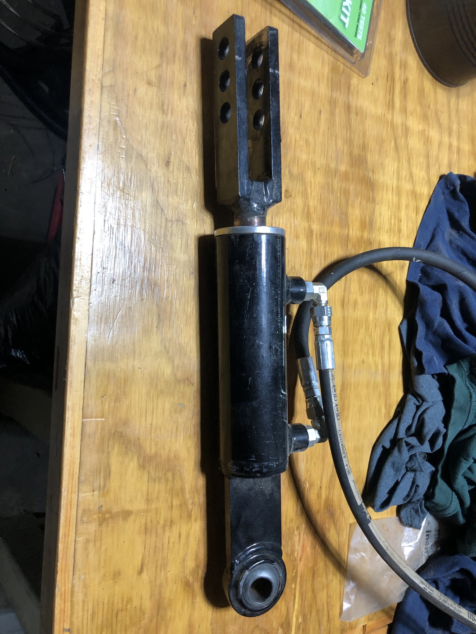

Do you mind sharing what sidelink you're using?
Next time I’m with it, I’ll check. The dealer spec’d it as part of the turnkey job to add three rear remotes and the two cylinders. It’s been long enough I don’t remember off the top of my head.
Edit:
Visited the tractor this morning before work to check out the side link as my curiosity was bothering me. Also checked the paperwork from where I bought it.
The paperwork listed all the remote valves by part number but listed both cylinders as “hydraulic cylinder” so that was useless.
Couldn’t see anything other than the quality control sticker with it on the tractor so I took it off, wiped it off, and inspected it on a bench. Didn’t see any markings anywhere on it other than the (to me) useless quality control sticker. That symbol on the sticker might mean something to someone but not to me. In my experience it is sized appropriately for everything I’ve done with it and it works well. I can measure it up and send you the size and stroke specs on it if that would be helpful but unfortunately it looks like I’m pretty useless on where to source it other than I got it from Riddle Tractor in Winston-Salem, NC and I recall the salesman saying they weren’t specifying Kubota cylinders because they were stupid expensive and no better than other options (true or not, I don’t know; just what he said).
Sorry I’m not of more use here.
As an aside, the top link they specified is shorter than what I would have spec’d. It has the boxblade level at full extension and I don’t like that, but so far it has worked for everything I’ve done with it since adding rear hydraulics. In hindsight I should have been a bit more involved in verifying the specs before signing the order rather than just telling them “do it”. Only thing I insisted on was a float valve and no check valves on the cylinders so I could use the float on either the top or side. For some uses I could see check valves and no float being appropriate. For my uses, the float is a very nice option for the toplink when mowing and sometimes nice for the sidelink in some grading scenarios, so I’m glad I got float with no check valves.
