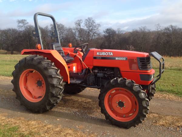

Bought a 4x4 M4800 recently and used it with a box blade on a slope today. No FEL or any additional weight on the front. The front tires didn't seem to have enough weight to dig into a turn with the box off the ground. I had the rear tires filled with fluid but nothing to the fronts. The box isn't as heavy as the cutter is going to be so I'm concerned that there will be a problem with a heavier implement on a slope.
Should I fill the front tires or is that not recommended. What about wheel weights or suitcase type weight on the front? Any recommendations or experience?

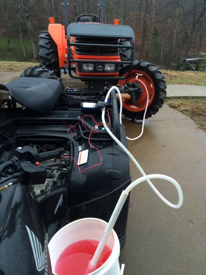

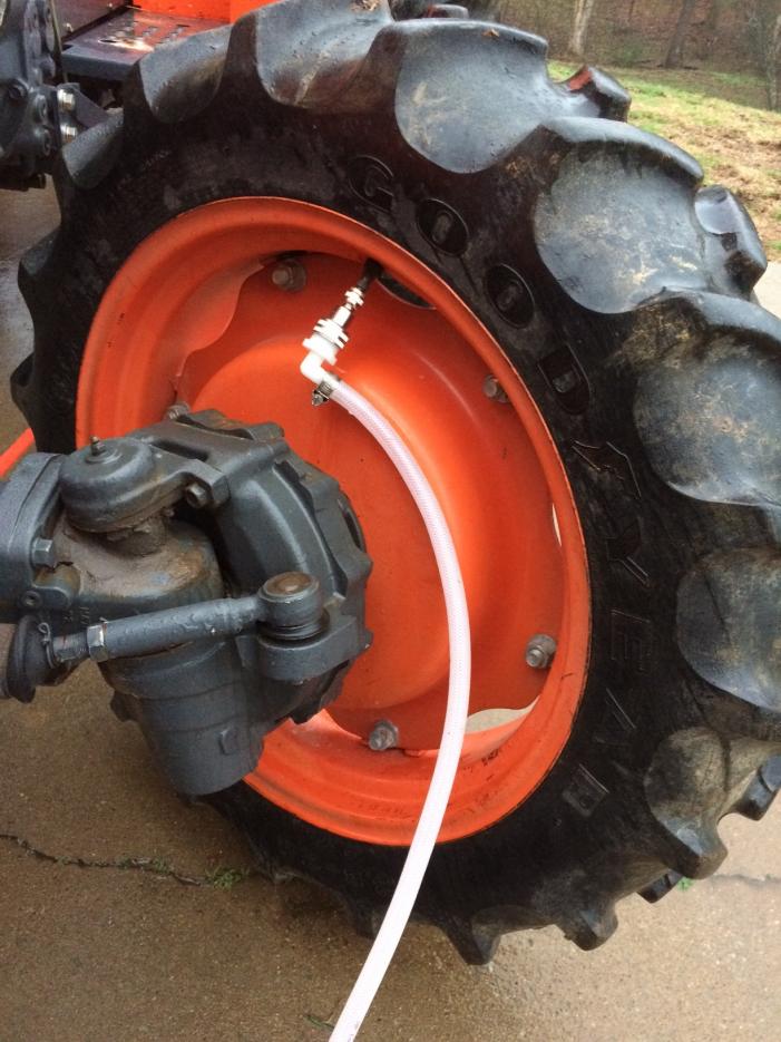

I filled each front tire with 8 gallons of RV antifreeze and 4 gallons of water. Should put near 100lbs in each tire. After watching a few videos I realized that I had most everything to do the job with. The adapter came from TSC ($10); the RV antifreeze from Walmart ($4 - $5 gallon); the pump and tubing I had was left over from a roof cleaning business I had started a few years back. Powered the pump with the battery from my 4-wheeler. I switched sides with the tires to increase width so it put the valve stem on the inside. Jacked the front up and was surprised how easy they filled. Took maybe 2 minutes per gallon with air bleed every gallon or so. Haven't been able to try it out yet because of the messy weather we're having.
