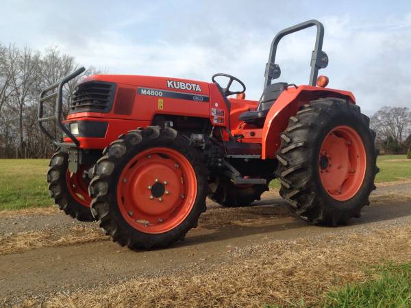

I reversed the front wheels/tires for more width; similar to the same reason that you reversed your back wheels/tires. The two pictures attached show the reversal of the fronts. The pic with the mower in front is after widening the fronts. Notice the concave wheels on both front and back now match including the outside bolt heads. My farm looks very similar to the terrain of yours so any added stability makes me feel better. And it looks better to me:D
However, I can see how this might put additional stress on the bearings but has anybody experienced a problem with reversing the wheels? I don't want to be the first to admit it so I'm all ears. Yesterday I bought a weight bracket for the front. It weighed 88 lbs itself which should help keep the tires in the dirt. But it may not help with the potential bearing issue.

Your not going to do a thing for your stability on hills having a wider front, Rear yes, front no, the front pivots therefor it does nothing to keep the tractor upright.;)
And yes I've had to repair many a front end bearing setup because someone thought it looked cool to have a wide front end. :cool:

Good enough for me. I'd rather learn through other people's mistakes. Guess I'll switch them back. Won't be as easy this time since they weigh an extra 100 lbs but beats a repair bill. Thanks!

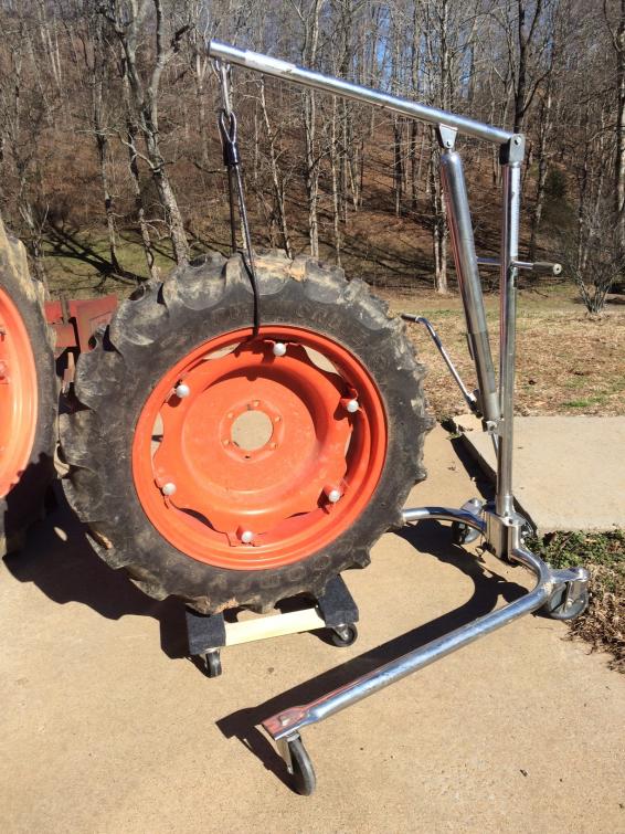

Thanks FTG for the offer to help. My wife weighs about as much as one of the tires so she won't be much help. I saw a post on here a couple weeks ago where a guy used an auto creeper to move his tires around. I may give that a try first. Got a bad reputation for trying to do things myself. Hasn't always worked out the best way but just gotta try. Thanks.

I switched the front tires back today after recommendations that widening the fronts could wear out the bearings. With the help of a hoyer lift the job was effortless and safe.
