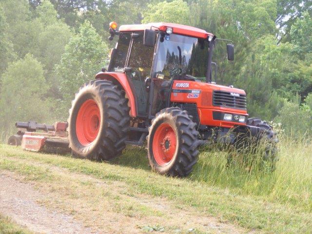

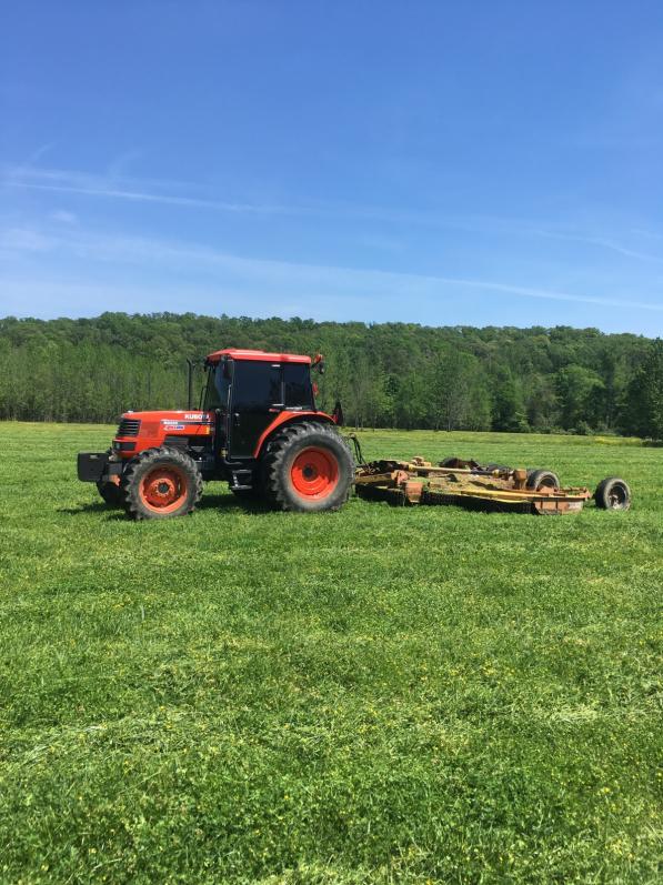

I don't know how big his tractor is but a 8' twin spindle rotary cutter like a Bushhog 3008 won't leave windrows as long as the rear chains are on or at least take the rear bands off.
If he has enough tractor I would suggest looking at a batwing. The outside wings are counter rotating so they don't leave rows either. Need more room to turn a batwing but they will cover some ground in a hurry.
First pic was in my south pasture. Some of the grass was as tall as the front tires and you see how clean it cut.
Second pick is with my 3008. Only pick I could find but your can see how clean it leaves things as well.
