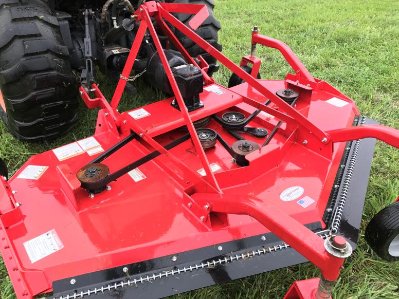

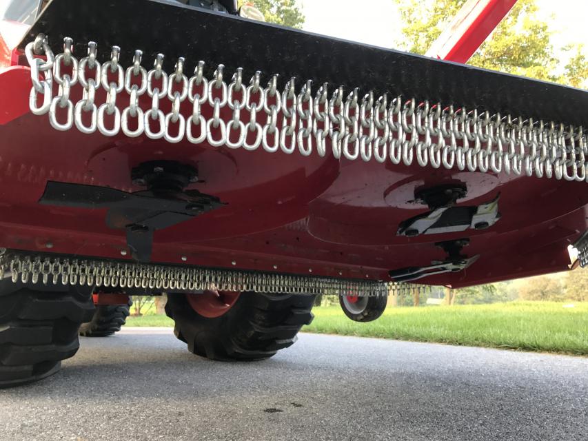

Thanks for all the input. My BIL has a Woods RD990X he's test driving. It can be adjusted to 7" using factory holes and bushings. He left me take a few passes on it and it was pretty impressive. I was cutting about 6" off of the grass and it distributed nicely. The deck is extremely robust. His L4740 handles it very well.
The arms for the wheels are 1/4" wall square tube - probably 2x2. Wheels are much larger than on any of the RFM's I've seen. The three blades are like small bush hog blades. Each of the three blades consists of a round plate with two free-swinging blades. One of the pics is with the guards removed when he was cleaning it. The belt is a real wide double V belt.
