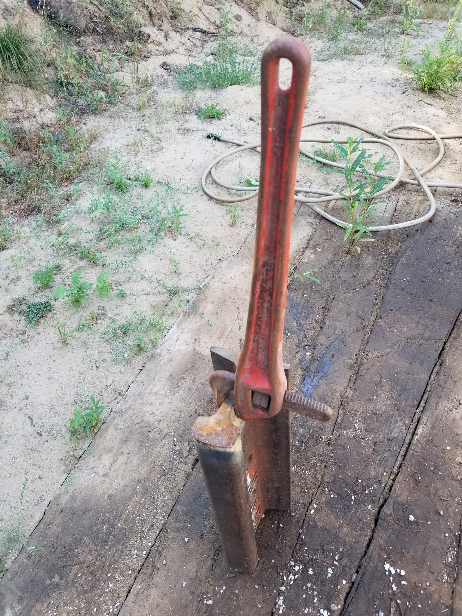

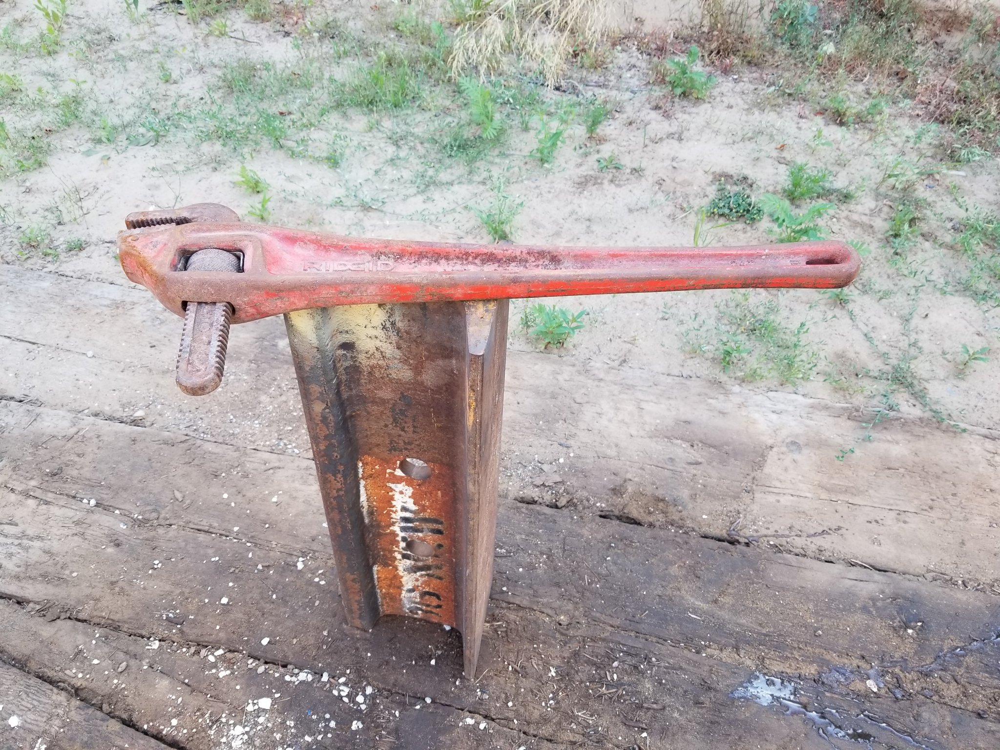

You needed the, "It WILL come off/apart pipe wrench"! 😜

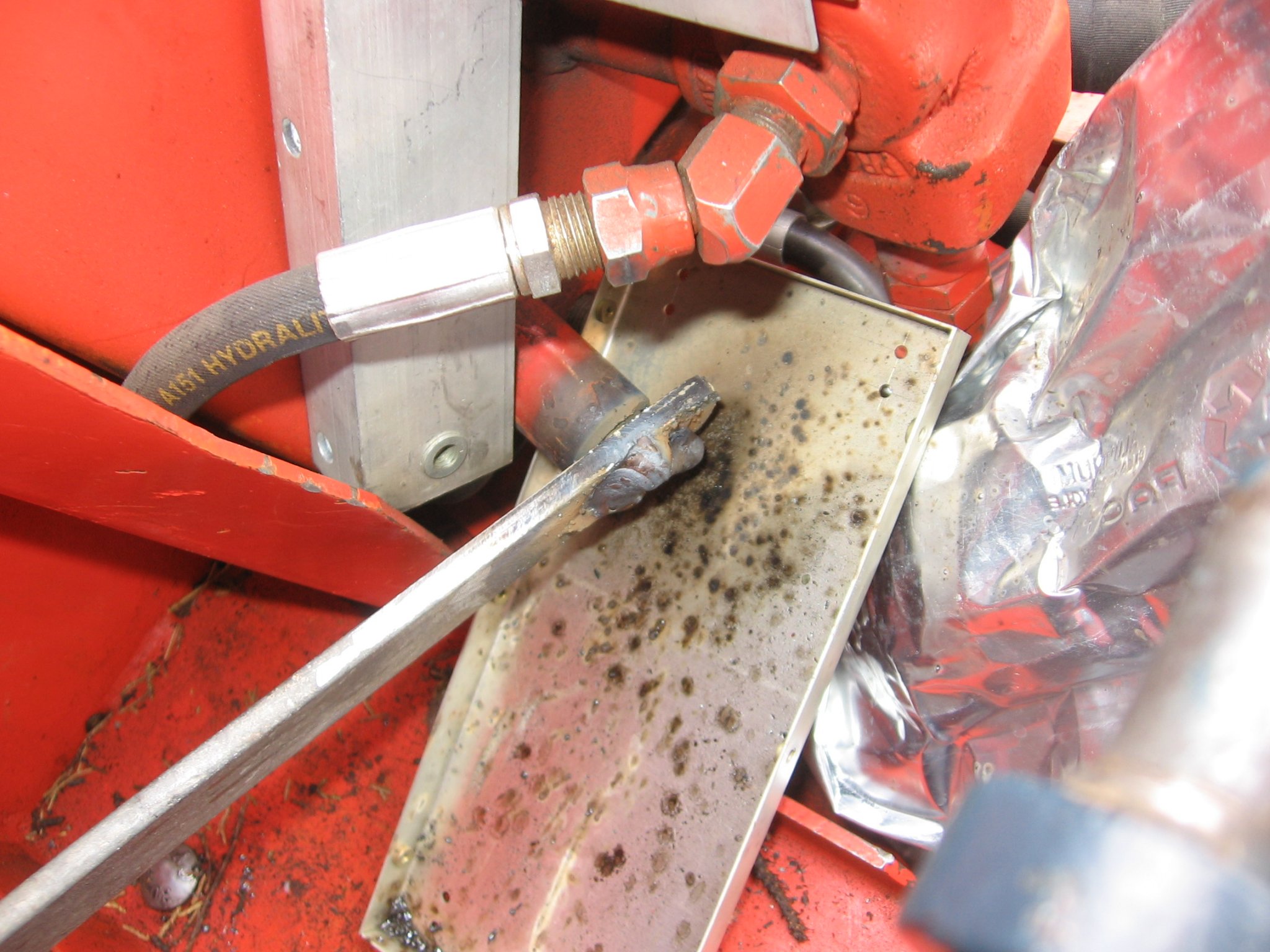

OK- back home again, so here we go.
After heating it again and trying the candle wax method with no luck, I dove in with the welding method.
I took a 1/4" x 1 1/4" strap 30" long and ground off the galvanized finish.
Then I drilled a 5/8" hole that just fit over the stub, and heavily countersunk it.
Shielded the nearby hoses with aluminum.
It was tight getting the gun in there, but I piled up a bunch of material to make sure I got it plenty hot.
