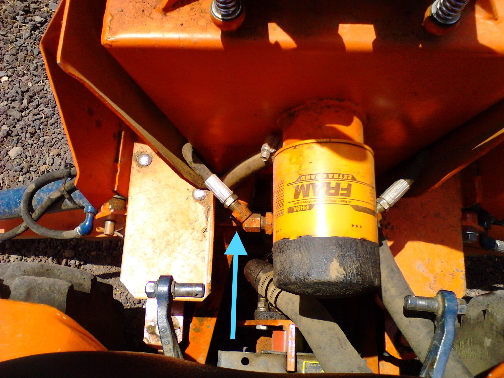

It's so chewed now I think I can use a 5/8" or 1/2" nut. Plus, it is in a spot that I can't get an impact on it, unless I pull the backhoe off the tractor, PITA.
Blue arrows:

picture looks like large set of vise grips would go on that ?
Tried that, that was the main culprit for rounding it off. Used two sets of hands to squeeze the jaws shut, and it still slipped. What I need is a set like they had in the maintenance shop at work- a little larger than normal jaws, but two foot long OAL! They really clamped tight, and then gave plenty of leverage. Can't find any that long.
