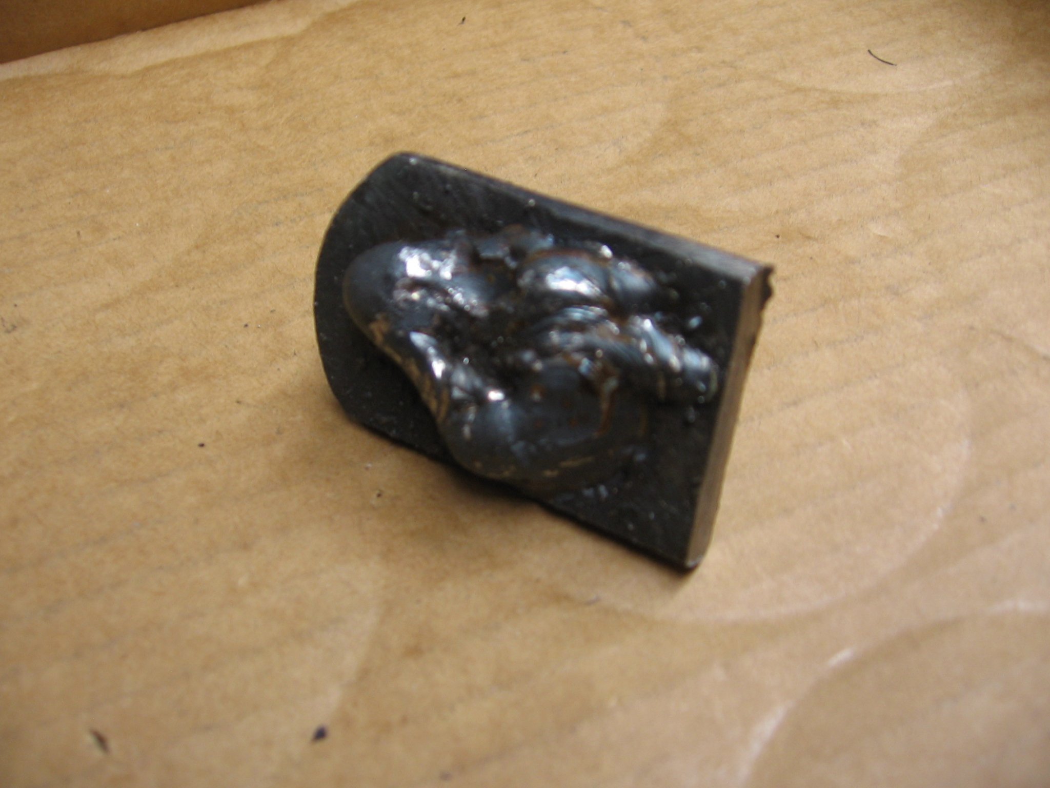

I then slowly pulled on the strap, thought I was going to pull the tractor over, but it finally moved (with a lot of friction) thru about 30 degrees. YAY!
I stopped, shot it with PB Blaster, and pulled some more. It moved thru another 30 degrees, and snapped off. CRAP!
The stub broke off, not my weld.
Sure enough, the plug is cast iron.
8,217
3,601
After pouting for a while, I ground off the stub & weld, and drilled the hole out to about 7/8", and counter sunk it heavily.
The plug had almost 1/8" of thread showing, so I put the strap over that and welded the hell out of it again.
This time it moved about 90 degrees, so I shot it with more PB blaster, then cut off the strap with a pnut grinder C'off wheel.
Then I used a giant Channel-lock to unscrew it the rest of the way. YAY!
After it was out, I found it had no sealant or locktite, & threads on the plug looked perfect.
I chased the threads on the drain spigot, and they looked perfect also.
I am still at a loss to explain why it locked up so tight.
After draining, flushing, and changing the oil filter, I put in a new hex head brass plug and tightened the hell out of it, to see if it would stick. It came out easily.
So crisis averted, oil changed.
Typically, the oil was so clean I probably could have let it go another 5 years.
Not my prettiest weld by a long shot, but one of the most satisfying.

After it moved thru the second thirty degrees, I started to reverse, and that is when it broke. I suppose I should have moved in smaller increments, both forward and reverse. I'll know for next time. Hopefully, there won't be a next time.:)
