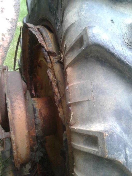

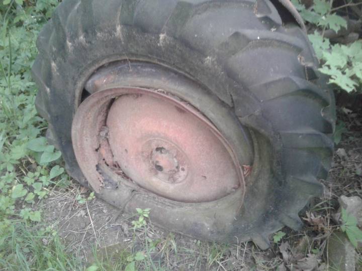

The "highly" part is highly subjective. It's used on roads all over the country. It's used because it's a lot LESS corrosive than sodium chloride (ordinary table salt), which is also commonly used.
(It's also NOT "toxic" in the normal use of that word. You can eat the stuff. Yes, eat enough and you'll have problems, just like with normal table salt.)
It's dishonest of them to use that term without any context to clarify what is meant. It's deliberately inflammatory.
Apparently you are inexperienced with chloride. It Will eat rims, it will kill vegetation if you get a leak. Just because you can’t find the answer you think you should find on the internet, doesn’t mean that it won’t.

Used CaCl for years on tractors older than most posters without much problem. Tubes and tires lasted longer back then too.

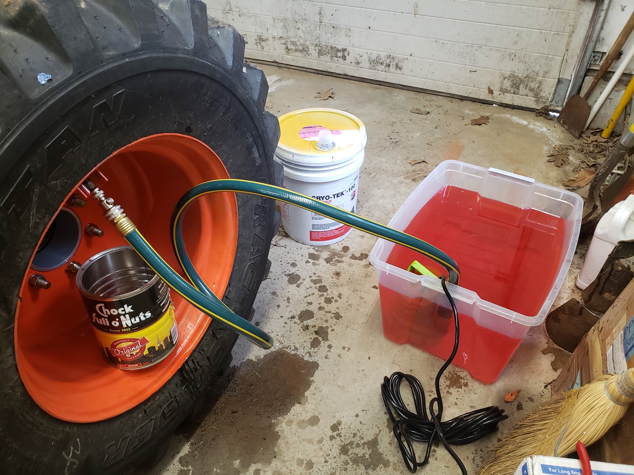

I weighed all the options last year when I decided to put liquid ballast in. There is a RimGuard dealer about 12 miles from me. I have no trailer and he wasn't giving the product away. . .
After reading a similar thread of pros and cons of the various options I pumped in something I'm familiar with - Cryotek 100
It's a product the company I work for sells to plumbers / heating contractors. Undiluted good to -100F. I used it 1:1, good to 10F before it starts to freeze. I don't go out on the tractor in temps below that and its stored in a heated garage.
It is as non toxic a product as I could find, environmentally friendly and a little less $$ than RimGuard.
Installing it was really easy - plenty of Youtube vids to guide you.

It never freezes here. So, no need to worry about it. My father put straight water in his rear tractor tires. Now, 50 years later, the steel wheels are rusting out. Just one more reason I am shopping for a new Kubota. I won't put water in the tires. Rim Guard for me.

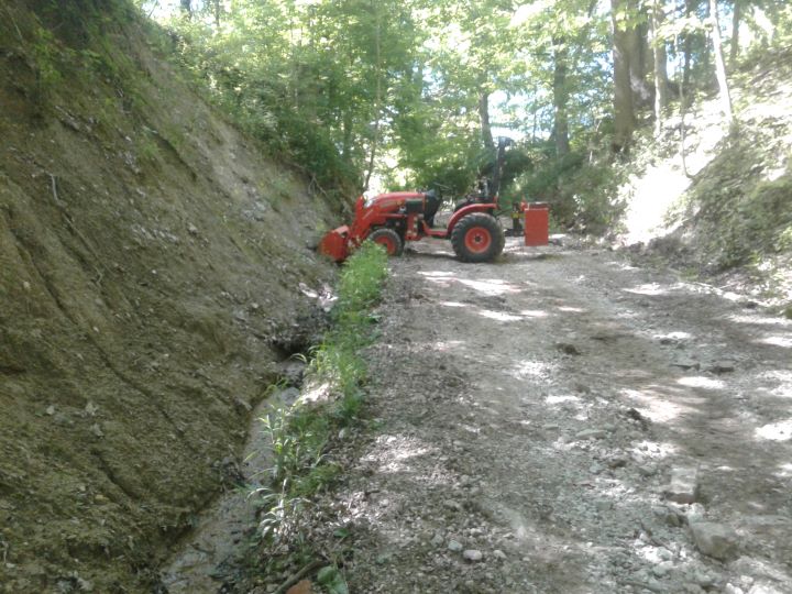

Tire slippage with ballasted tires usually are a result of low air pressure. PSI has to be real low before they look flat. Most people use 3pt weight/ballast to gain FEL lifting power. Ballasting tires makes it harder to roll tractor over on it's side.
Cleaning ditches with BX and air filled tires is a real white knuckles experience. Doesn't take long to order a "B" series with loaded tires.
I'm quite familiar with calcium chloride's effects on metals and the environment. It's much less of a problem than sodium chloride, which is exactly why it's used.
