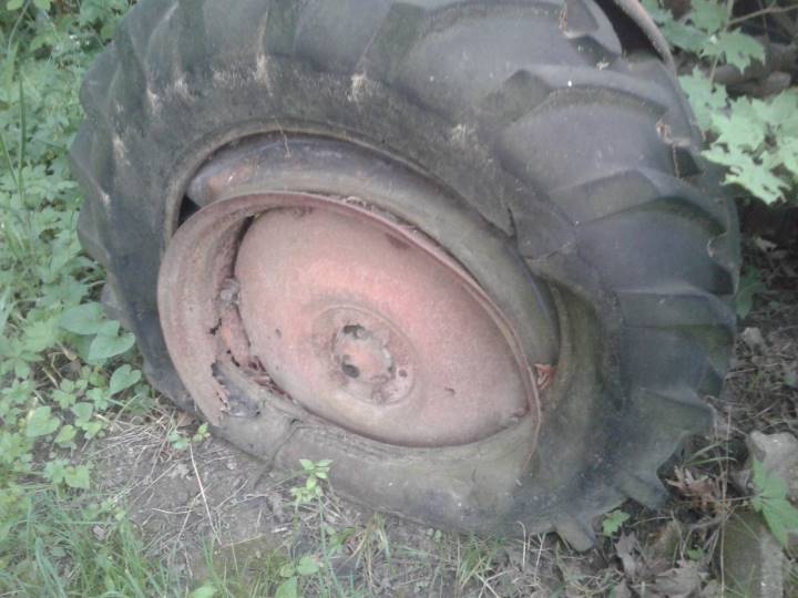

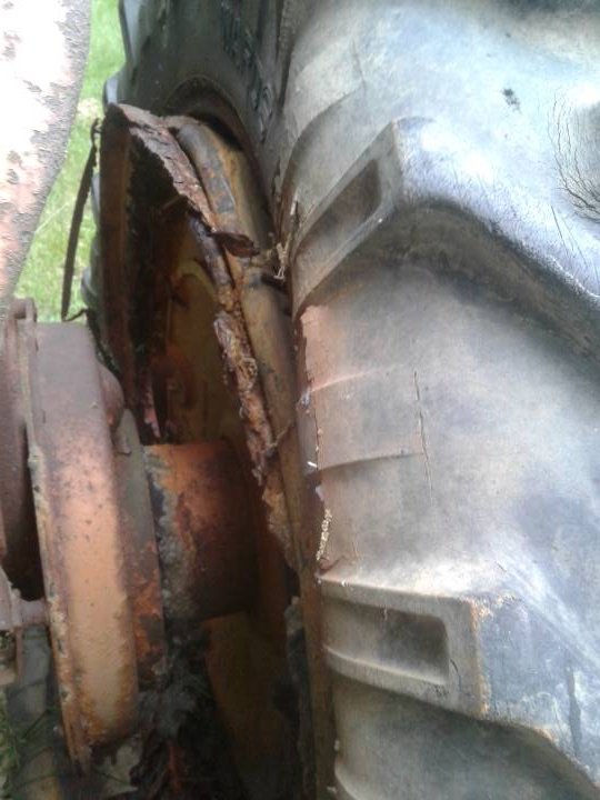

CaCl is bad stuff.... particularly bad (highly corrosive) for your rims!
Ask me how I know!
Ask me how I know!
The "highly" part is highly subjective. It's used on roads all over the country. It's used because it's a lot LESS corrosive than sodium chloride (ordinary table salt), which is also commonly used.
(It's also NOT "toxic" in the normal use of that word. You can eat the stuff. Yes, eat enough and you'll have problems, just like with normal table salt.)
It's dishonest of them to use that term without any context to clarify what is meant. It's deliberately inflammatory.
