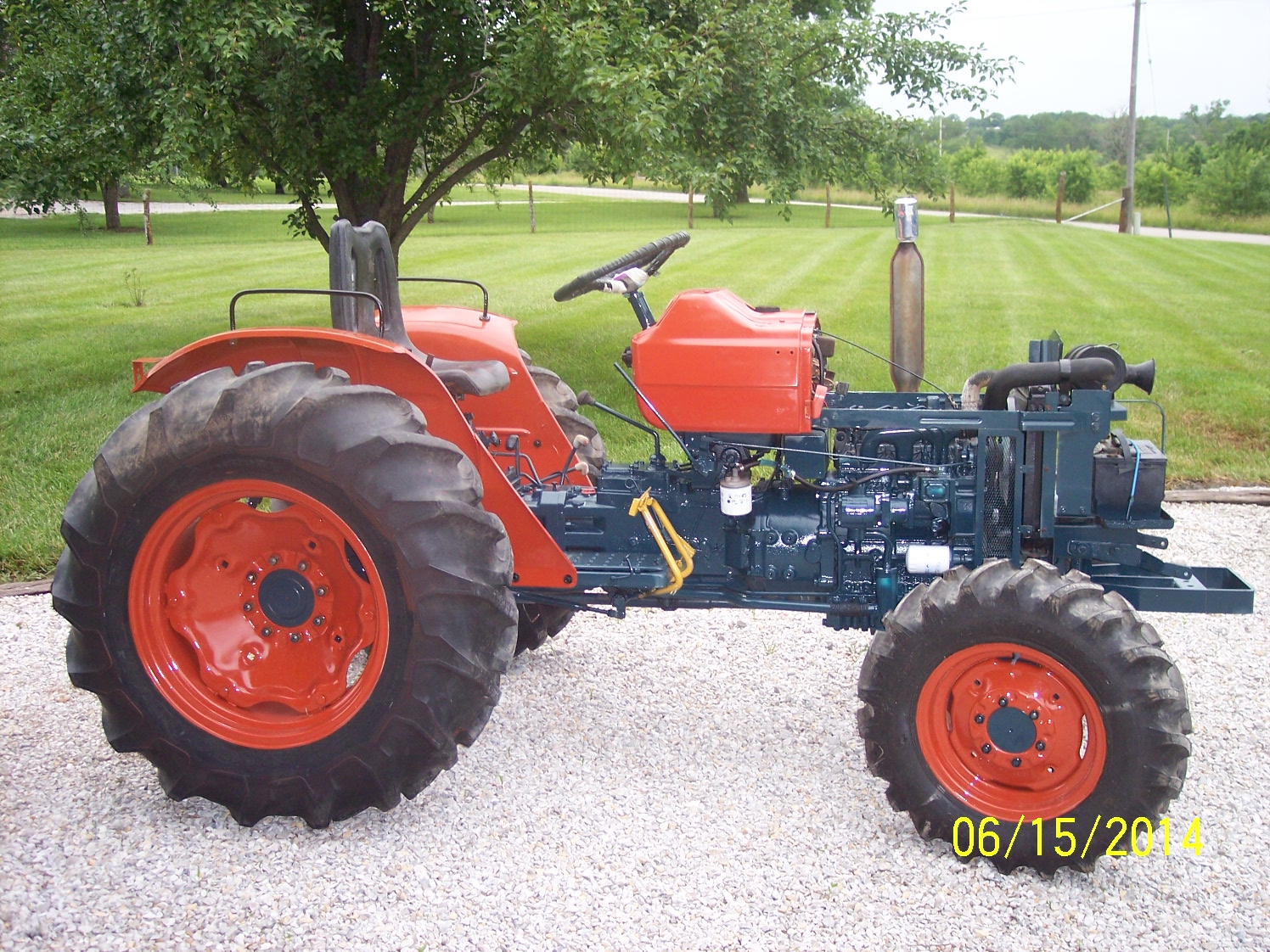

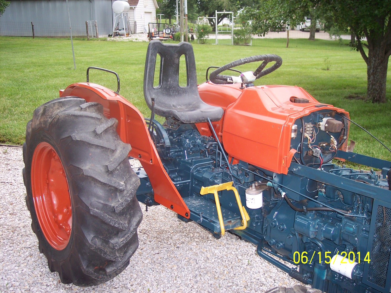

I painted the orange part of this tractor with Ditch Witch paint I had setting around. I had it a few years before I sold it and no one ever made a comment about the color of the paint.
. I had it a few years before I sold it and no one ever made one comment about the color of the paint!
View attachment 139711 View attachment 139712 . I had it a few years before I sold it and no one ever made one comment about the color of the paint!
Well I'll take care of that right now!
You did one fine job applying it.
