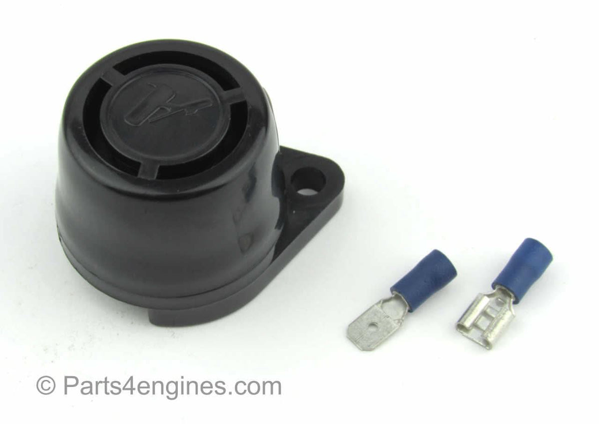

Wonder how loud this thing is

how loud ? 97db, so you will hear it, unless you're playing tunes the way kids do today:giggle:
Piezo sounders are loud and don't draw much power 20-50ma
but...
no mention as to WHAT pressures the switch activates on and off at.
Agree it could be useful,maybe it can be wired in parallel to the 'idiot light' on the dash ?
