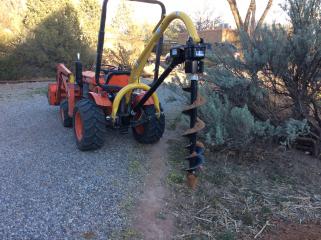

If you had just sent a picture of the post hole digger at full height without the auger, I'd think the geometry looks pretty darn normal. *IF* that were the case, you might just have an unusually long auger meant for digging deeper holes.
Even if you had 0.1" of clearance when you get ready to dig, that's all you need. You can always tie the auger to the boom for transport and driving between holes.
Then if you need more clearance when you get to where you want to dig the hole, you can drive up on some bricks/boards, etc to raise the back of the tractor and thus raise the auger.
