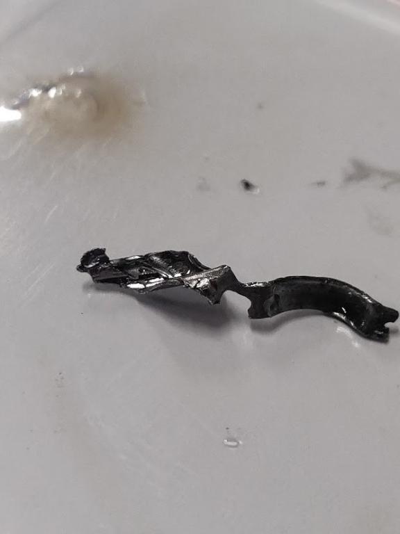

The noise is still there after replacing filters engaging PTO moving rpms up o ly time it goes away is when I press the clutch in. I will take a pic of metal fragment that was sticking out of filter and post later today. Thanks for your replies.

Could be anything from a left over machining chip to something that got dropped in the case during assembly. They (Kubota) don't assemble the tractors in a clean room enviroment. They are assembled in a factory, on a production line.
I'd say if it operates fine, next time you do a filter change, cut open the filter and inspect it (and hang on to the piece of metal just in case).
I'd be doing another filter change in about 10 hours of actual use. Filters are cheap, even Kubota branded filters.

This is pic is deceiving, it was almost 2 inches long. I am still hearing the noise coming from the area where the HST dip stick area is so plan on calling the dealer Monday. Thanks for the advice.

The only other thing is the metal I found in my HST filter looks like the outer ring of a bearing housing. I am definitely no expert but this just doesn't seem right.
